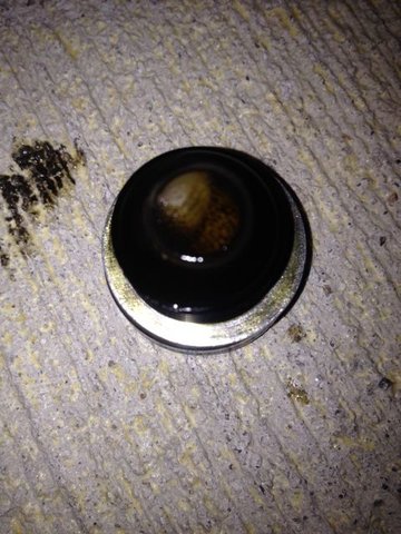

1. Installed a magnetic drain plug about 1000 miles ago, when I took it out, it had a thin metal film, looked like lithium grease, is this normal? Engine will shed ultrafine particles?

The metal particles on the magnetic oil drain plug is to be expected and fine. So is the oil in the air intake pipe due to the PCV valve. Either have the driveshaft bearing grease repacked and reinstall DS with new screws or replace it as one unit.
