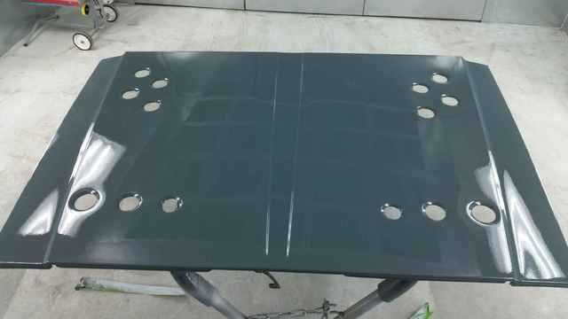

Simple Dimple Die pattern idea:

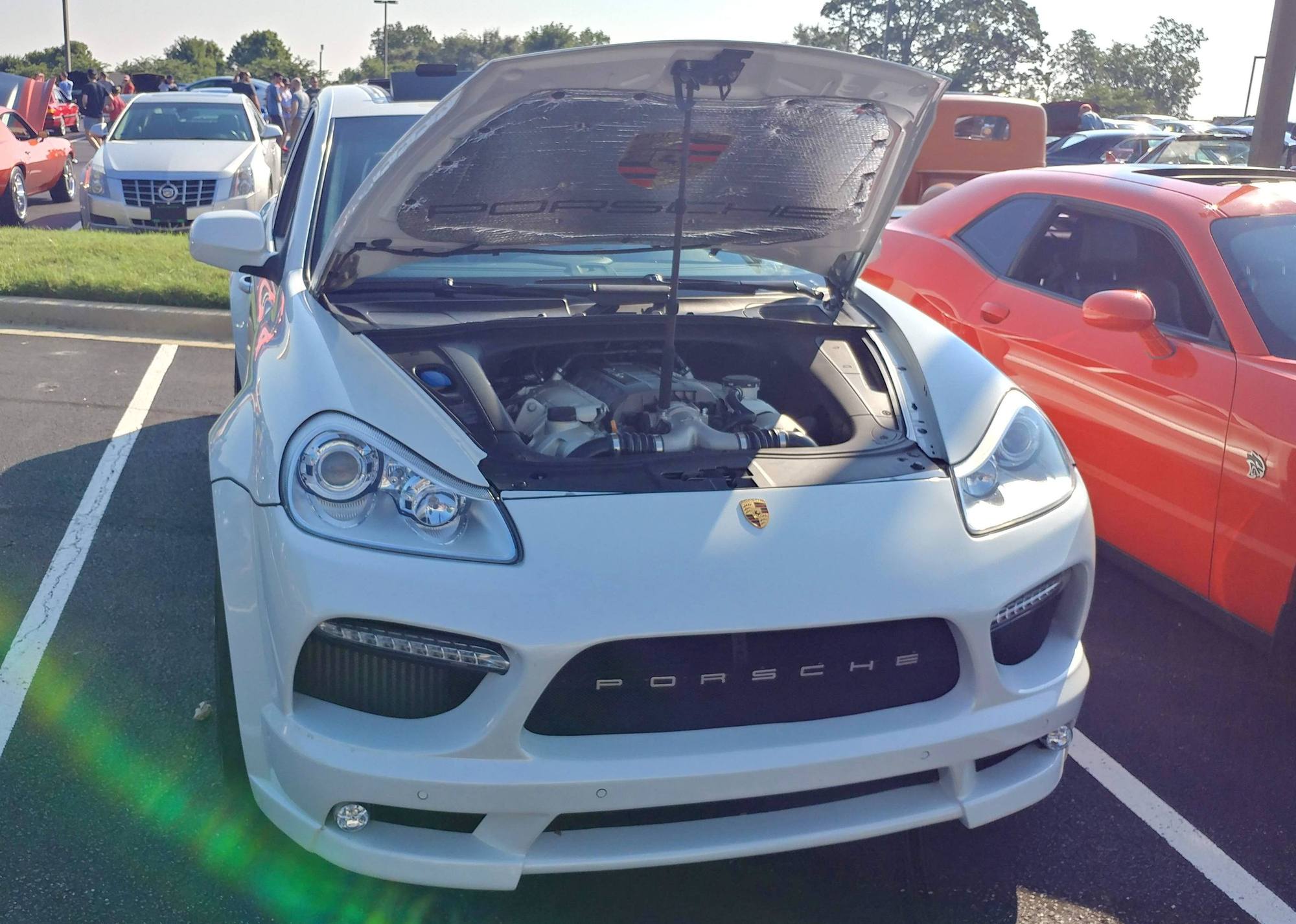

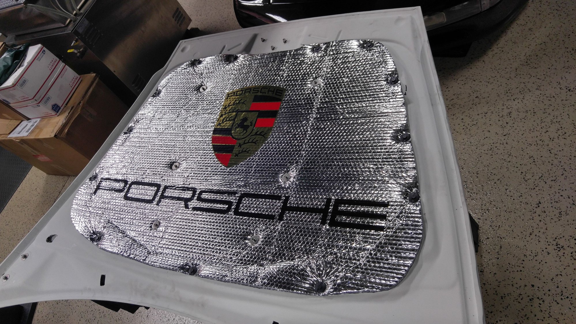

I was more concerned about protecting the paint on my hood from the heat than extracting it so I made a custom hood heat shield pad. The front openings in my widebody bumper setup are so big that all that air coming in has to be going somewhere (probably out between the cowl and trailing edge of the hood) and taking the heat with it. On a regular Turbo, I think one of those aggressive hood designs might look out of place without corresponding body mods that match it.

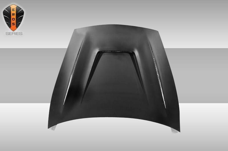

Thanks for the follow up. I agree the aggressive hood would look out of the way and while it’s not a bad deal at 450$ish, I would hate to have a aftermarket hood off on the body lines because that’s what you look at all the time! I am concerned about underhood heat and also looked at the back seal and possibly removing that in two sections to allow heat to escape out at the cowl with no other modifications.
thats a awesome heatshield^
The vents on the hood though seem to be in the right location though for the low pressure radiator and side exit heat locations wear the turbos are. Here is a example of a color matched hood with no body kit. I have a 955 so it’s not going to look the same:

Here is another example of what I could do/ modify a stock hood and add the metal mesh behind:
