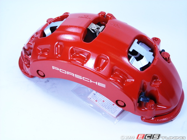

Hello -
Is anyone aware which of the OEM late model calipers are a direct fit on a 04 CTT?
Also do any of these options use the same size rotor and just have bigger pistons/pads?
Thanks!
Is this 08 turbo caliper a direct fit and would it be considered a performance/efficiency upgrade?

They all bolt up the same, but are designed for their appropriate rotors. That caliper, for instance, is designed for a 368mm rotor. You would need at least 19" wheels to clear them (not an issue for most 955 Turbos).
