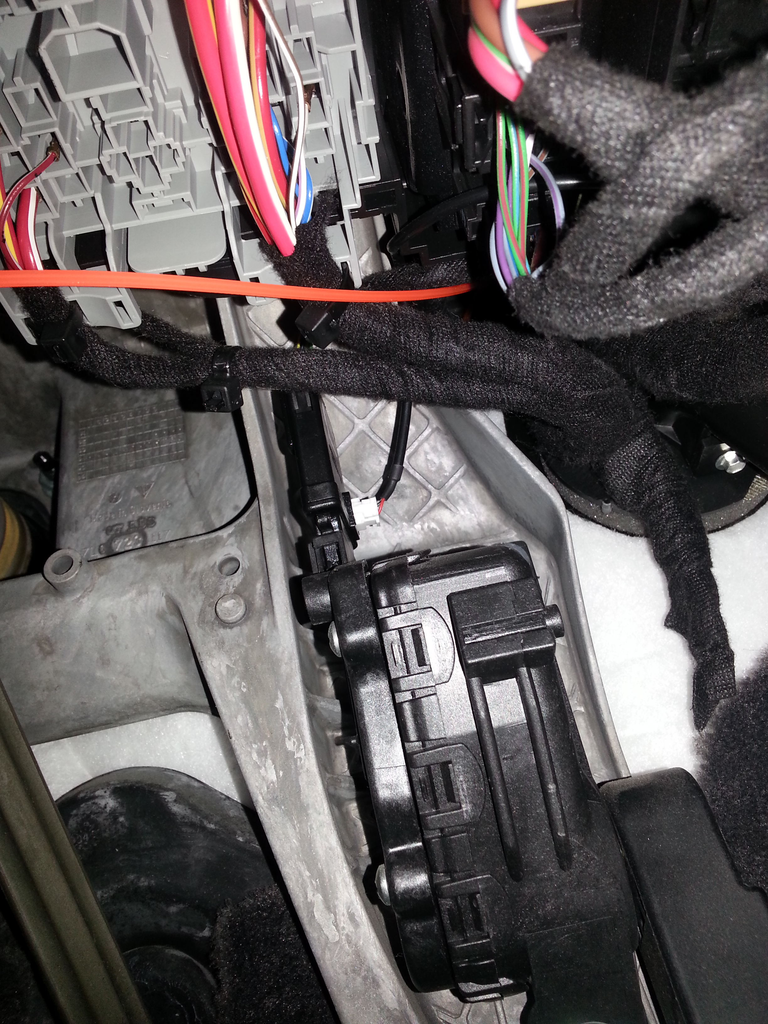

Is this what you are asking to run boost line through the firewall?
Yes sir! Where is that? Please don't tell me passenger side. I'm going to look at the wire bundles that go in under the driver's side fender. I'm not sure where they come out inside though and if I can get to it.
Any help will be appreciated!!
Old Jan 15, 2015 | 05:11 PM
TT VIPER's Avatar
Joined: Jun 2008
Posts: 138
From: Europe
TT VIPER is infamous around these parts
Well, let me start by saying it's not on the passenger side. It's on the driver side but it's not easy to get to. I will take more pictures tomorrow showing its exact location.
I'm glad to help.

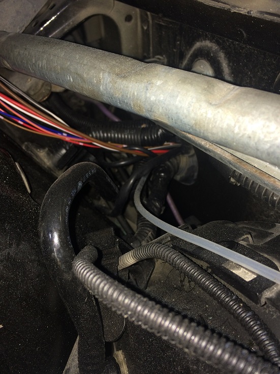

OK I found the spot you were talking about. After a few missed tries and one pair of scissors dropped under the fuse panel I have a route ready. The only problem is there is nowhere near enough hose that came with the gauge to make the total run.
I'm done for tonight so will grab some more hose tomorrow and run it. Once you figure it out it won't be bad. I'll try to take pics but the areas are hard to get to. Can't wait to get this thing running.

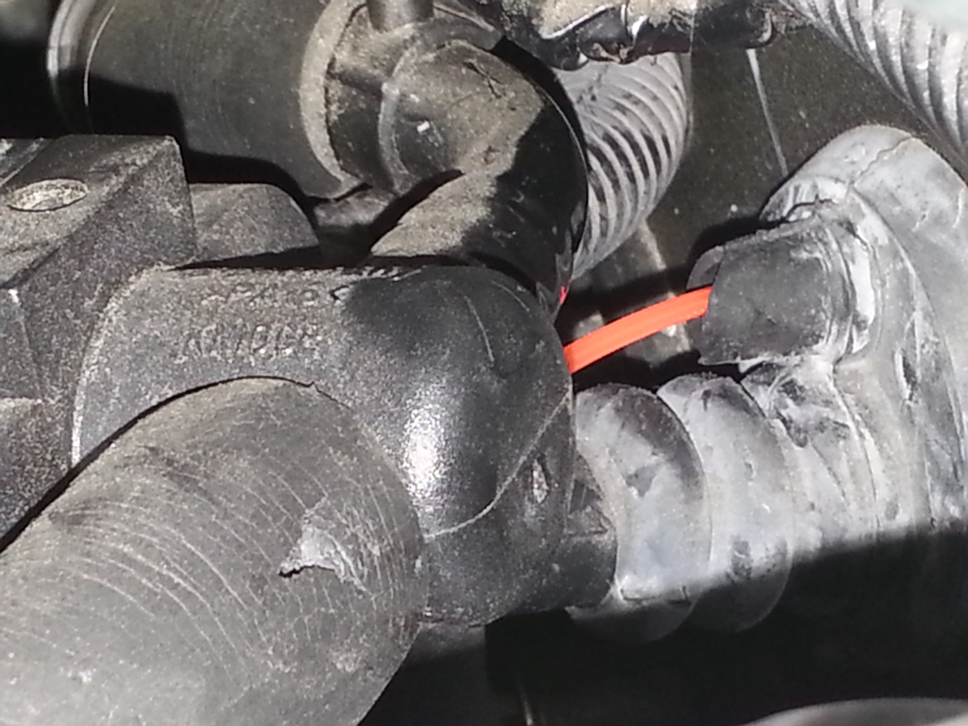

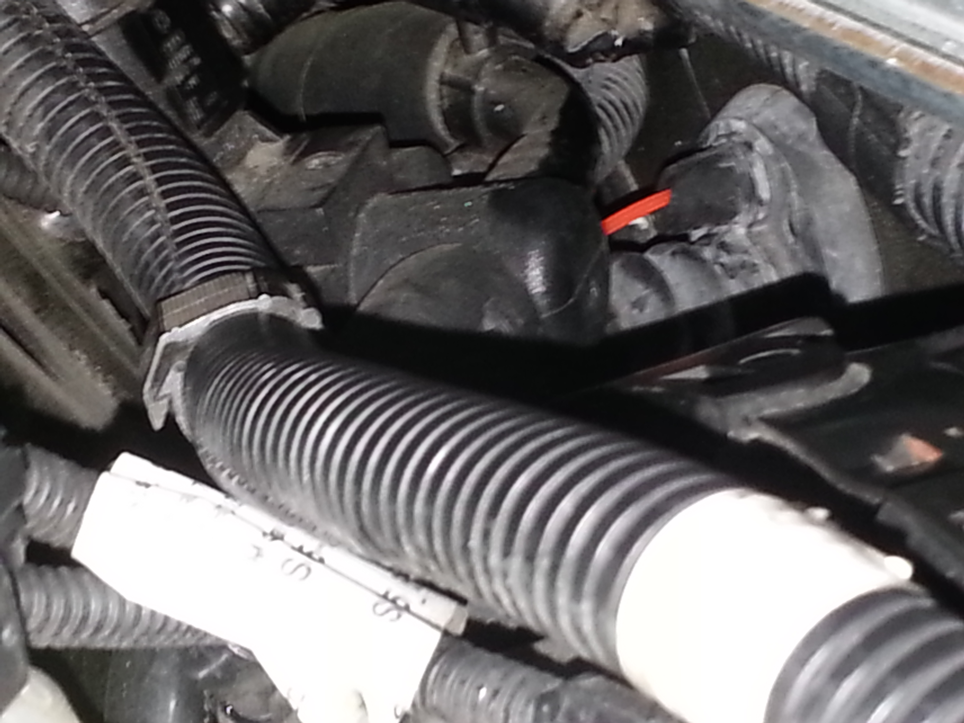

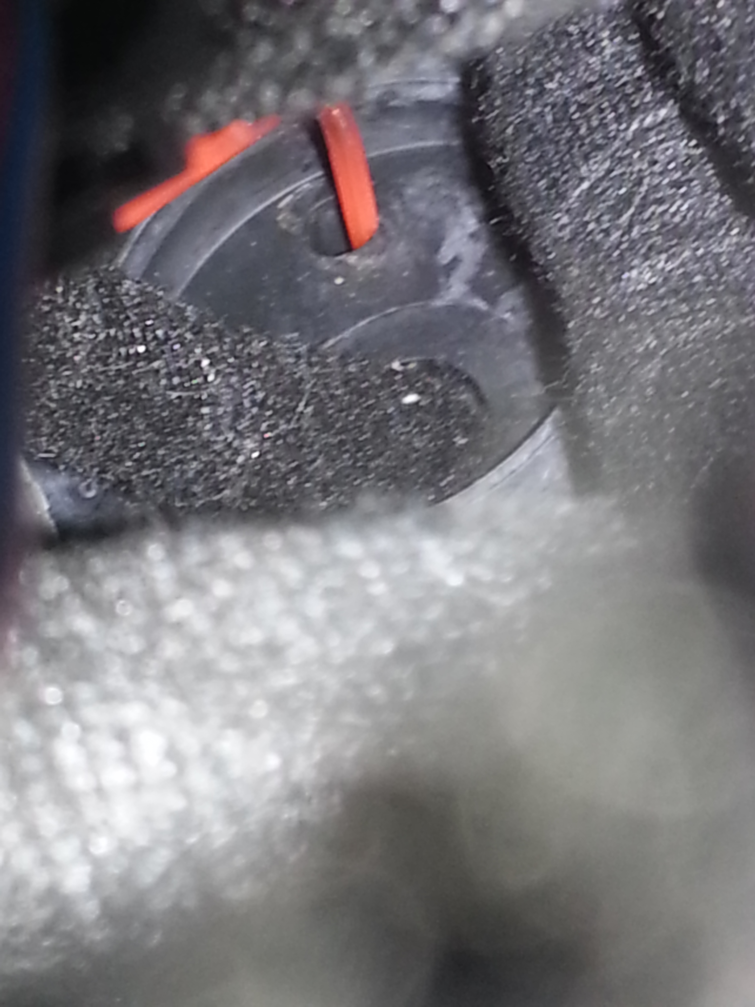

Had some fun today running the hose. I'm posting some pics here but it's really hard to get a decent shot it's so tight. The pic TTviper posted above gave me the clue I needed because I could see the brake booster in the corner.
So here is what I did. Take the small cover over the brake reservoir off and you can look in behind it almost to the center of the car. You should see something that looks like TTvipers pic and one of mine. I noticed there was a rubber nipple sticking out of the top. I took a piece of wire and went in under the dash and found a hole in the same area. Inside it is just about right above the gas pedal. Hard to get to and hard to see. I was on my back and looking right to the inside of the fuse panel.
I cut the tip off the nipple and was able to thread a piece of weed-eater line through. That's the orange bit in the pic.
Then it was "simply" a matter of threading the plastic vacuum line through it and hooking both ends up. After coming out of the nipple I threaded it around stuff and through a little hole right where the hood strut is.Then back under the fender and down behind the airbox and headlight and "T"'d into the vacuum line for the left diverter valve.
You need to switch the P3 boost setting from digital to analog and then calibrate it. Pretty easy.
And the result is IT WORKS. I still need to play with it some more mine is set on single digit display now and I think I want more resolution.
