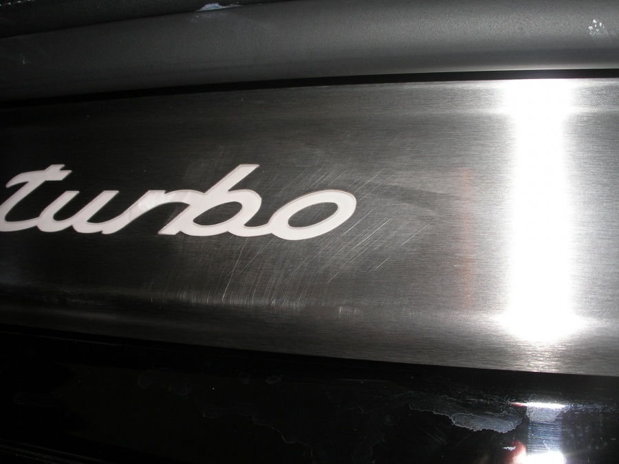

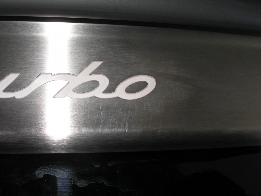

A few weeks ago I posted about a product that I was waiting to try...well, here are the results:
Problem...scratched stainless entry sill:

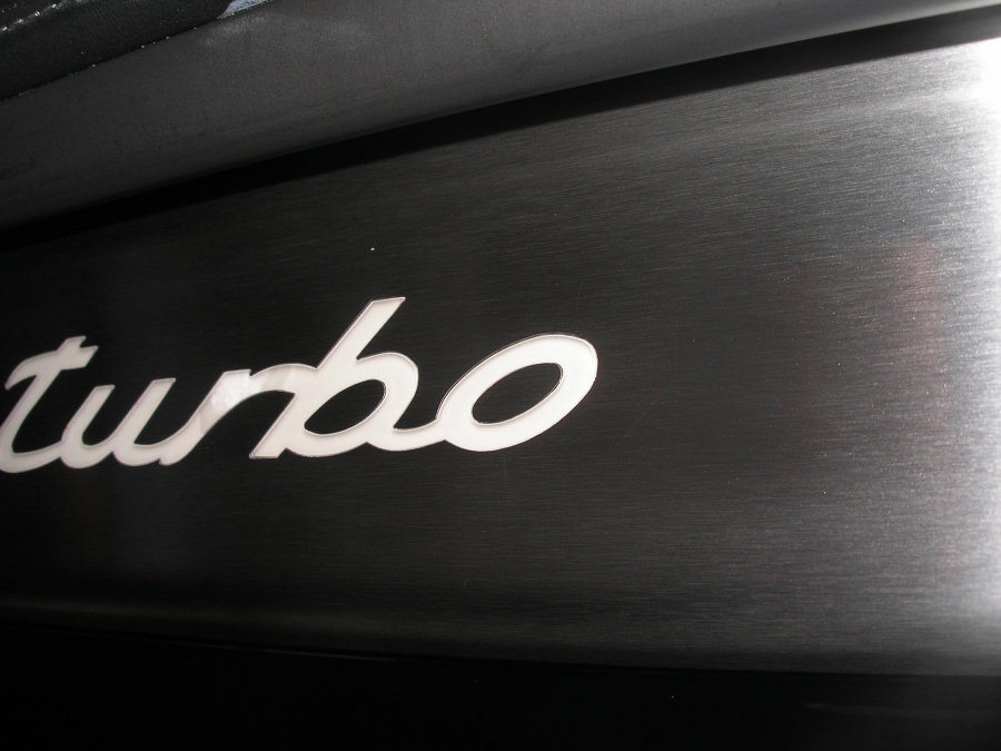

Using a product called Scratch-B-Gone, I fixed the problem without spending hundreds to replace the sills:

Thanks...this is the first metal scratch removal product that works well, keeps the "grains" correct, and oxidizes the metal so the repaired area does not look out of place...for about $50, I'll keep it in my detailing battle chest. It definately works.

Thanks everyone...I did a few more "gentle" passes and the rest of the deeper scratches are now feathered in...
