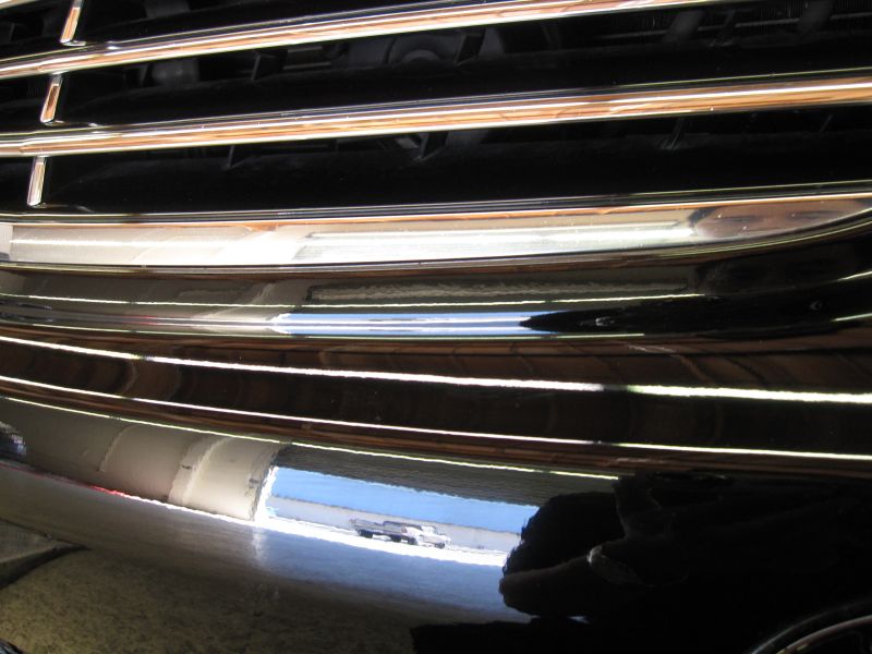

Here is another vehicle with similar razor cuts, but this one is actually much deeper. Although many people do not understand why it happens, it really comes down to companies that are either very new to the industry or they have never received proper training in custom applications.

We have been in this industry since 1997 and we have been seeing this type of damage picking up in recurrence in the past 5 years. Most consumers do not know better and generally rely on a "certificate" that he is qualified to perform the work. In many instances there's more damage going onto these cars then the protection being received.

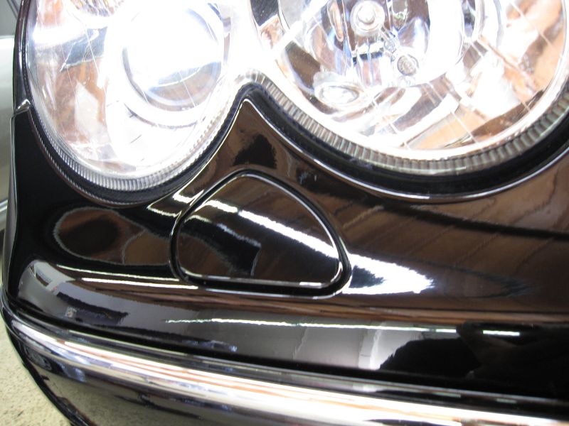

We were able to polish off some of the lighter cuts, but the remaining deep cuts are permanent.
Here are pictures of the finished product by our crew.

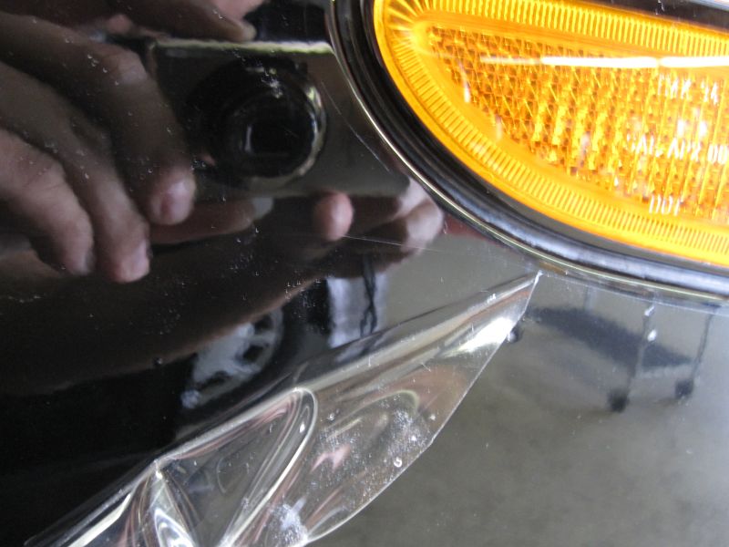

As the economy run through this deep flux, we have seen quite a few new companies joining the industry. Good for competition, but bad for consumers especially with the lack of experience. Here is another example of what may go wrong in the event of having a bad install take place..
HEAVY DIMPLES AND STRETCH MARKS

The dimples and excessive stretch marks come from the adhesive getting distorted and damaged from improper application. Now this is not to say that a good install is completely free from such defects, but those depicted in these pictures were obviously bothering the customer. He decided to not take it up with the previous company and decided to have us redo just about everything.
There are excessive gaps and inconsistent cuts that also bothered this customer.

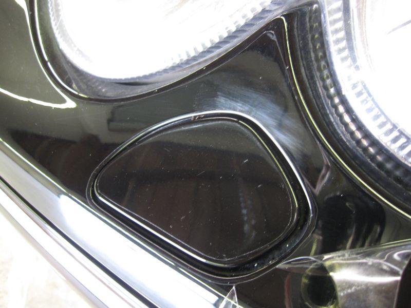

As we removed the film, not surprisingly considering the jagged cuts and gaps, there were razor cuts on the paint as well left by the previous company:
Some very deep, some very light cuts in the paint. All unacceptable

A pre cut kit will not necessarily guarantee you won't have cut paint. A lot of inexperienced installers will cut when they feel they can't get the film to lay flat. When installing a clear mask, shop around for quality, not price. As Premier has shown here, poor installations can cost you more money and headaches in the long run.

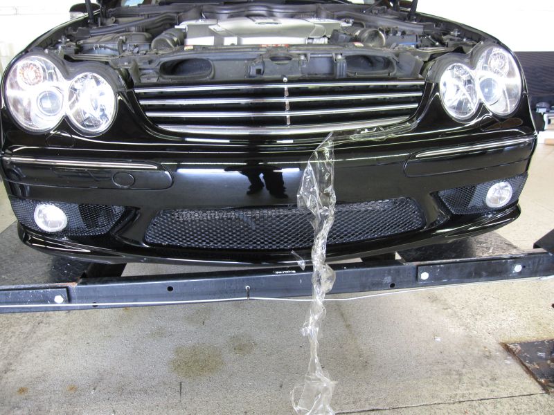

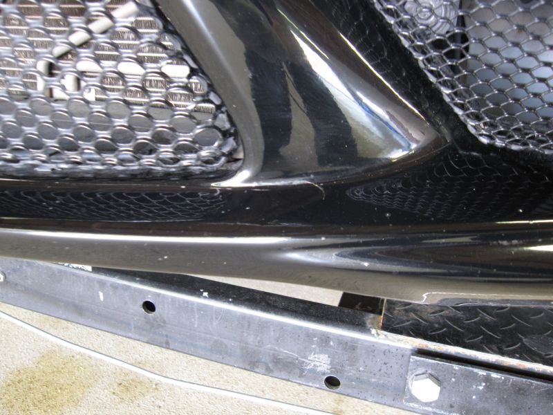

Just wanted to share some more photos of another car that just came in this morning. The previous owner actually thought it was a pretty good clear bra installation. This all comes down to what each individual's willing to accept. Some have higher tolerance than others.
