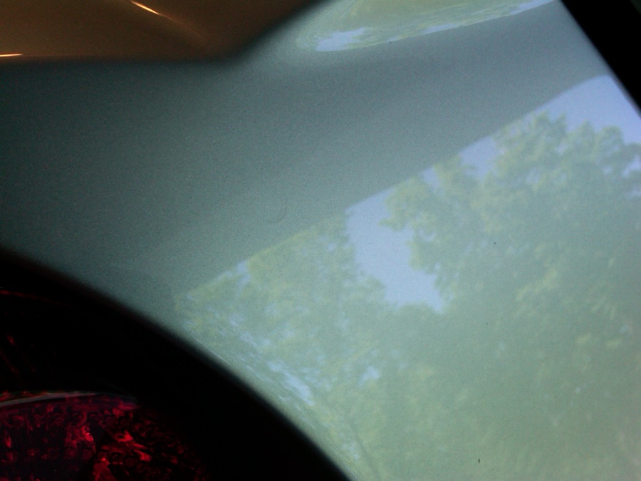

Paint drip on new Ferrari 599 between tail light and trunk. Do you think it will sand out? I'll bring it to the pros, but just wanted an opinion - naturally don't want to start respraying the area. Thanks!

It looks like it could easily be fixed. I would definitely bring this to a professional for repair. I would scrape off the run with a sharp new razor blade, then wetsand the remaining with 1000 grit then 1500 then 2000 then polish out. When you scrape off the run with a razor blade, you hold the razor blade at 90 degree angle towards the paint, and simply skim off the top of the run, and work it down until you get to the point where you can wetsand flat. Best of luck.

is the car still under warranty, they should take care of it... love your avatar btw, grand nagus zek is one of my favorites..
