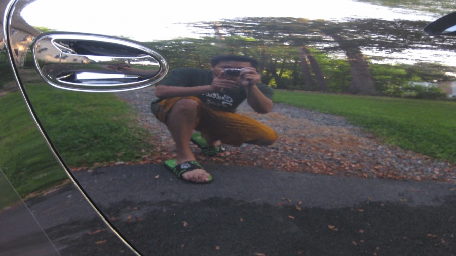

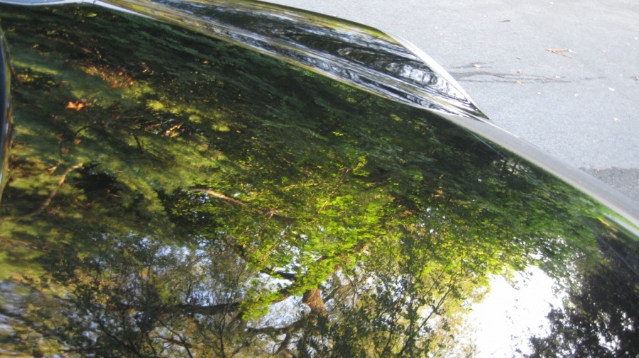

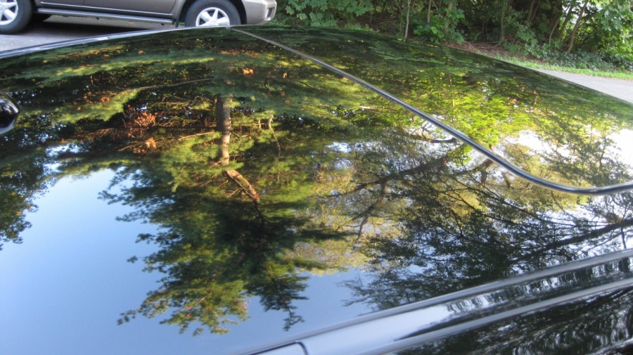

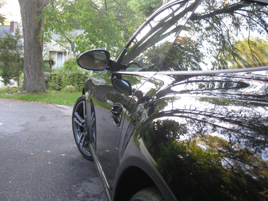

some pics...

Looking good. Thanks for sharing.
