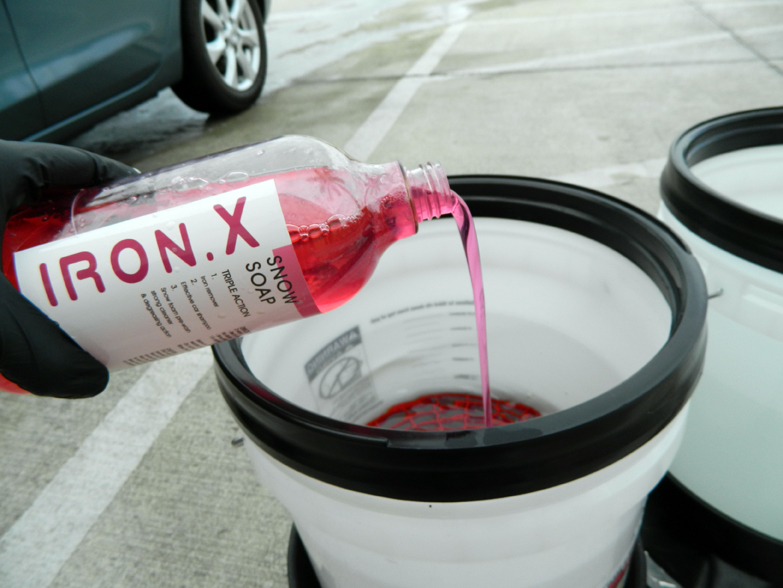

To deep clean the paint on my Mazda, without compromising the protection provided by Cquartz UK Edition or RELOAD, I used CarPro Iron X Soap Gel.

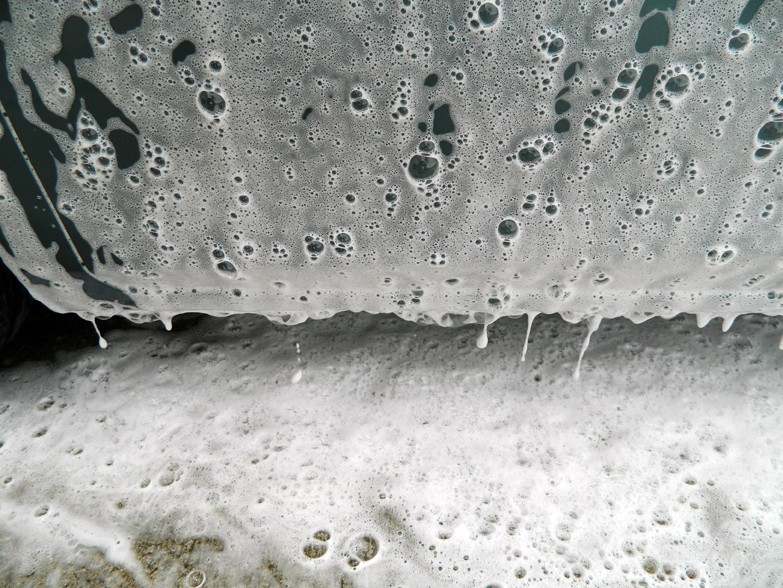

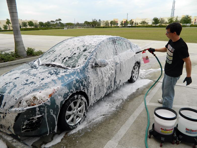

Iron X Snow Soap by CarPro decontaminates automotive paint, glass, chrome and wheels by removing corrosive iron particles. Iron X Snow Soap opens up the pores in the paint as you wash your vehicle, releasing ferrous airborne particles before they can cause further damage. Iron X Snow Soap is also formulated with an advanced blend of degreasers so it has the power to cut through heavy road film leaving paint squeaky clean and ready for polishing.
I added a couple ounces to the wash bucket on my Grit Guard Dual Bucket Washing System and a couple more into a Detailer's Half Gallon Foamaster Foam Gun. CarPro Iron X Snow Soap produces mounds of thick, luxurious suds when used with a Foamaster Foam Gun or Foam Cannon HP.

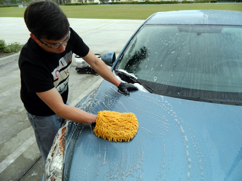

After letting it dwell on the vehicle for a couple minutes, I used a Gold Plush Micro-Chenille Wash Mitt to remove a month's worth of dirt and grime. In terms of bang-for-your-buck, you can't beat the Gold Plush Micro-Chenille Wash Mitt. This mitt is a generous 11 x 8 inches and is super soft. After washing the vehicle, I thoroughly rinsed it.

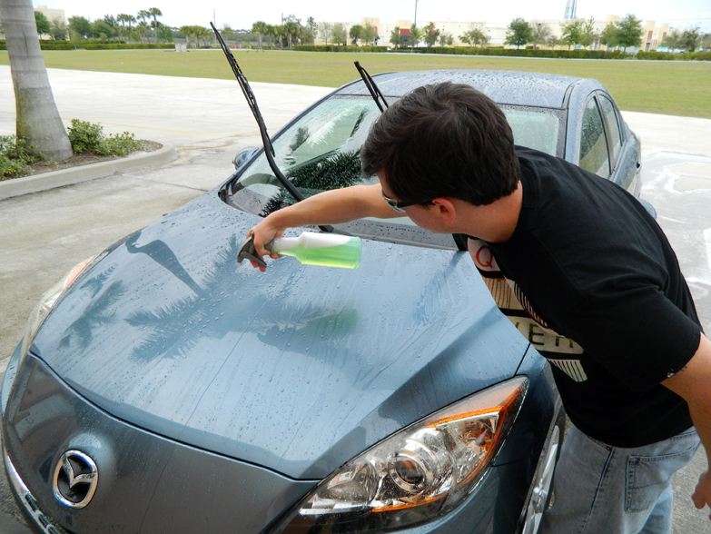

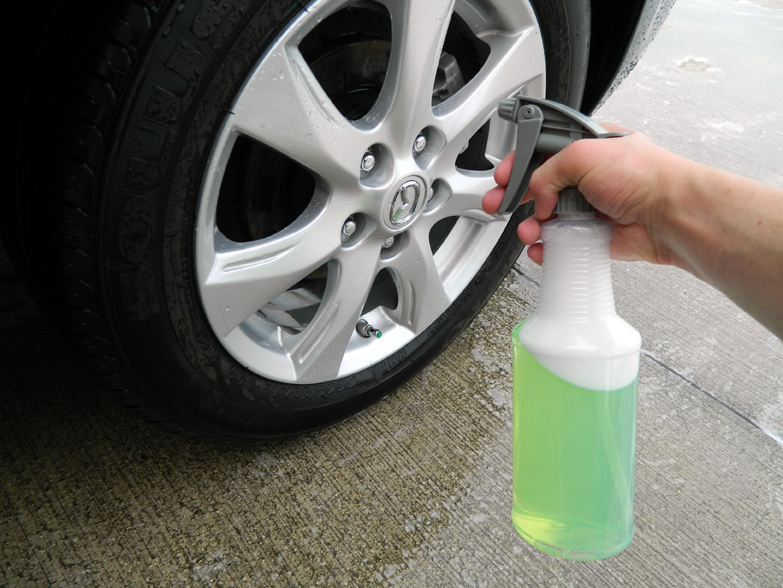

CarPro Hydro2 Touchess Silica Sealant is a concentrated solution. You dilute 1 part concentrate with 3 parts water. I diluted the product per the manufacturer's recommendations into a 32 oz. Heavy Duty PVC Clear Spray Bottle.

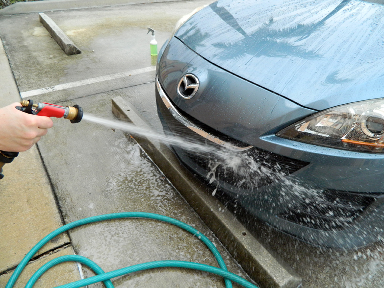

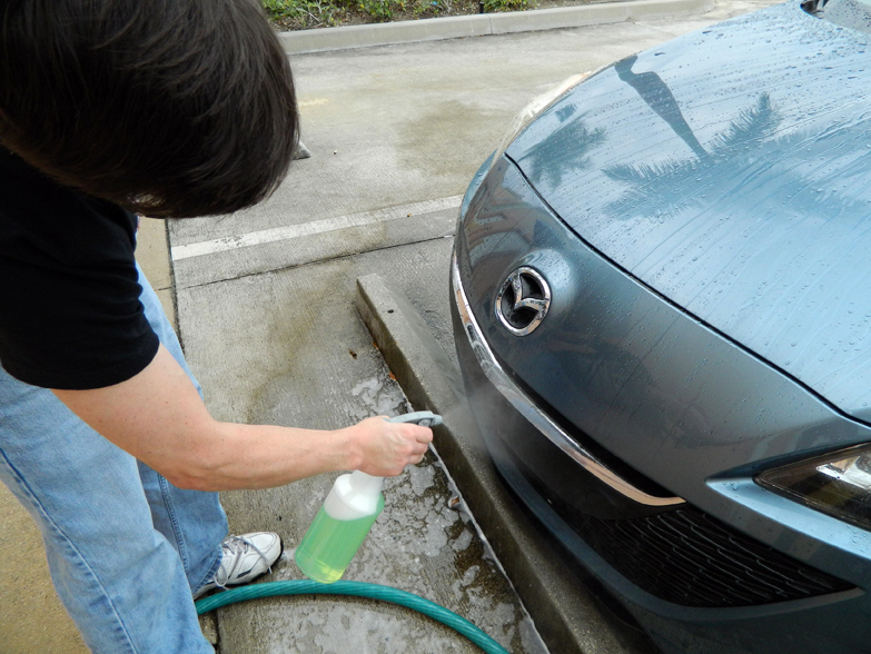

Spray on and rinse off – that’s how simple CarPro Hydro2 Touchless Silica Sealant is to apply. Read that sentence again – notice anything? There is no rubbing or buffing when you apply CarPro Hydro2 Touchless Silica Sealant. Simply wash your car like you normally would and while it’s still wet, spray Hydro2 over every surface including paint, wheels, chrome, convertible tops, and glass, and simply rinse it off. After you’ve thoroughly rinsed Hydro2 off the surface, dry the vehicle with a quality microfiber drying towel or car dryer, like the Metro Master Blaster. That's exactly what I did with my Mazda.
Tip: It's best to divide the vehicle into 3 sections. Spray the product onto a section and immediately rinse off. You do not want to apply Hydro2 in direct sunlight or let it dry on the surface.
Apply to paint...
Plastic trim
Wheels/wheel wells

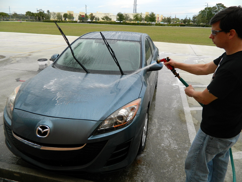

Step 3: Rinse
CarPro Hydro2 Touchless Silica Sealant needs to be thoroughly rinsed off the vehicle.

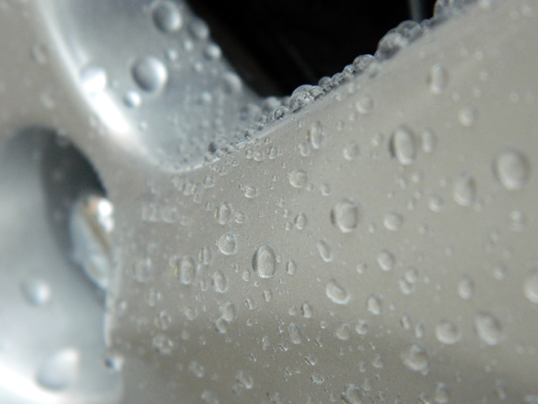

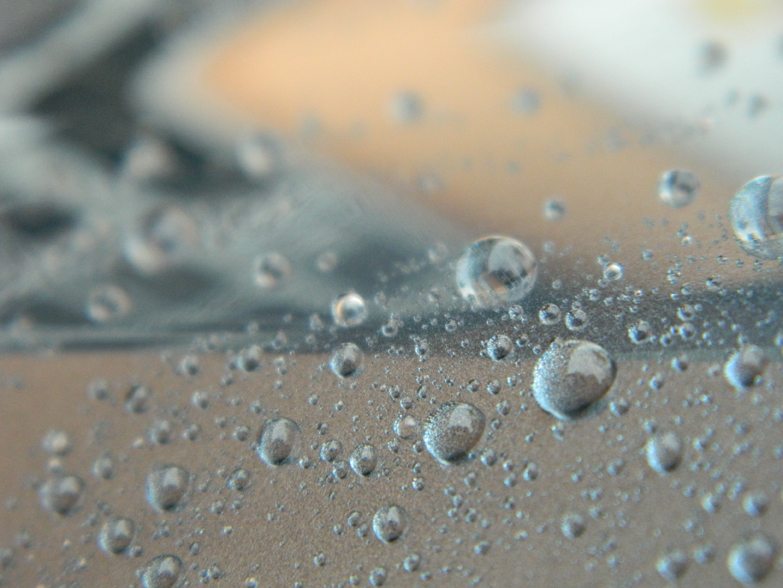

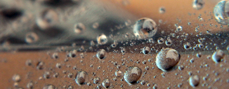

Beading
CarPro Hydro2 Touchless Silica Sealant creates an immense amount of surface tension, causing tight water beads. Check out the following beading shots I managed to snap before drying the vehicle.

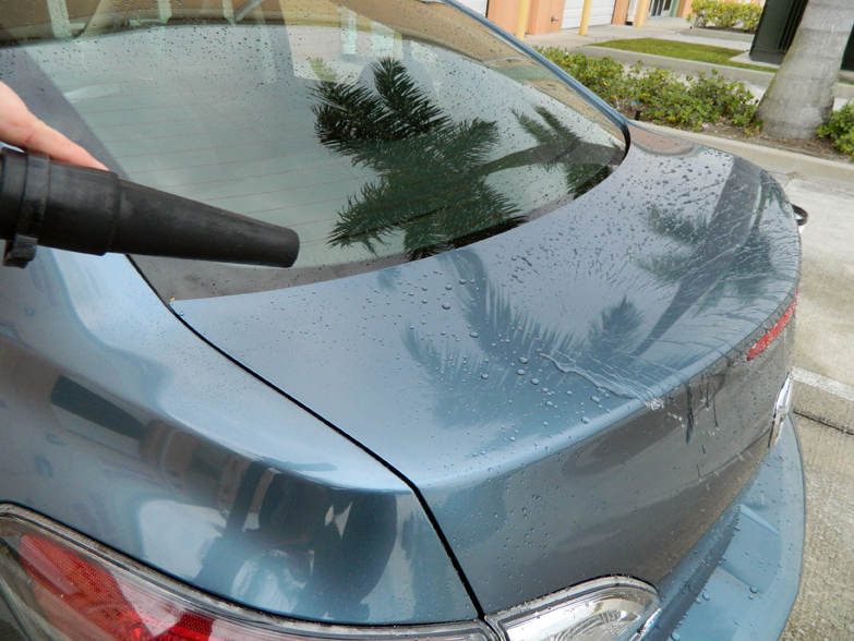

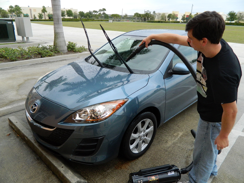

Step 4: Drying

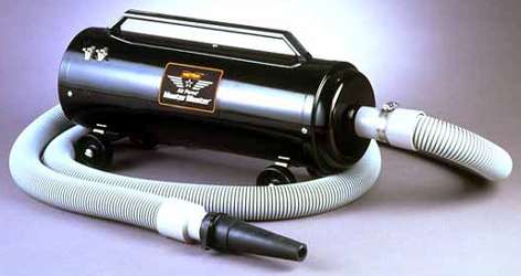

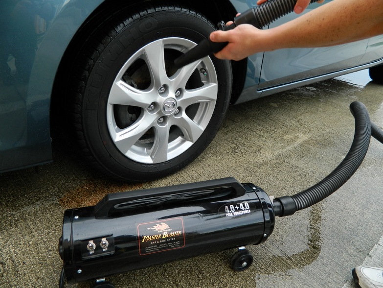

You have two options for drying the vehicle: Use a quality microfiber drying towel, like the Waffle Weave Guzzler, or a car dryer, like the Metro Master Blaster. I went with the latter for obvious reasons.
The MasterBlaster has an 8.0 Peak horsepower motor that blasts air at an impressive 58,500 feet per minute compared to the Air Force Blaster blowing 29,250 feet per minute. The MasterBlaster now comes with wheels for easy maneuvering around your vehicle or bike. This blower is equipped with two levels of velocity for super fast drying or for blowing off smaller more fragile areas. The filter on this beauty is easy to clean and can be washed and reused. Your vehicle will be gleaming in no time so you can hit the road and cruise on into the sunset.
The Metro Master Blaster is a HUGE time saver. It will blow water out of cracks and crevices that you could never dream of drying with a towel. Best of all, it's made in the USA and built to last.

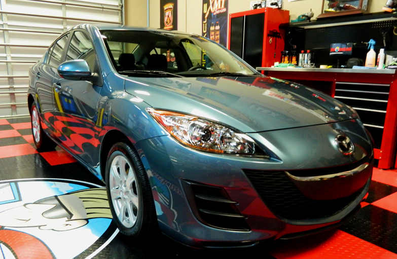

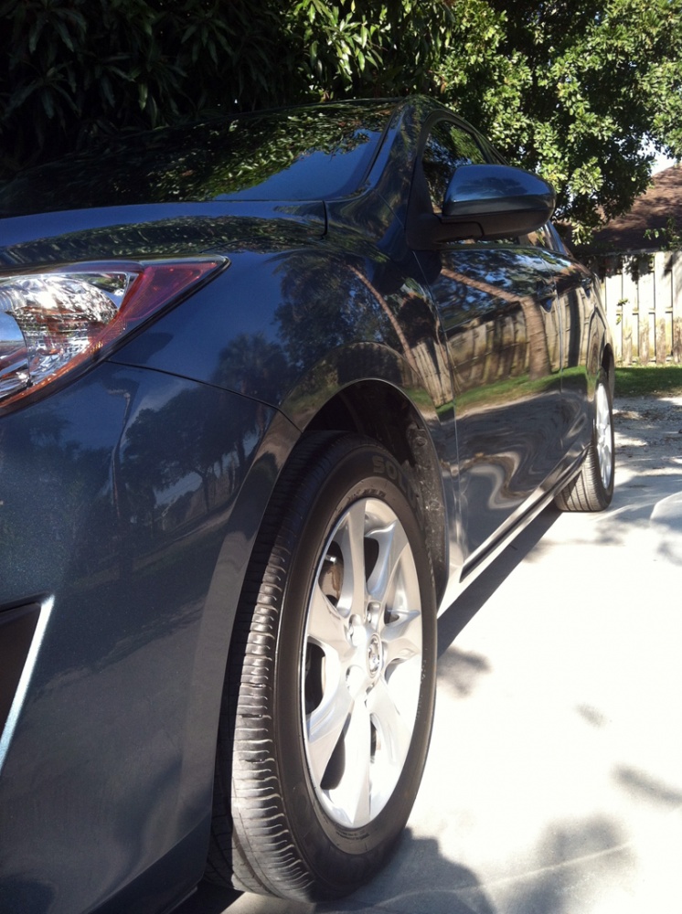

Within a matter of minutes my Mazda was dry and glossier than ever. To say I was blown away with the level of gloss and slickness my Mazda's paint exhibited after using Hydro2 Touchless Silica Sealant would be an understatement.

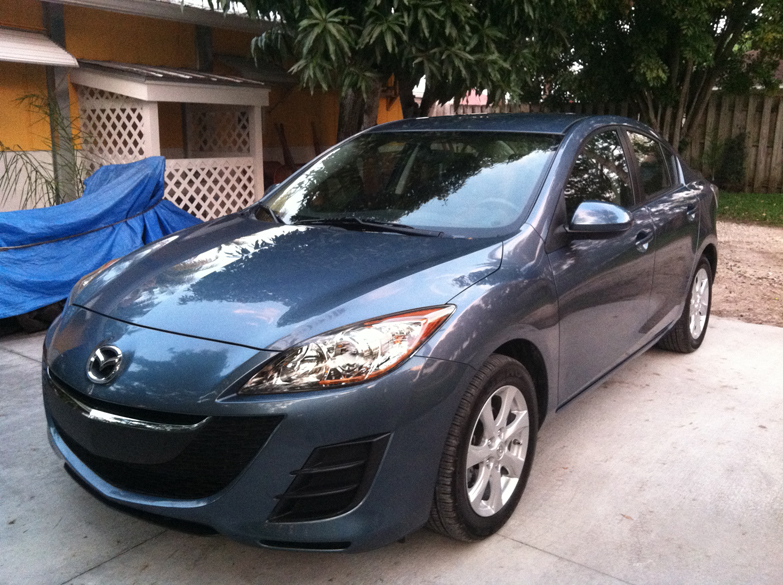

Here's a picture taken with my iPhone 4 after arriving home.
