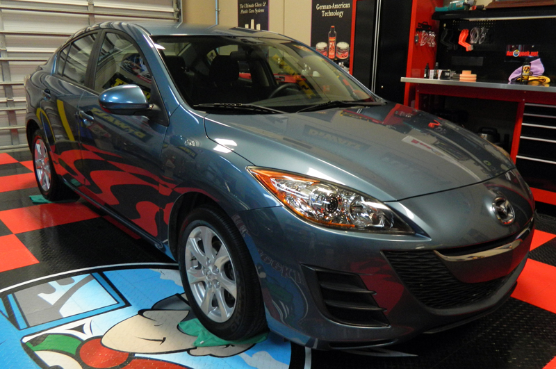

Bryan and I stuck around Saturday after work and gave my 2010 Mazda 3 a complete Detailer's makeover. The product of choice to protect the paint was Detailer's Paint Coating. Here's how you properly apply it:

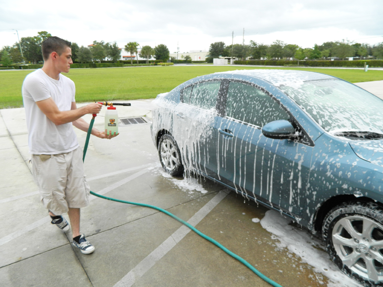

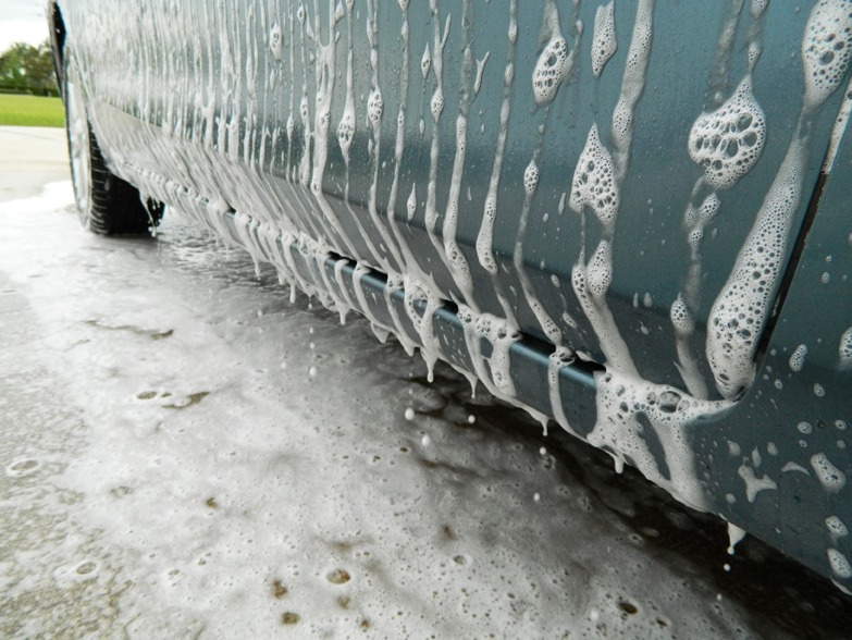

Application of Detailer's Paint Coating is simple. First, you want to start by washing your vehicle. Bryan and I used Detailer's Xtreme Foam Formula with a mixture of Detailer's Road Kill Bug Remover in a Foamaster Foam Gun. Bryan will be posting a thorough review of all of the above this week.
Here's Bryan spraying my car down with foam.

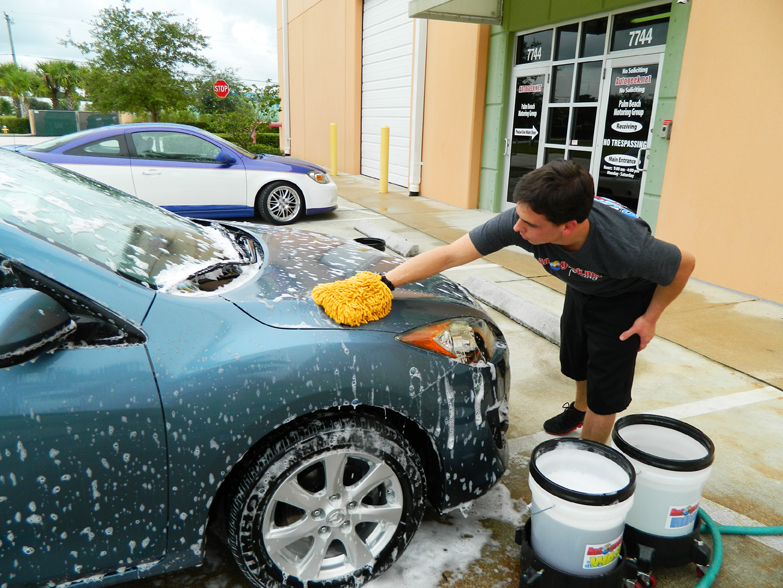

Here I am giving my Mazda a bath. The Gold Plush Micro-Chenille Wash Mitt is an inexpensive, soft, quality wash mitt for cleaning your vehicle.

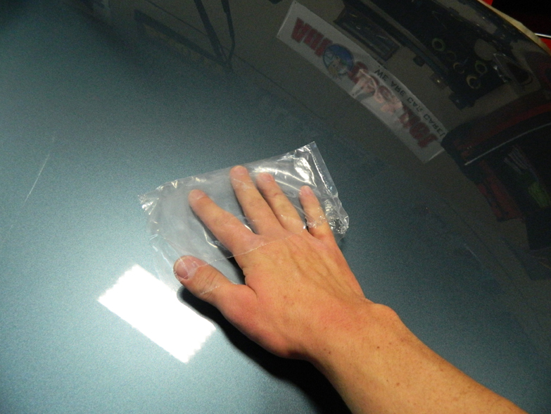

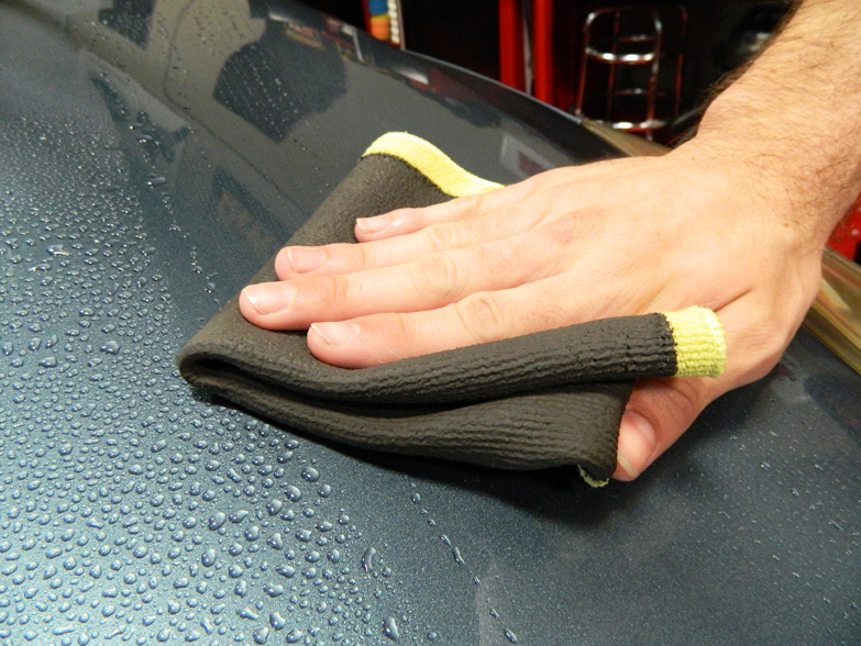

After we washed and dried my Mazda, I pulled it into the Show Car Garage to inspect the paint. There was no evidence of swirls or scratches, but the paint was awfully gritty to the touch. By placing my hand in a plastic sandwich baggy, I was able to get a true idea of how contaminated the paint was. The plastic sandwich baggy intensifies the feeling of your finger tips. Try it!
In an effort to save time, Bryan and I used the Nanoskin Autoscrub Towel to remove the above-surface bonded contaminants. The Nanoskin Autoscrub Towel is arguably one of the best inventions in car care. This step is crucial because it removes above-surface contaminants that would otherwise inhibit the bonding of the coating. Expect a review of the Nanoskin Autoscrub Towel from Bryan this week.

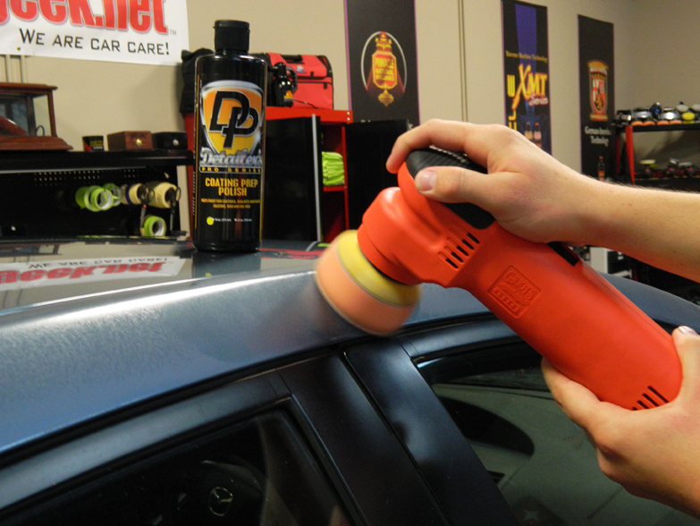

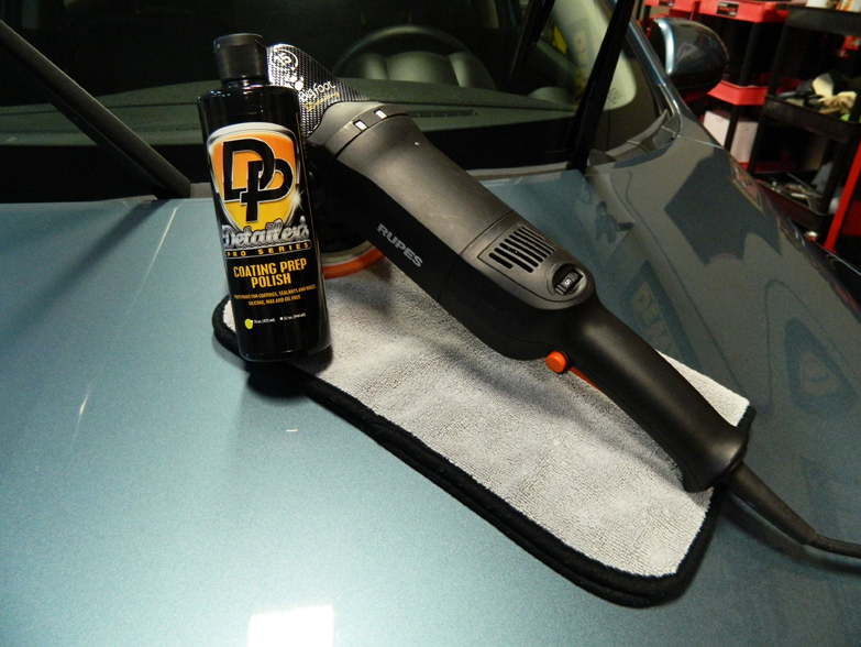

The polishing step is the most important step in applying Detailer's Paint Coating. Polishing removes below-surface contaminants that would otherwise prevent the coating from properly bonding. We've introduced a special polish that takes the guesswork out of chemically stripping the finish using IPA or other volatile cleaners - Detailer’s Coating Prep Polish
Detailer's Coating Prep Polish is a non-abrasive chemical polish that deep cleans automotive paint, ridding it of below-surface contaminants that will prevent a coating, paint sealant or wax from properly bonding. Formulated without any silicones, waxes, sealants, polymers or fillers, Detailer’s Coating Prep Polish leaves nothing on the surface, making it the ideal polish to use before applying any product that requires a 100% oil and wax free surface.
Detailer’s Coating Prep Polish is the only polish specially formulated for application of permanent and semi-permanent paint coatings. By creating a polish that doesn’t have any oils, waxes, silicones, polymers or fillers, you can apply a paint coating immediately after polishing your paint with Detailer’s Coating Prep Polish. There is no need to chemically strip the paint using isopropyl alcohol or volatile wax and oil removers.

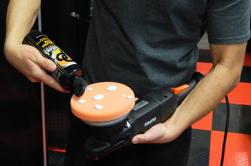

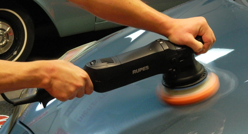

Rupes LHR 15ES Big Foot Random Orbital Polisher
Bryan and I both used a Rupes LHR 15ES Big Foot Random Orbital Polisher equipped with a 5.5 Inch Lake Country HYDRO-TECH Tangerine Polishing Pad to apply Detailer's Coating Prep Polish. The Rupes LHR 15ES is incredibly smooth and easy to handle, making it a great choice to use with Detailer's Coating Prep Polish.
The Rupes LHR 15ES and the 5.5 inch Tangerine Pad proved to be the perfect combination to remove the below-surface contaminants on my Mazda. Smooth sailing!

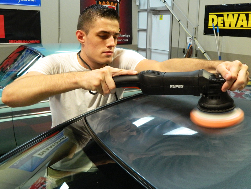

Here's Bryan polishing the roof:

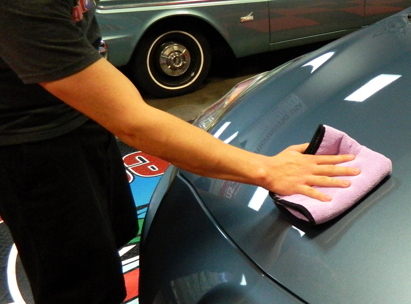

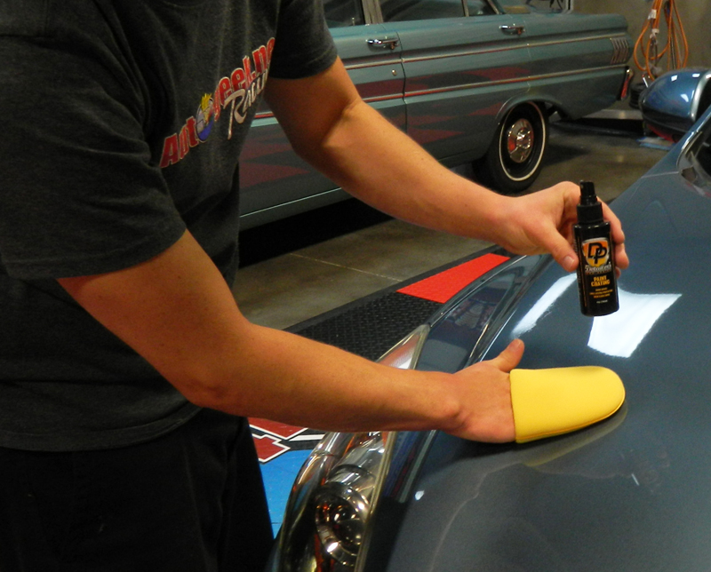

Applying Detailer's Paint Coating is similar to applying your favorite WOWO (wipe on walk away) paint sealant. Mike Phillips discovered the Gold Wax Finger Pocket to be the perfect applicator; I agree with him. These applicators are super soft, easy to hold on to and very inexpensive.
Simply spray the coating directly onto the paint and evenly distribute using the Gold Wax Finger Pocket. I distributed the product using a side to side, then up and down pattern, working one panel at a time (hood was divided into two panels). Any high spots were quickly leveled with a Super Plush Junior Microfiber Towel.
You may be thinking..."is it really that simple?" The answer is YES!
First, we avoided using any type of IPA or volatile wax remover by polishing the paint with Detailer's Coating Prep Polish. Then, we went right to the coating which only took minutes to apply - no heavy rubbing, buffing or examining the paint with a microscope was required.

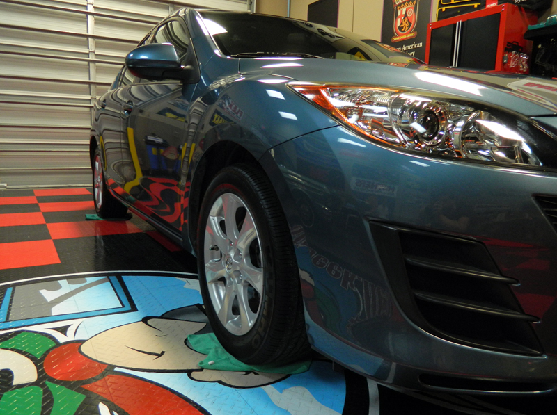

Let There Be Gloss!
Detailer's Paint Coating provides a highly reflective, glassy shine. It is the perfect complement for any color vehicle. If I decide in a couple months that I want to add a coat or two of my favorite carnauba wax, I can do so without any issue - Detailer's Paint Coating was formulated so it can be topped with your favorite wax or paint sealant.
