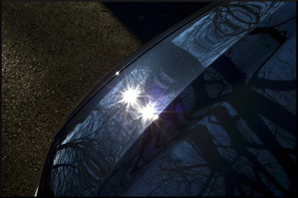

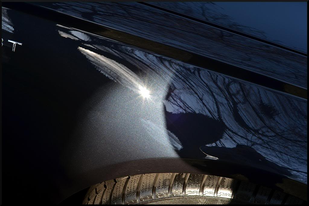

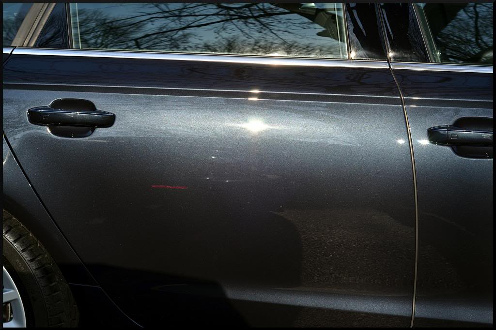

The vehicle was also washed with ONR and quickly dried with an Autoality WW towel. We check out the lower panels, and there weren't any embedded contaminants so we didn't need to clay on this vehicle, so we moved right to the polishing. After a little testing we ended up using Menzerna PowerFinish on a Tangerine HT pad with a Meguiars G110 DA. This gave us almost perfect correction, 95%+ of the swirls and scuffs were removed. Here is how the paint looked in the sun. Sorry no before pics of the swirls, they weren't crazy, but they were there.

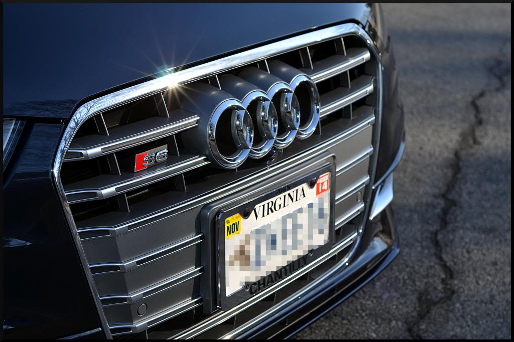

After all the paint was corrected we wiped it down with CarPro Eraser to prep it for the Opti-Guard application. We then applied Opti-Guard to the paint, wheels, trim, and glass. As everyone knows Opti-Guard gives an amazing gloss to the paint, especially when it has recently been buffed closed to perfection.

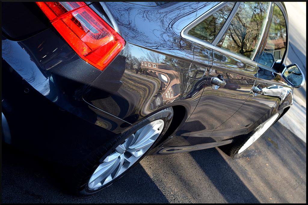

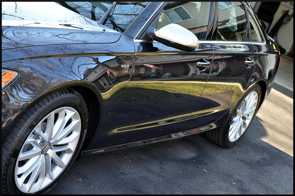

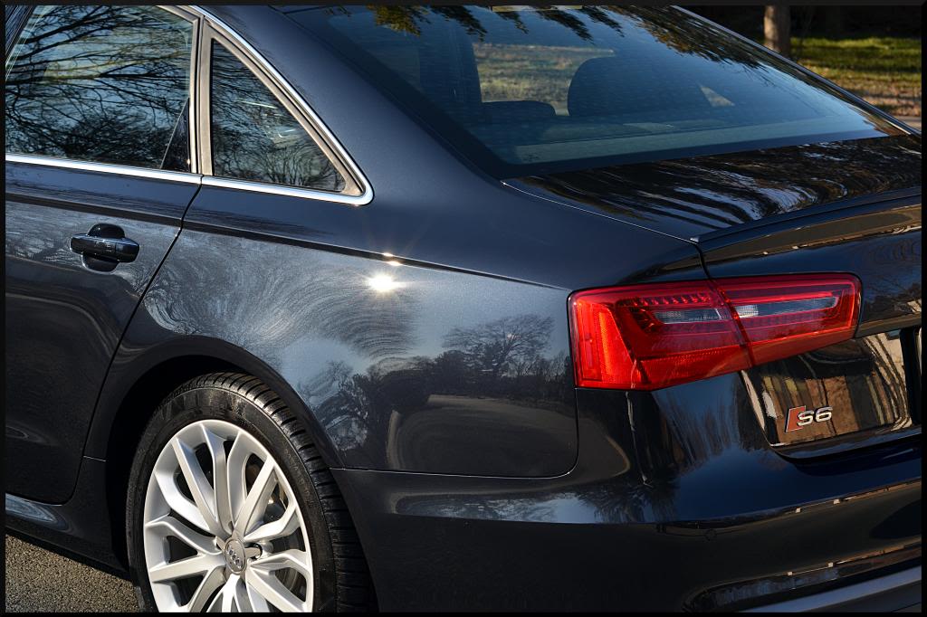

We really love this color because in the bright sunlight it looks blue but in the shade it looks almost black and has some great depth and reflective properties.

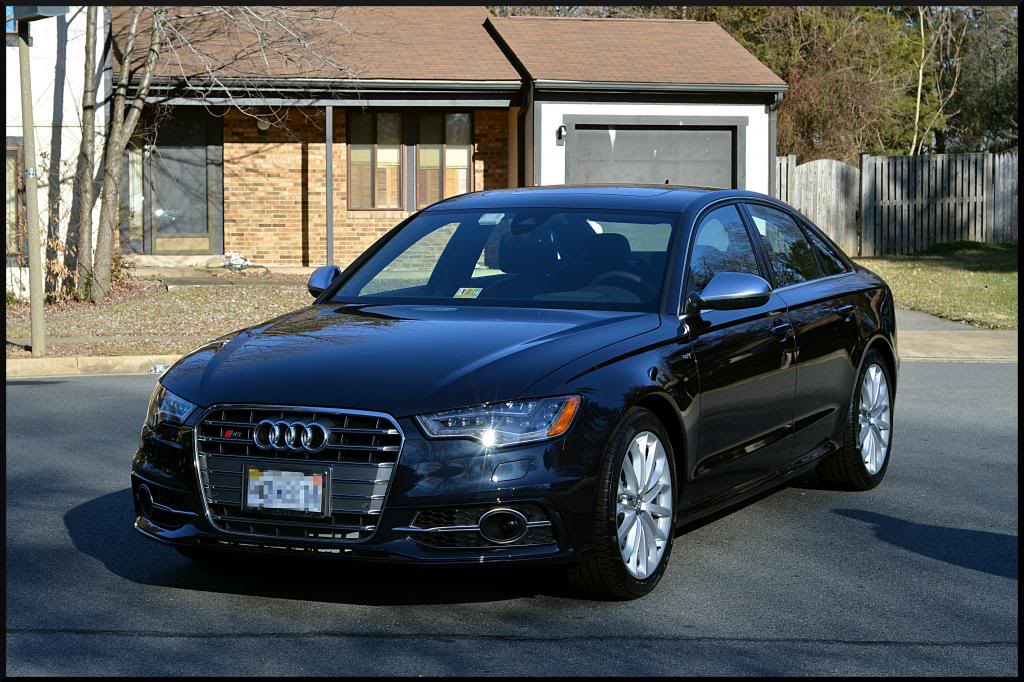

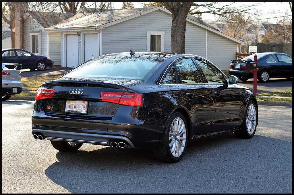

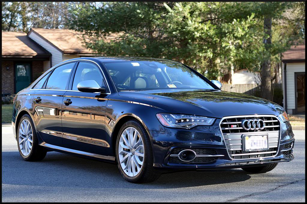

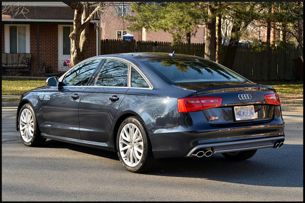

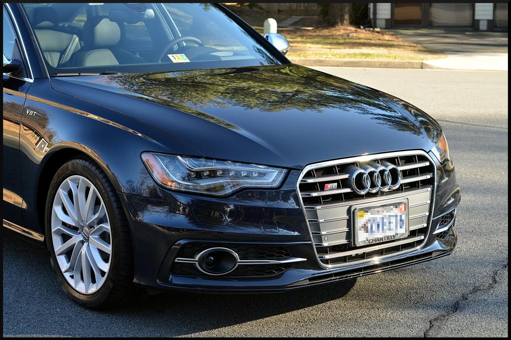

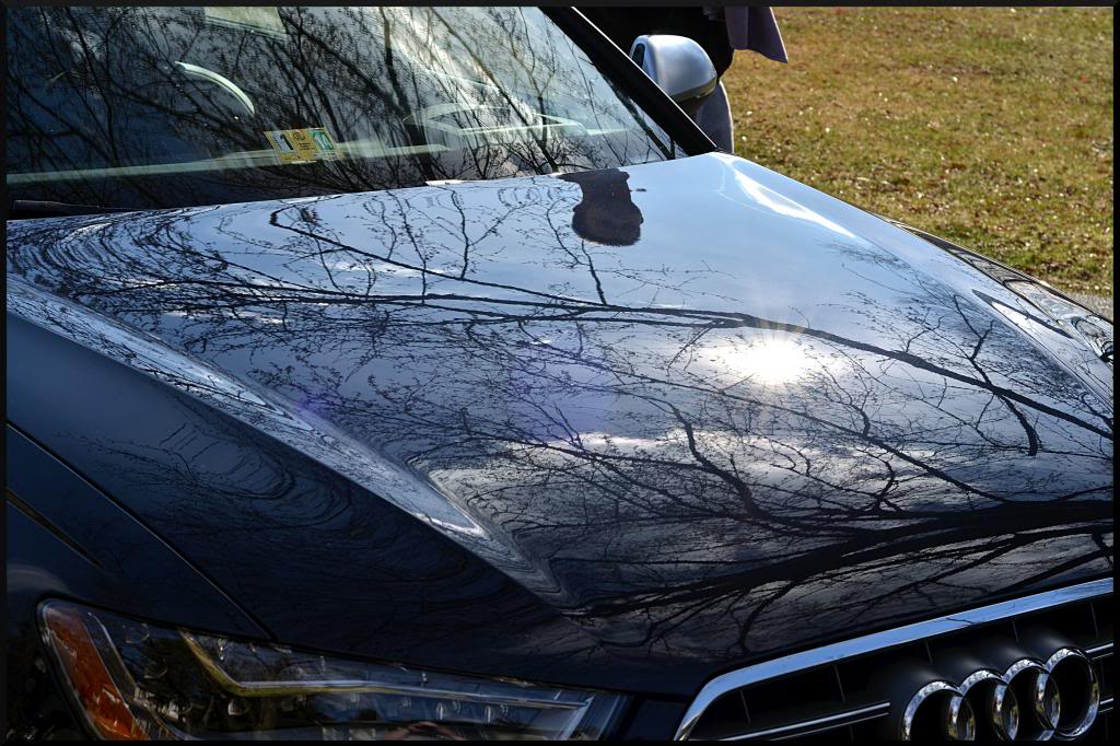

To finish the detail off we cleaned the glass inside and out, polished and sealed the exhaust tips, and did a quick interior detail. Here is how the car turned out.

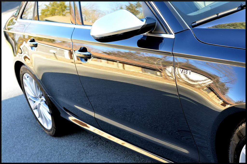

As you can see in the last set of pictures, the paint goes from a light slate blue, to a deep blue, and then almost black. We loved working on this vehicle and are very happy with the results, as was the customer. Thanks for taking the time to check out our write up, and we look forward to your feedback!
