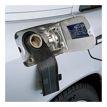

Here's another great item I use. It goes over the filler and protects the body etc when refueling.
You can see it at: http://www.griotsgarage.com/product/...s/fuelguard.do

The 355's have a rubber bib like that from the factory. We were jipped!

Thanks for the Griots link. Overall it is a pretty good set up on the 360 and the nozzle does not lean on the car. A good item anyway, especially on a Porsche.
