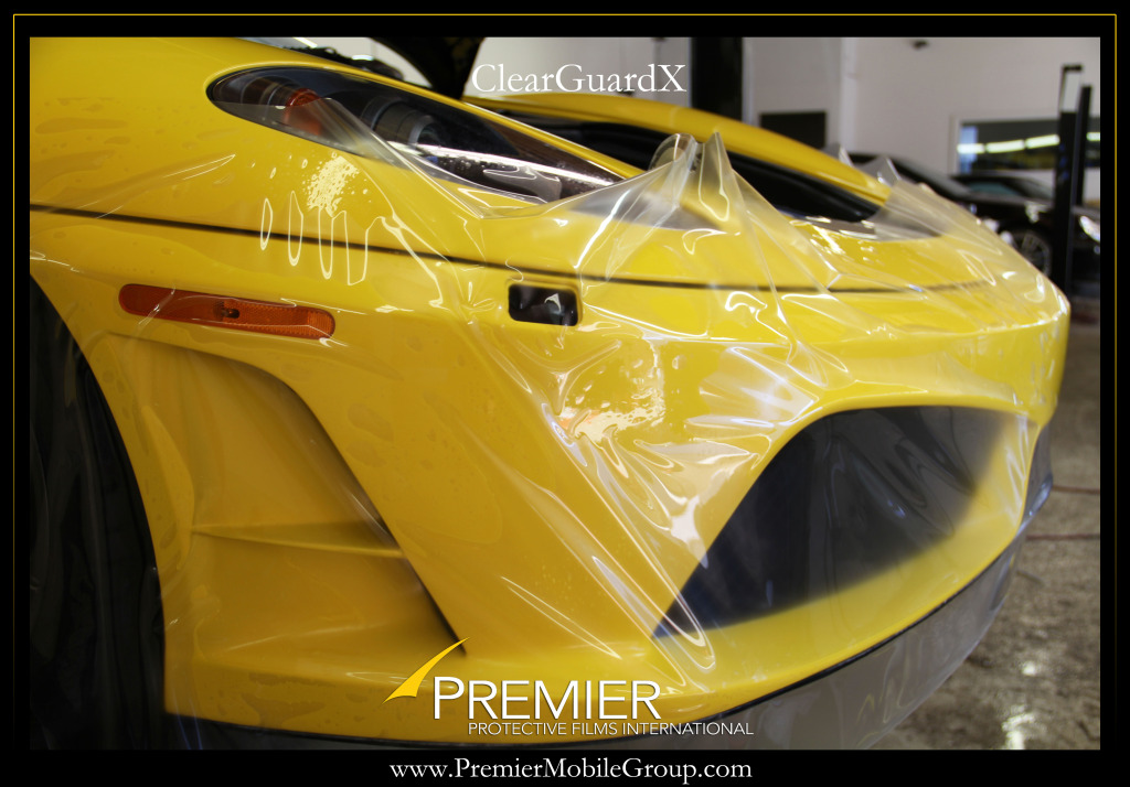

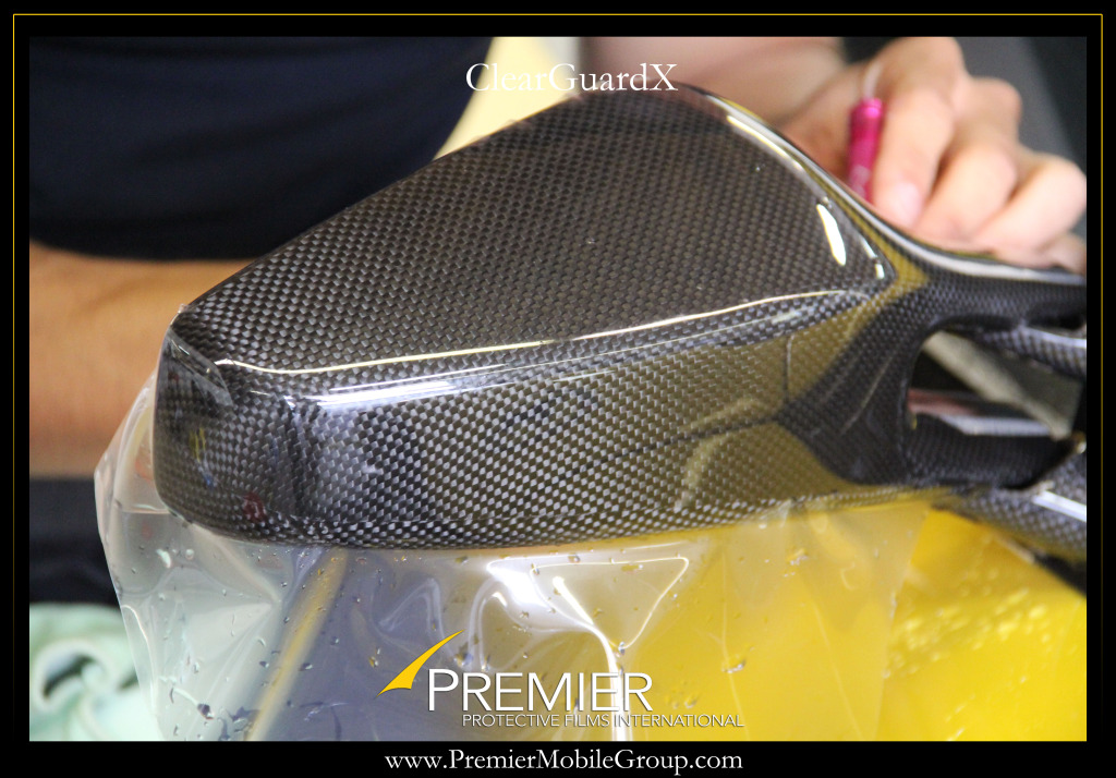

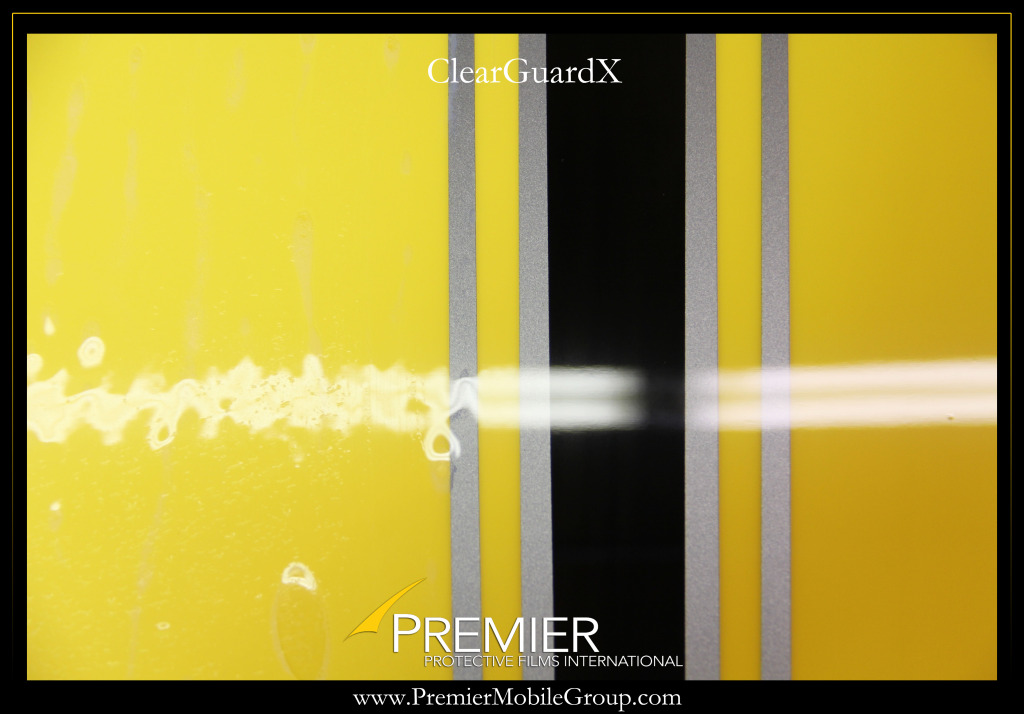

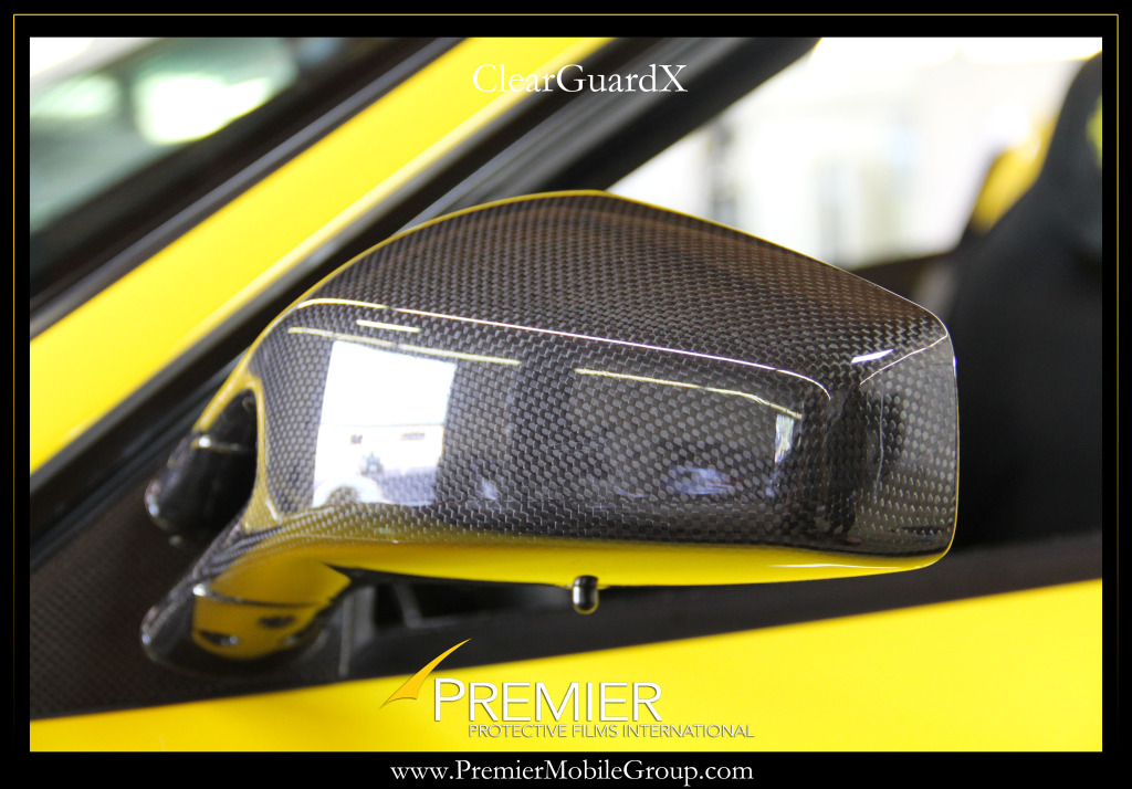

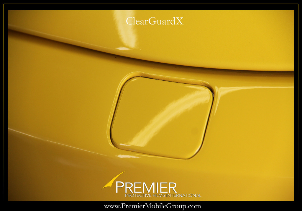

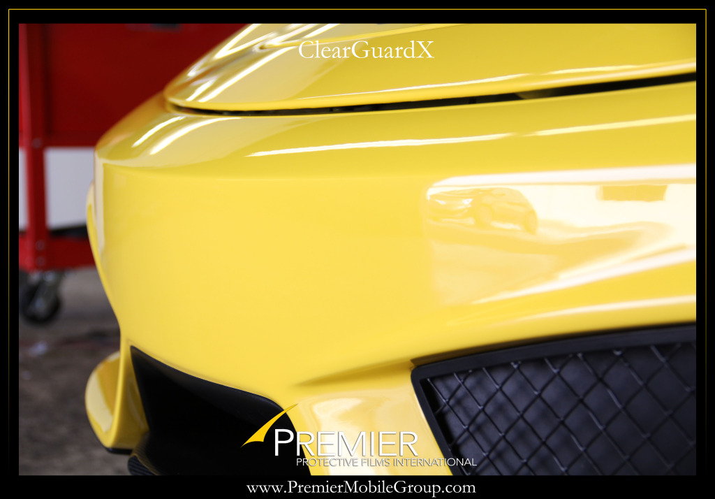

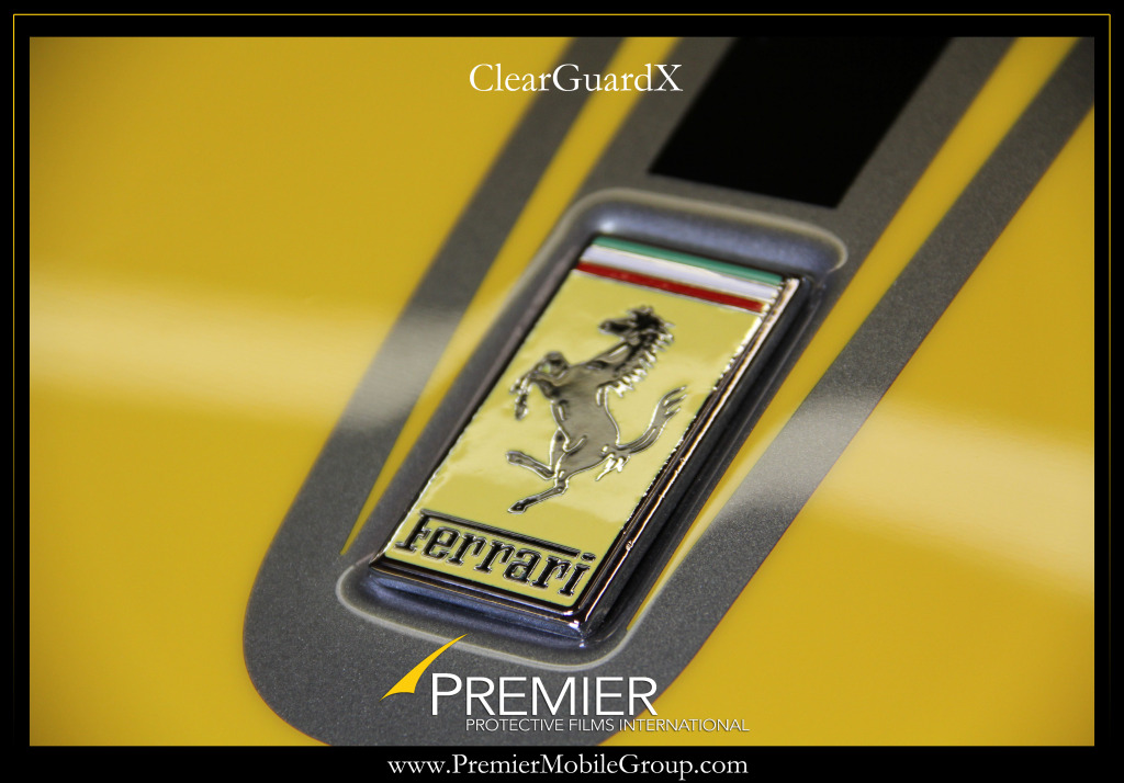

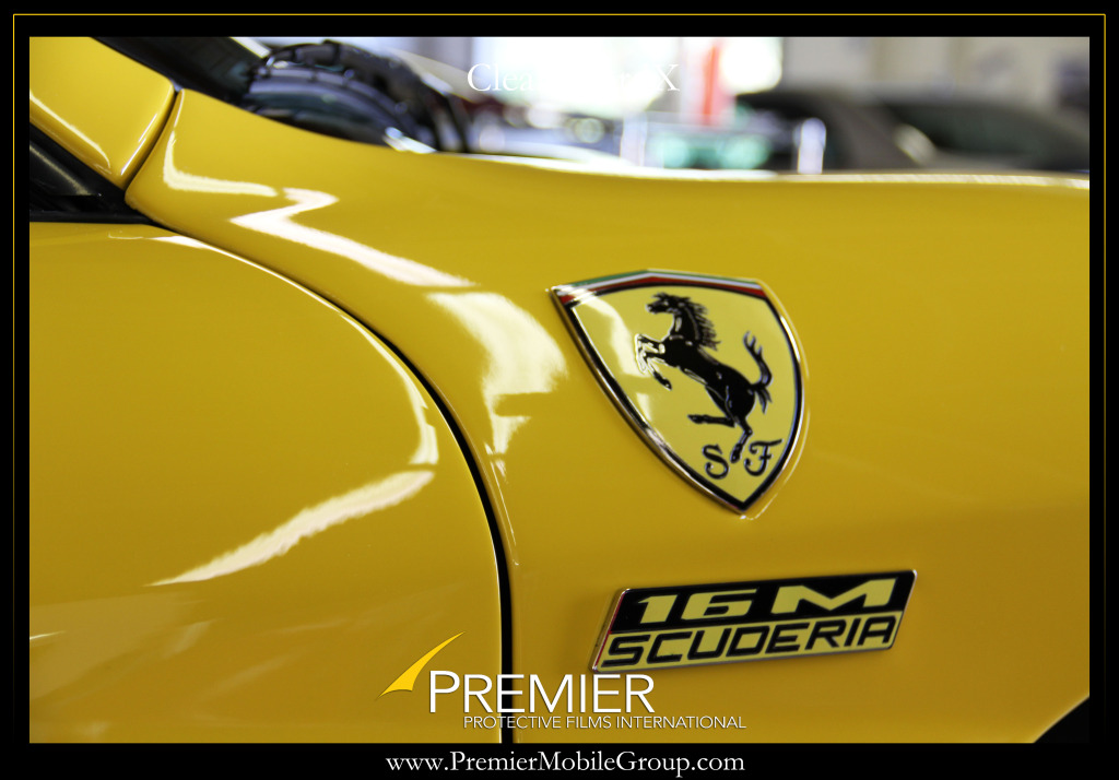

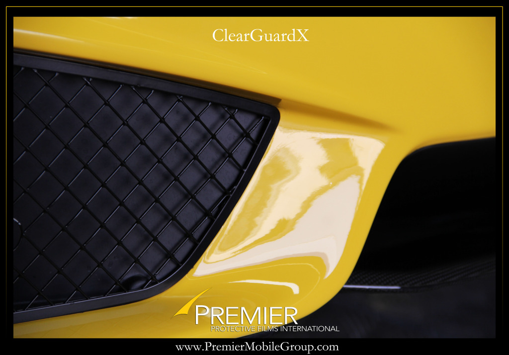

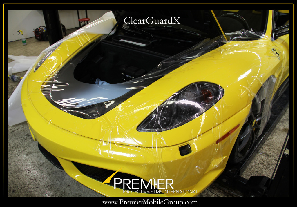

The following can be done for the 16M or Scuderia, but will depend on the installer's skill level:
1. full hood - 1 piece
2. full front fenders - 1 piece (most installers only do the partial fenders and with some of the better ones, they will do the entire front fenders in two pieces with a joining seam under the Ferrari emblem)
3. front bumper - 1 piece (the precut firms will also do this in 2-3 pieces)
Below are some samples of how it can be done (**Note: within any craft oriented industry, skill and experience is the key. Just because a company claims work to be "custom" does not mean they are all equal)
