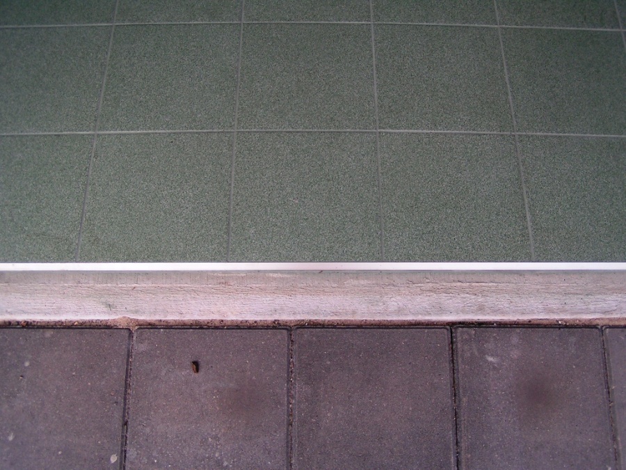

did you lay the tile to extend past the garage door ? pics ? how does the tile lay against your driveway ? is it level ?

Henryr - Most tile manufacturers will have specialty tile, such as bullnose that will provide a nice transition from your driveway into the garage. You can also have a profile machined in the event a bullnose is not available.
Another idea is to install a threshold, just like is done on entryway doors to homes, to provide a nice transition from the driveway into the garage.

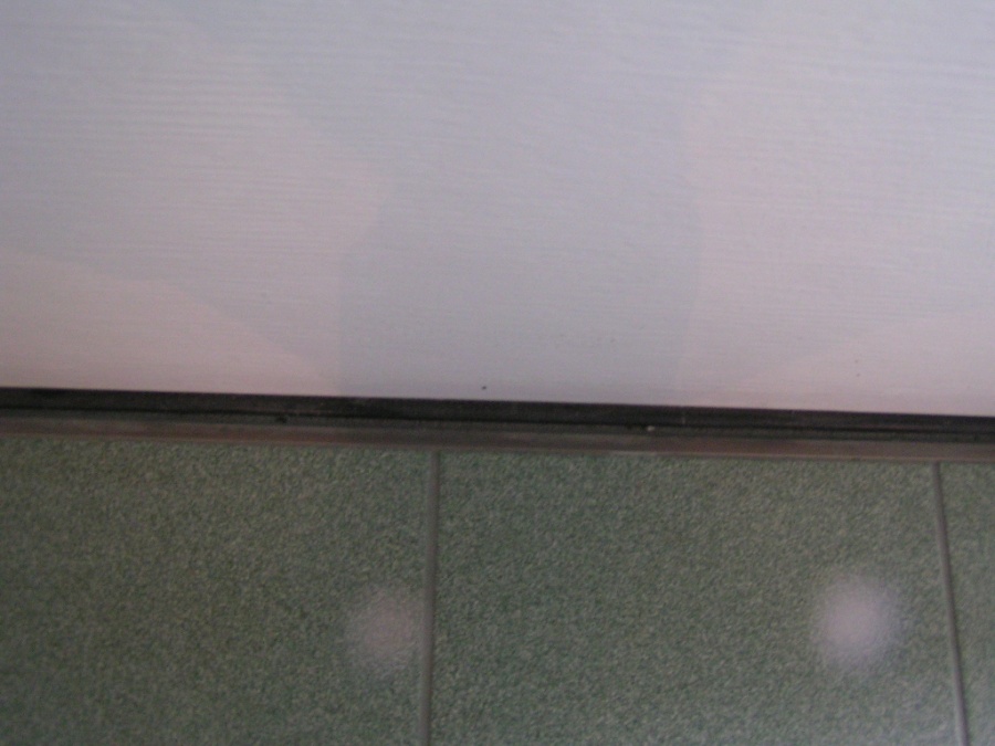

Here are two closeup pics showing the garage floor...
The first is showing the finish with a bull nose of sorts at the end of the tile laying to the concrete.
The second shows the garage door down nearly butting up against the bullnose.
It was suggested that I could tile out to the end of the concrete floor to the driveway tiles and have the tile travel under the garage door. This would have resulted in having the tile exposed to the winter elements...the tile manufacturer said it would be fine but I decided why chance it...
The entire floor is slanted towards the doors for drainage....I'd guess about 4" from the back of the garage.
