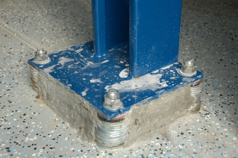

@alcav - thanks. I paid someone to do it. Having watched two guys put it up - I think it's doable as a DIY with a helper. Biggest issue is loading it at the freight terminal onto a trailer. Spacers are steel washers - left side needed almost 3" worth, right side 2.5" worth. Garage slopes down towards the door for drainage.
Hi,
I just have garage door track raised & installed liftmaster 3800 opener. And now I'm ready to put up a lift.
I have same situation on my floor. You said you put steel washers but did you put something under the base plate? Like some plywood or a block of wood?
Looks like there is something under the base plate.....Or close up picture would be great.
Also, anchor is must or an option?
locus - here are close ups of the two legs that needed washers. THere is no plywood or wood under the baseplate. Just measure the amount you need to build up (laser level helpful for that), create a stack of washers, use a floor jack to lift up that side of the lift, slide washers under. Use traditional level to check for evenness, and shim with rubber washers if needed, pass bolt through, hammer in and then tighten. The installers packed some ready-mix concrete around the gap, between the washers - which I need to paint to match my floor.
Anchoring is not a must, in fact I'm told most people put the optional caster wheels on the lift to allow it to be moved about, and in that case I'm told an uneven floor is not the end of the world.
I didn't need to move the lift, and wanted the security of knowing it wouldn't develop a rocking motion when I was working under the car/lift (plus it saved a bit - caster kit was $262) http://www.bendpak.com/car-lifts/acc...aster-kit.aspx

NikosF, thank you so much for detail information.
Now I know what to do next

The typical solution for installing column base plates is to use a high strength non shrink gout under the base plates.
After the base plate is leveled a mix is prepared and either poured in (retained by a damn around the BP) or a stiffer mix is troweled in place. With the trowel method you must make certain that there are no grout voids.
The grout base ensures uniform bearing over an uneven concrete footing. The non shrink part keeps the cementitious grout from shrinking after installation, and the high strength part is obvious.
SIKA products are generally used for this application and you can research for the correct SIKA product on their web site. There are many other HSNS grout mfgs, Burke is another that comes to mind. Read the directions carefully.
Personally I am not too sanguine about installing loaded columns, subject to lateral forces, on a slab without a footing below. I know that the lift mfg's approve of this but it isn't good practice. And for those who live in earthquake country a medium shake is going to result in either the anchor bolts pulling out or the thin slab or the slab breaking under the bending stresses. If this were to happen the columns would fall to the floor.
The loads from the weight of a car are two small. Considering most concrete has a compressive strength of 2500psi, spreading 4000-7000 pounds over apprximately 144 sq inches is nothing. Footings required for vertical lateral loads are generally much much higher than that.
