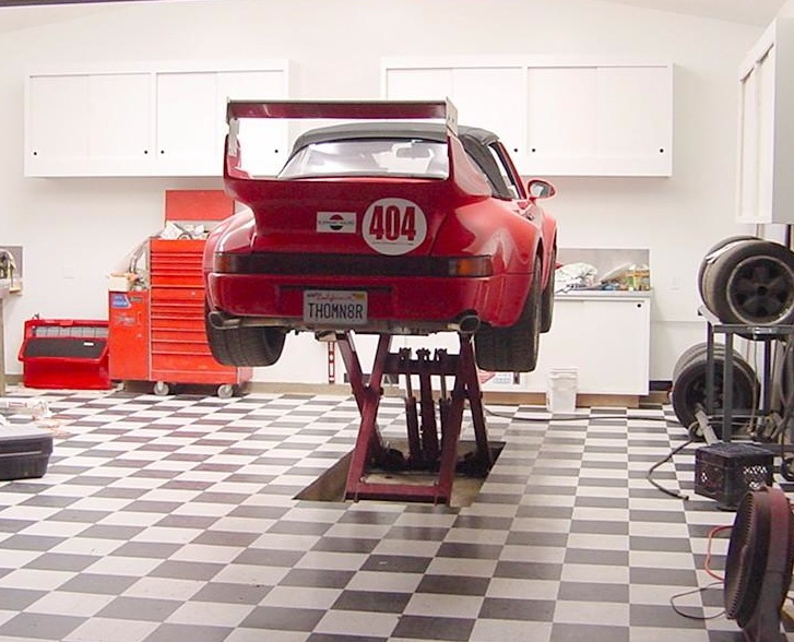

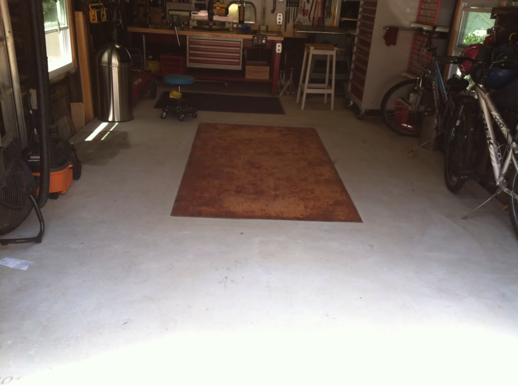

Any scissors lift can be put underground for (I would assume) a fraction of the cost of those kind of deep-hydraulic-cylinder lifts. The key benefit of a submerged lift is that you're squeezing past or tripping over the thing for the 99% of the time when you are NOT servicing a car on it.
This isn't my lift, but I think it's a really smart solution for a small garage.
Most of the time -- nothing to trip over:
Then:
And if you want to go even higher, I've seen this Mohawk:
My own lift is odd -- it's primarily used for my 911. It's perfect for that, and was super inexpensive ($455, second-hand). But it's not what I'd suggest for most guys.

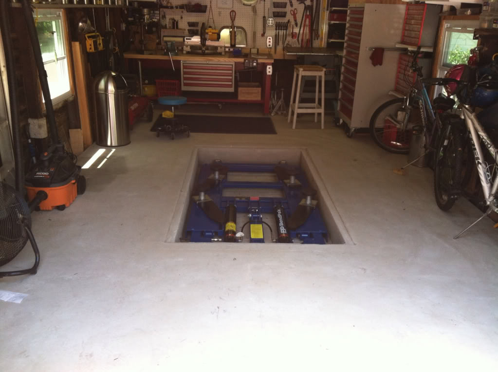

Then:
And if the shaky gif isn't enough for you, here's a video of the lift in action. Cue the orchestra:

The one thing I don't quite get is the idea that a scissors lift is more vulnerable to corrosion than other types of lifts. I would be much more worried about the steel (and seal) along the vertical hydraulic mechanisms of these pillar-type lifts, since that's not only a structural part of the lift, but also a sensitive part of the lifting mechanism.
With my particular lift, the hydraulic pistons are always up above the concrete and also shielded by the top. I can't see how I could get salt/slush/etc on the cylinder surface if I tried.
