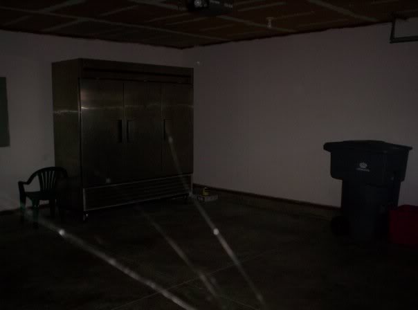

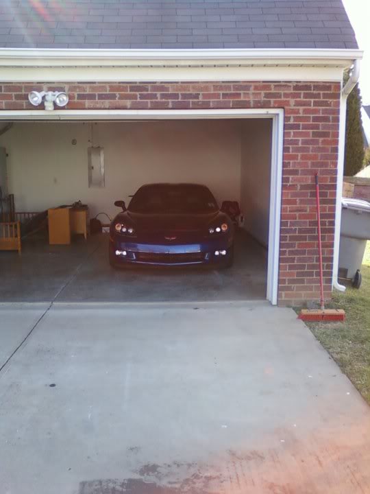

I've been lurking here for awhile - and finally have some time to make a thread here.
I've got a 2 car garage that is attached to my house that really wasn't much more then a dark and dreary spot that previous owners did not keep there cars in.
I bought my house 3+ years ago now - and this thread is about the upgrades that I have done.
Here is a pic showing just how dark it was in there:
After moving in:

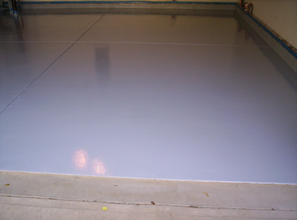

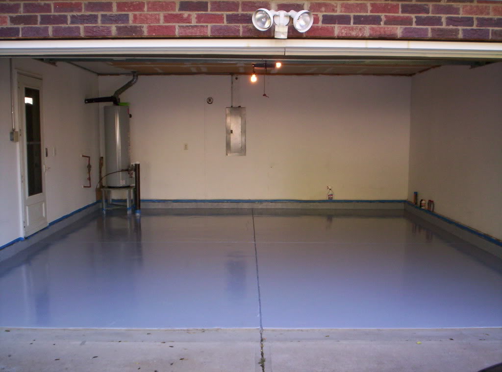

One of the first things that I did was before I moved all my stuff to the house - I epoxy coated the floor with Griots Garage "No Lift" Epoxy.
The epoxy project took the better part of 3 or 4 nights after work - it wasnt too bad - cleaning off the floor and using the muriatic acid was the worst part.
I'll be adding more to this thread as I have time - so stay tuned for more updates.

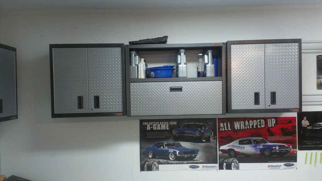

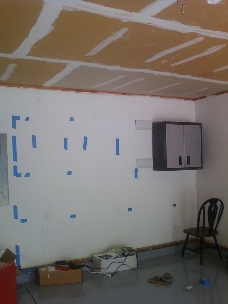

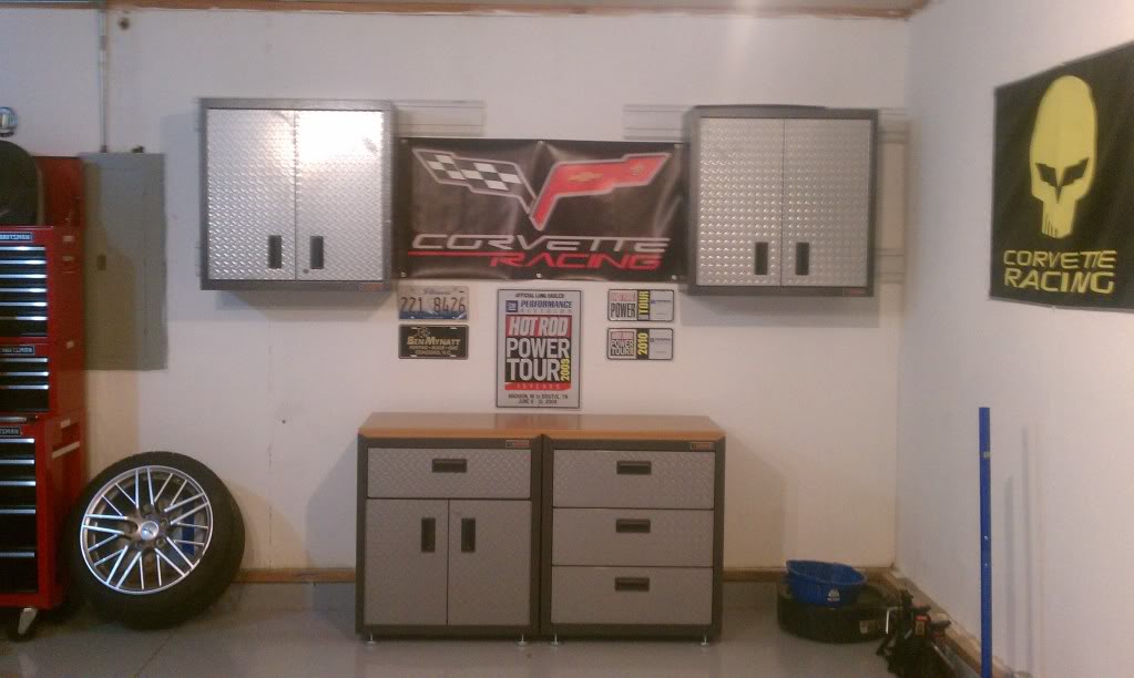

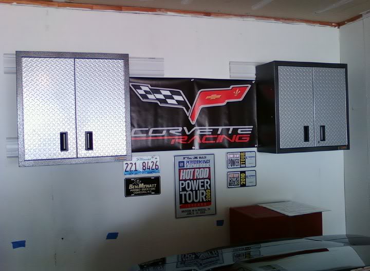

The second garage project was adding some shelving for all the the car parts and garbage that I have collected over the years - got to love the fancy painters tape to measure off and setup my layout.
I got these Gladiator Garage works units from Sears on Black Friday - they where $90 each on sale.

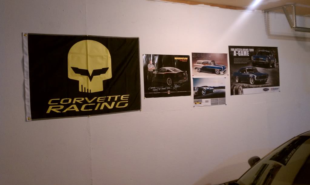

Starting to decorate the wall's a bit:

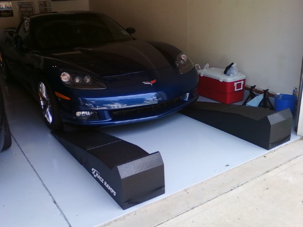

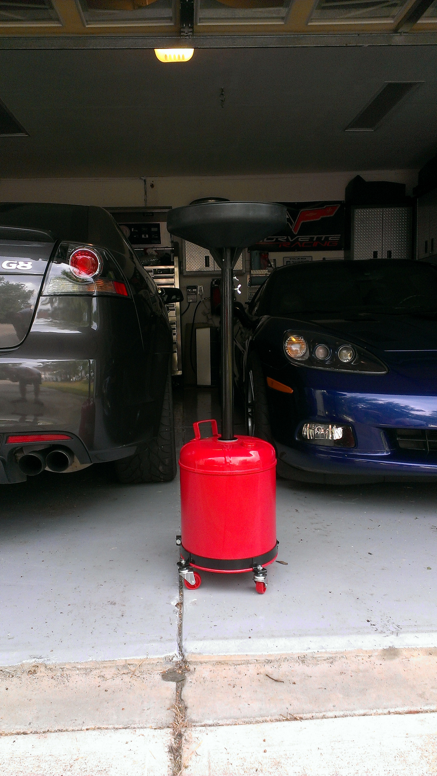

After owning the C6 for a few years - and realizing it sucks to change the oil using jack stands - I picked up some Race Ramps online for like 280+ shipping to the house:

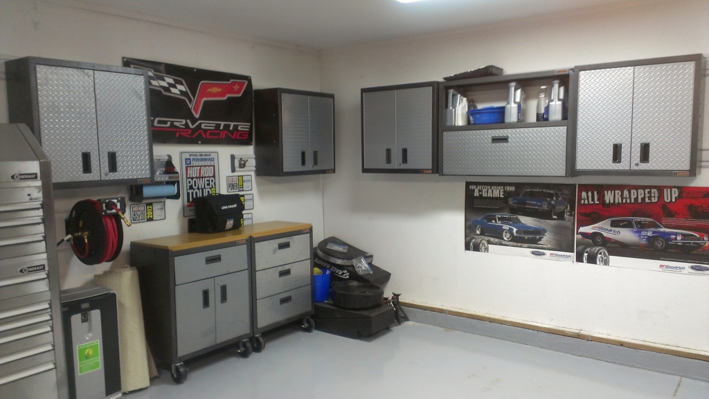

Of course I had to put some of the other junk that I had been collecting on the other wall:
Then i decided I needed more room for tools/parts and a work space - so I bought these assemble yourself Gladiator Garageworks floor cabinents.
I got one from Lowes - and the other from Sears. The one from Lowe's - not sure on the price but they did price match the unit to a price I found on the internet - and they beat the price on the composite top that mounts the 2 units together.
I think the whole unit was probably $300-$400 all together - far better then prices I saw online for these.
Also just realized my first Craftsman toolbox is in this pic - that was another Black Friday special - I think it was $200 for the whole set.

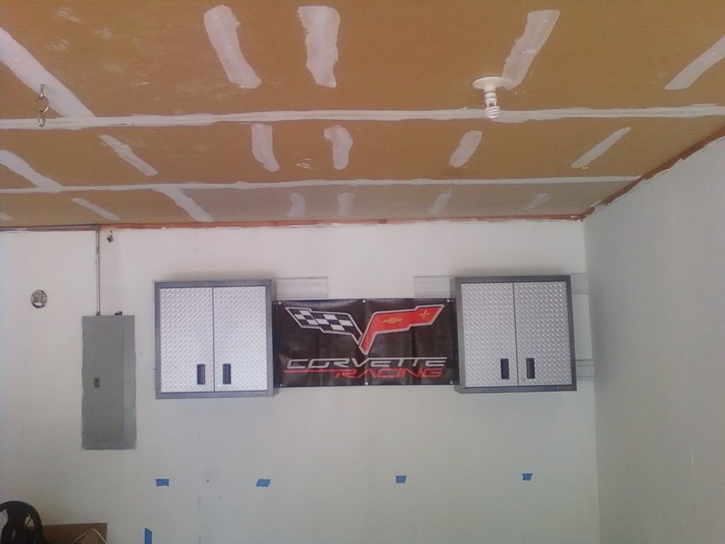

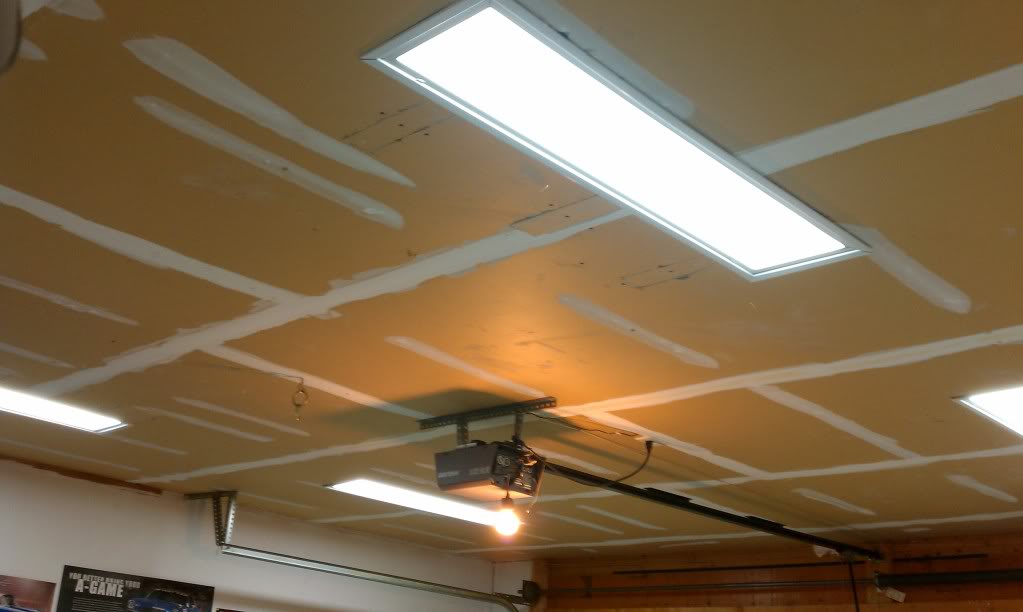

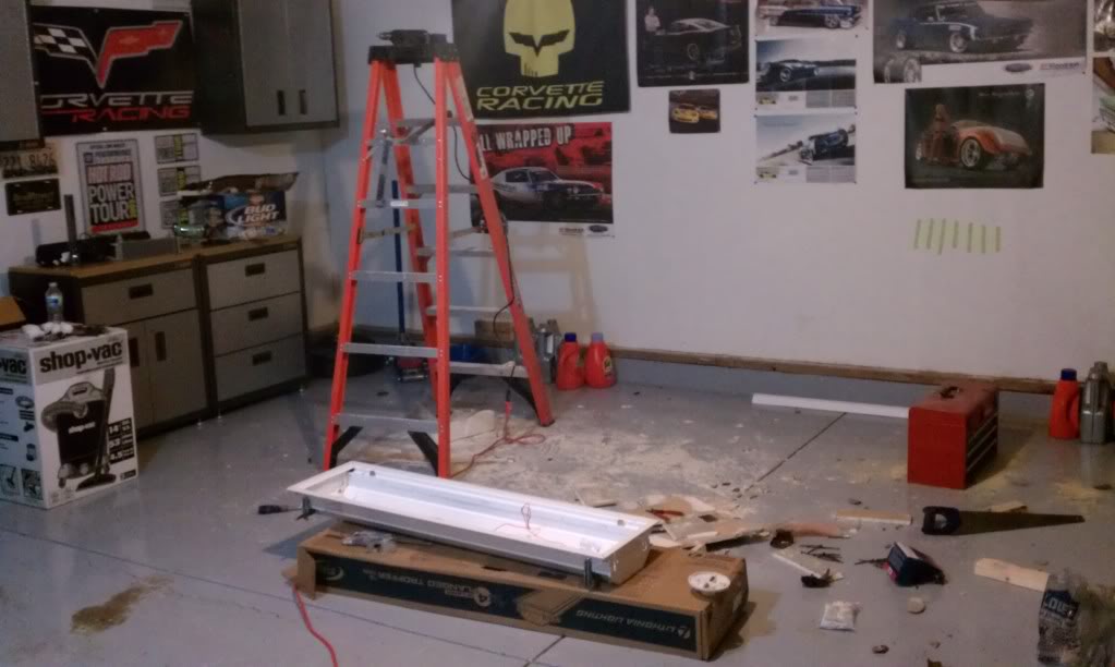

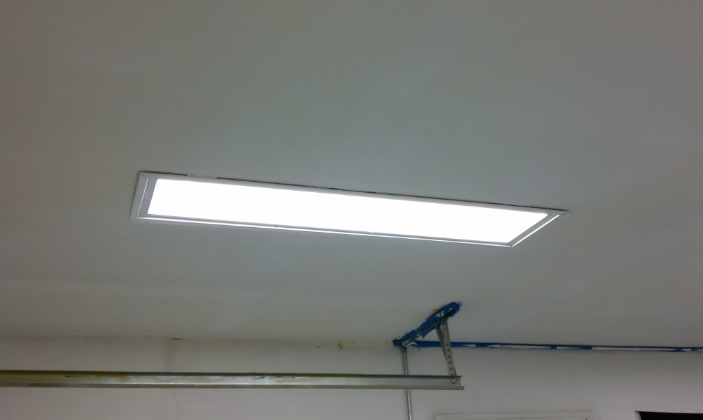

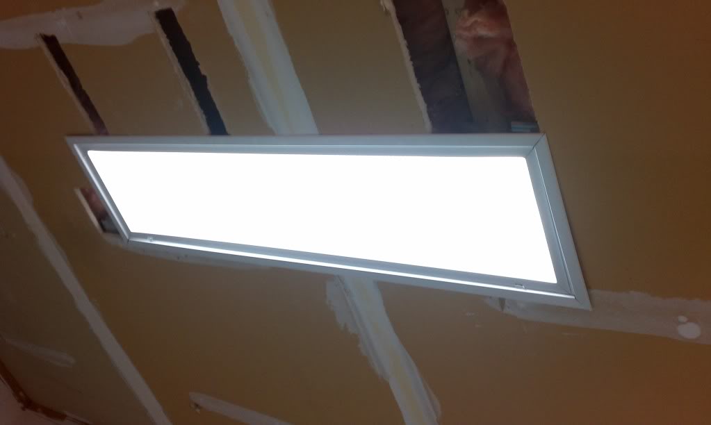

Finally - big project time - time to bust out the power tools and summon my inner Tim Taylor skills.

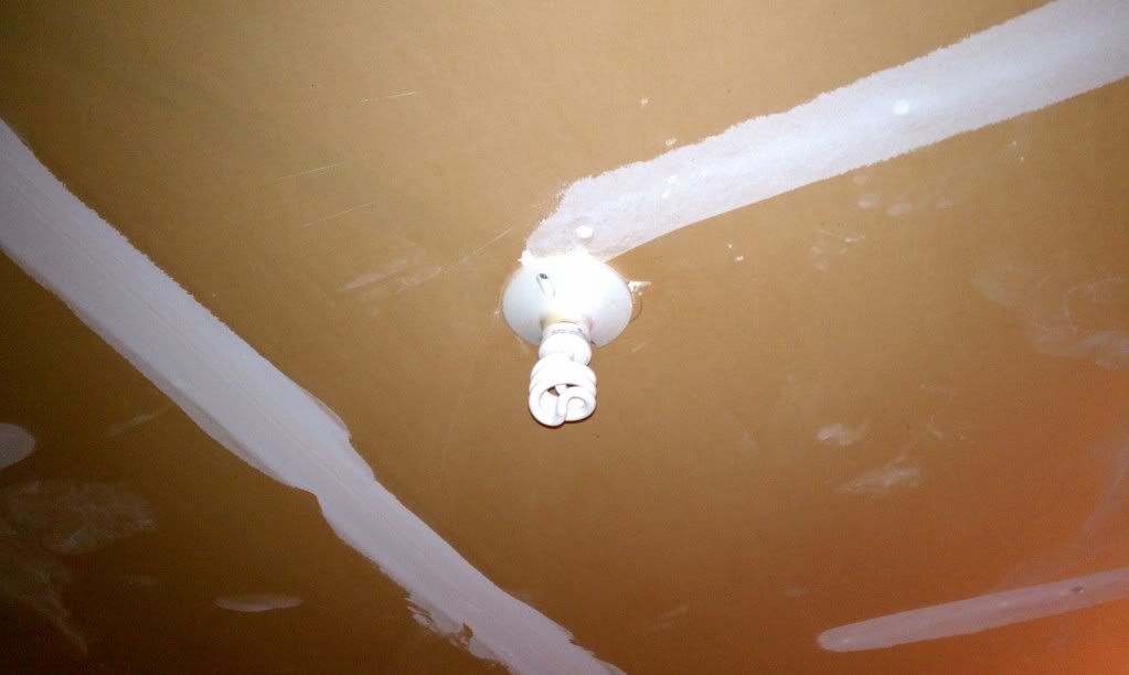

Like I mentioned in the first post - my garage was always dark and dreary - not a place to go work on your car/hangout at all.
Here is the one of two lights that was in my garage from the day it was built - you literally couldn't see a damn thing in there.

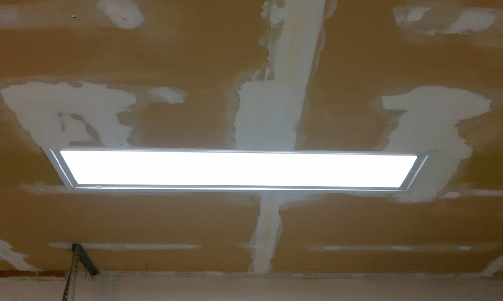

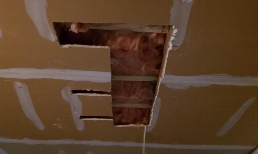

So I bought 4 - recessed twin T8 housings @ Home Depot - after sitting around in the garage for a year - i finally starting planning and cutting holes in the ceiling. The housings where something like $50 each.
I had originally planned on using the legs that swing out from the housings and attach those to the studs in the ceiling - but they are ~24" apart and no way in hell that would have worked.
So I ended up cutting some 2x4 into ~24" lengths in 3 sections - and tied them into the ceiling studs with screws at a 45* angle or so.
I then took the housings apart - removed the cover in the middle and used the mounting holes in the housing to tie into the studs that I had put in.
I had carefully cut the ceiling apart - so I put in the sections that I had to cut apart back together - taped, mudded and started sanding.
The biggest pain in the *** part of the project was the drywall part - if I never have to tape/mud/sand again - I'd be glad to not to.

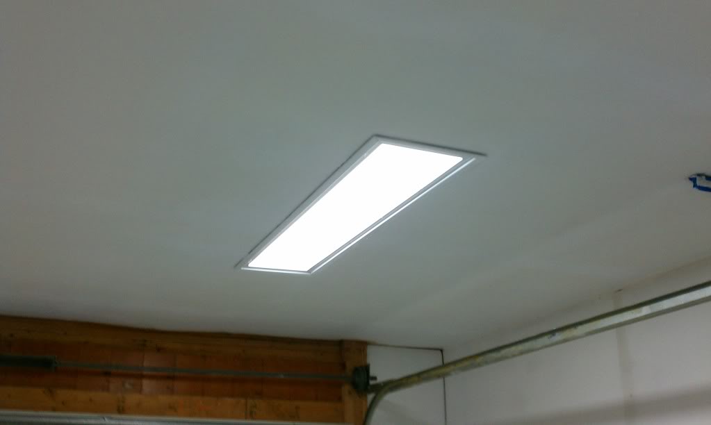

Now - with the new lights on - you can actually see what you are working on!

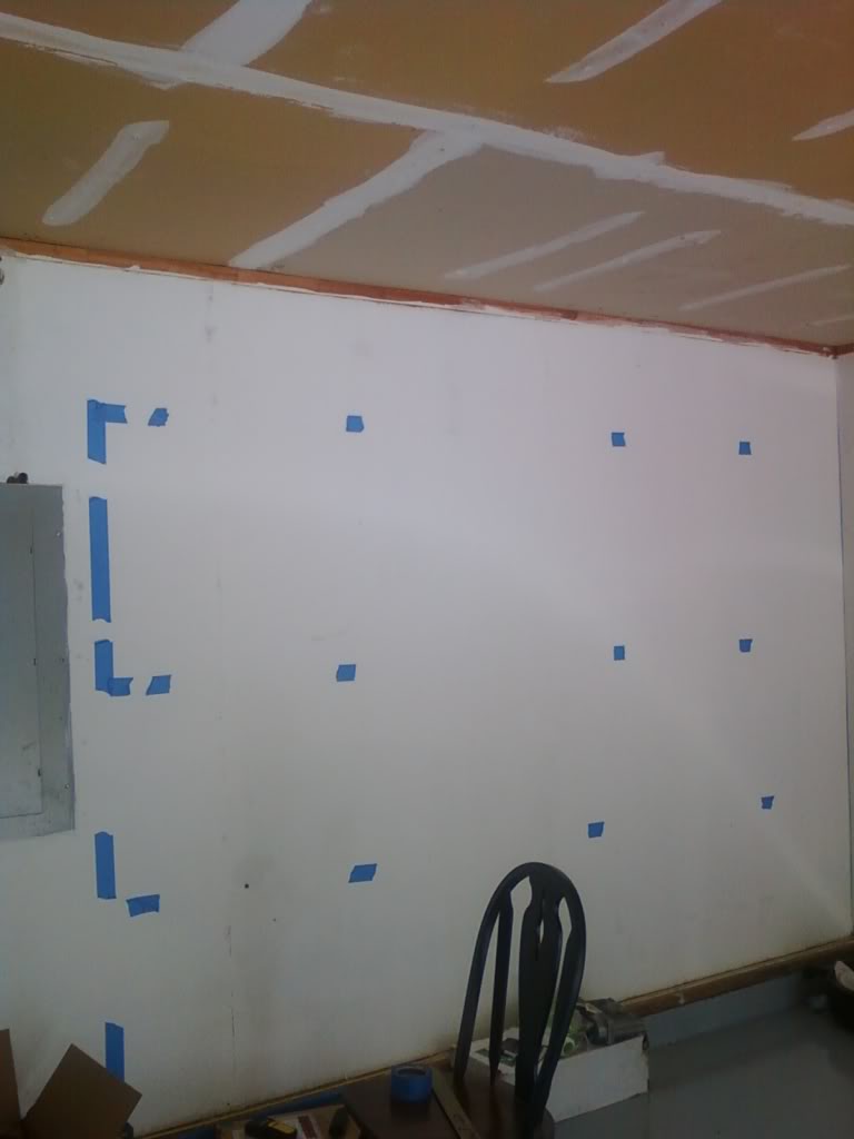

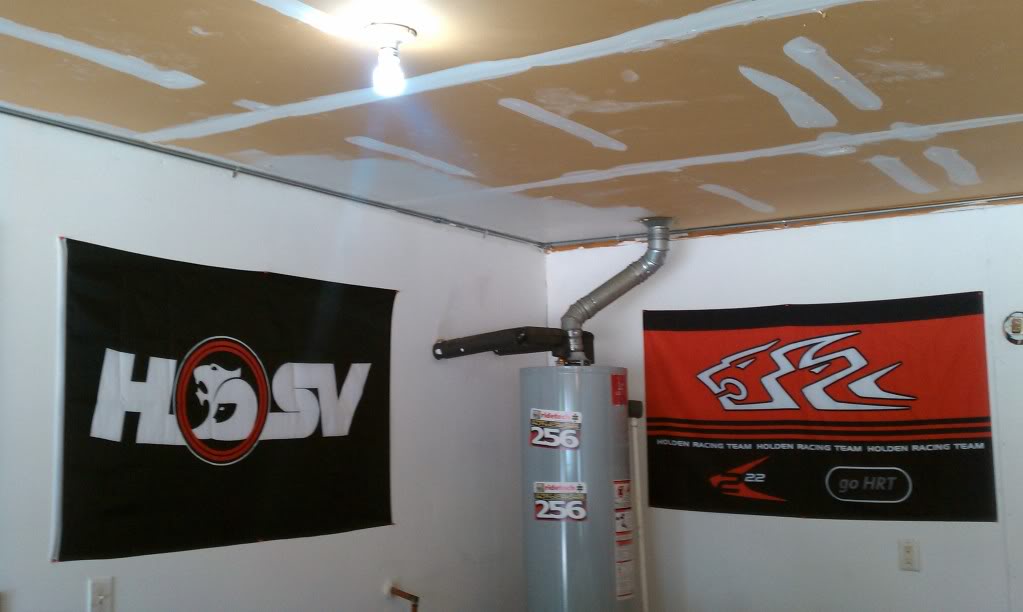

So after I finished up installing the lights - I decided to retape and mud all of the seams on the ceiling.
The builders did a terrible job when the taped off the seams - some spots didnt even had mud on it.
After a couple days of mudding/sanding - I bought a 5 gallon bucket of white primer and used that to paint the ceiling 3 coats later - the ceiling was done.

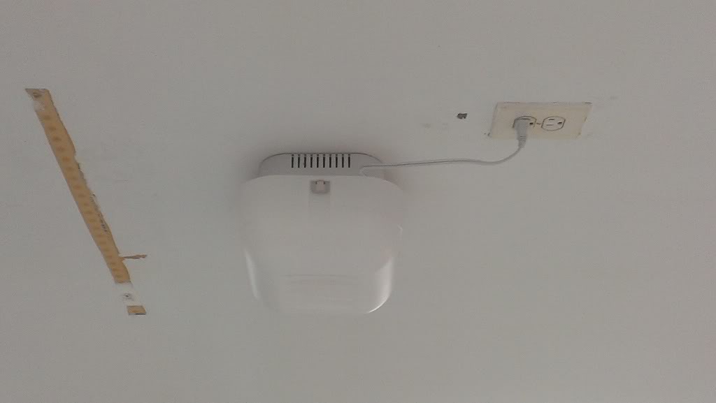

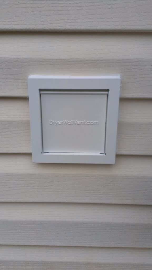

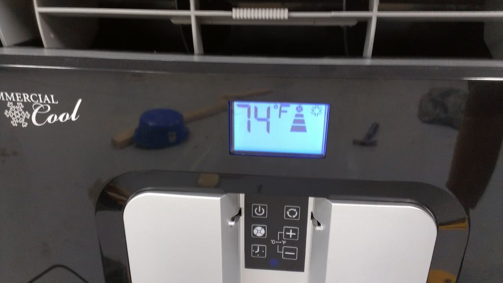

I found a portable AC unit on clearance from Newegg.com - they had these going for $200 shipped.

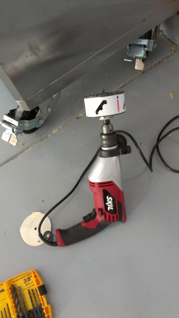

Now this style unit requires an exhaust vent to go outside - and since I did not have a door to run a vent tube through - I picked up a dryer vent off the web since it was all metal construction. After some careful measuring I cut a hole through the wall with a 4" holesaw.
The unit is rated for 14k BTU - which should be good for the space but I can't say it works all that great. It cools the garage a bit - but the most that I have noticed is that it pulls the humidity out of the air - and down here in the south that is really helps out a lot.

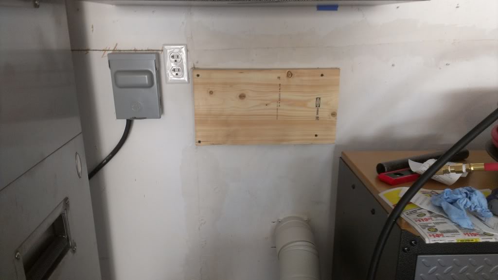

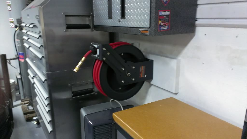

The air compressor sat around for awhile before I decided to finally hook it up. We had to run 220 wiring for the compressor - and I needed to decided what I wanted to do with the the air hose real.
I picked up a 50' 3/8" line from Harbor Freight for like 60 bucks.
Many trips to Lowes/HF later - I got all the fittings straitened out and got the air hose reel working.
I cut a 8' section of 2x11 and screwed that into the studs.
I then took 1/2" anchor screws and screwed those and the hose reel into the 2x11.
I later picked up a retractable power cable - and mounted that on the 2x11 next to the air hose reel.
After I got the compressor and the bigger tool box - I of course started picking up more tools - and that of course means you need more storage.
So another Black Friday came by - and I bought 2 more of the Gladiator GarageWorks 30" cabinets at Sears., the tracks for them, and I bought one of there pull out worktop stations as well.
I got the work station at Lowe's and saved some money by finding one of those 10% off moving coupons - and printed off a better deal on the web that they price matched.

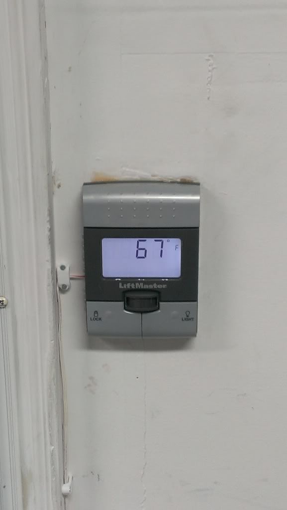

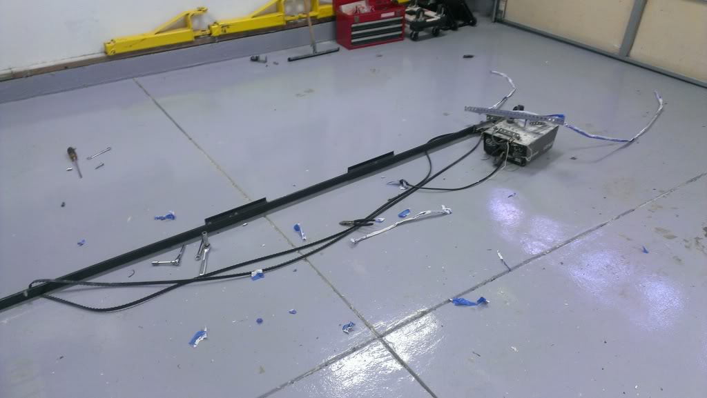

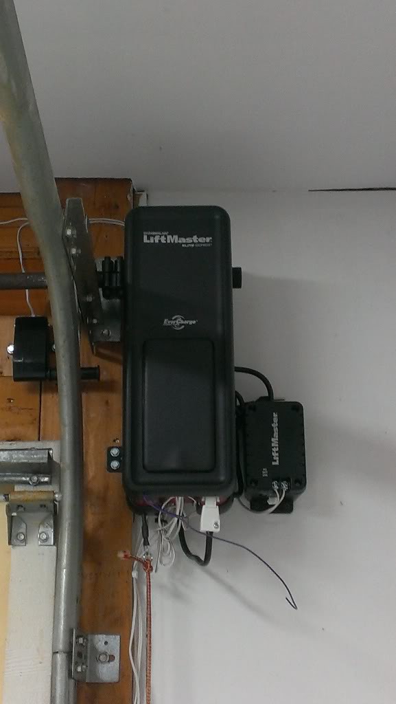

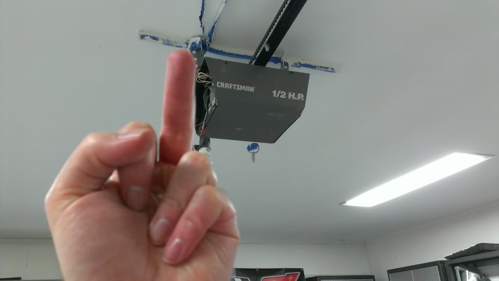

At this point - I thought I was done with getting stuff for the garage - well I was leaving for work one morning and I closed the garage door - and I noticed that the door wasn't closing.
So I went back inside - tried the button from the wall - still didn't work - I'm like WTF...
So I pull the emergency release cable for the door - and closed it and looked up and noticed that the spring had snapped in half!
So I called a local garage door service company - and 2 new springs later the door was fixed up... or so I thought.
I don't know if it was the fact that I went from 1 spring to 2 springs on the bar above the door - but the opener crapped out no less then 2 weeks later.
The crappy Craftsman unit was original to the house so it was 12 years or so.
I pulled the opener apart and found that the plastic gear inside of it crapped out.
I called around - everyone wanted to replace the unit as whole since it was so old.
I did find a few companies online that sold the gear set for like $60 or so plus shipping.
So at that price - I wasn't sure if I would fix up the old unit for the motor just to crap out - or just replace the whole unit.
I called around for estimates on getting a side jack opener from Liftmaster - I got quotes from $1200 - $1500 installed. I was shocked by how much they wanted for that!
So I started to scour the internet - looked on Ebay/Amazon/etc - and found someone on Amazon had it for $275 shipped to the door.
Now mind you - I have never setup or installed a garage door opener before so I was pretty nervous about ordering it online. After reading the install instructions from Liftmaster - and watching a few videos on Youtube - I pulled the trigger and ordered the Liftmaster sidejack unit.
I ended up ordering it from Amazon and got it a few days later.
The install went pretty smoothly - I read the instructions a few times - and had no real problems.
Putting the opener itself on the end of the bar above the door really takes a second pair of hands to help steady it.
The install took most of a Saturday - running all the wiring for the sensors and what not is pretty tedious and time consuming.
But for less then 300 bucks - and lot less then then $1200+ quote - I replaced the garage door opener and have had no problems with it since.
This unit came with a remote light that turns on when you open the door - or the button on the wall sees you with the infrared sensor. Also the button the wall has a clock and thermometer on it.
A few weeks after the install - I decided to remove the old opener - and fix the ceiling where the old one was mounted to it.

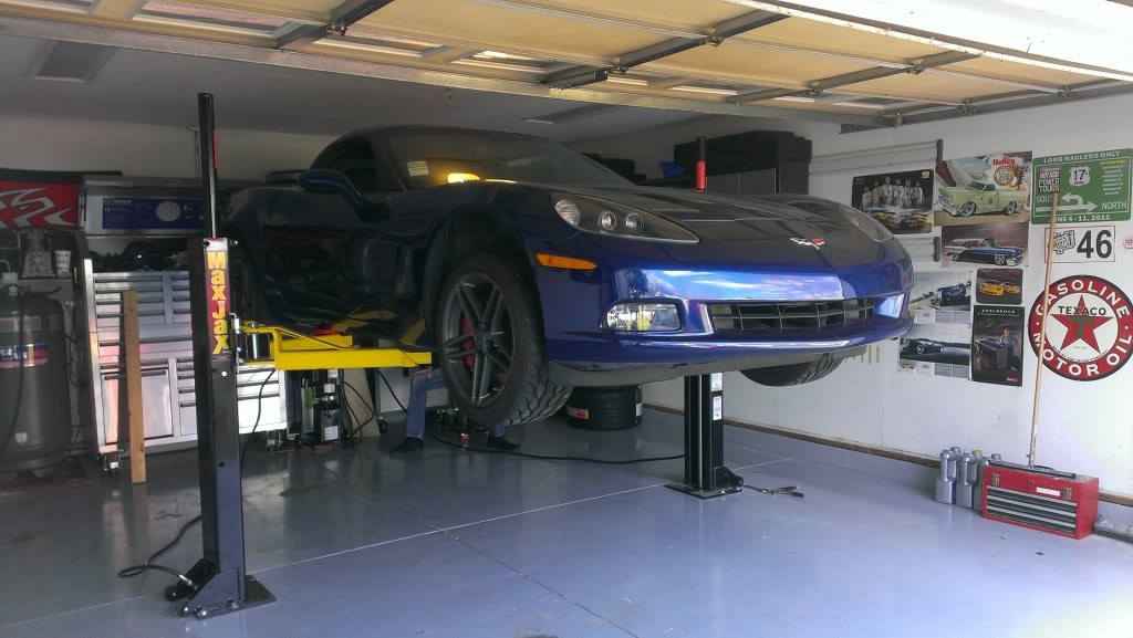

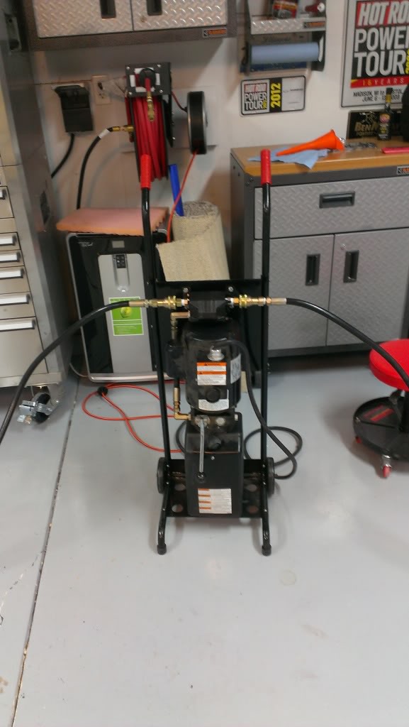

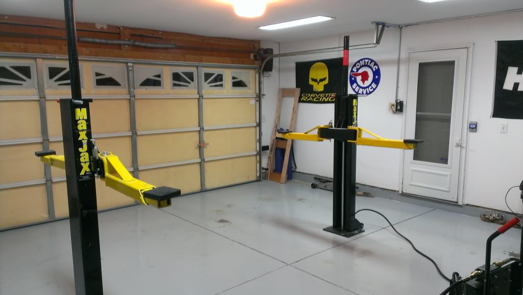

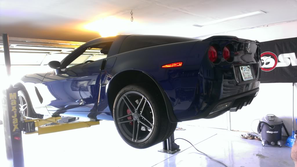

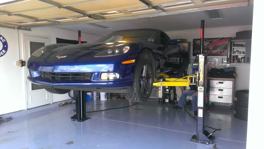

Some of you may wonder why I went with the sidejack opener vs a traditional opener - and some of you with keen eye's may have seen the yellow arms in the pic above.
Through a friend of a friend I caught word that someone was selling a Danmar MaxJax portable 2 post lift.
So after a few email's back and forth - I got more information about the lift and its condition.
A deal was made - and after borrowing a truck from a friend - we drove up to Greensboro to pick up the lift.
The lift was brand new and never installed - the guy had it sitting in his garage for over a year and never once used it.
So for $1200 bucks + the 70 bucks in gas to go back and forth in the pickup we had - I had the lift in my garage.
I only have an 8.5' ceiling in my garage - so I have limited height in the type of lift that I could use. A 4 post wont fit and most 2 post lifts are 10' in height or taller.
Plus this portable lift can be disassembled in 30 mins - pushed to the side and I can use my 2 car garage for what its mean for - storing 2 cars!

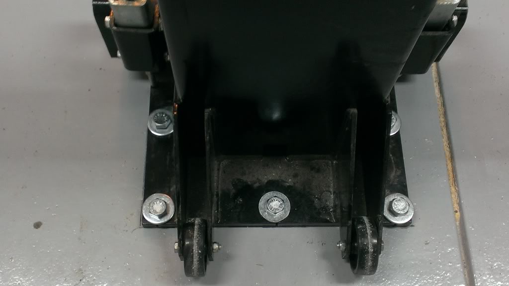

So I bought a hammering drill - read the instructions/referred to Youtube videos - and starting drilling!
4 hours later - praying that my concrete pad was thick enough - I got all 14 holes drilled.
My concrete pad ended up being 6+" deep - and the install kit calls for mininum thickness of 4.5" or so.
I then assembled the lift - poured in the 14 quarts of ATF fluid - and bled the hydraulic rams.
I've used the lift to change oil, install swaybars on Vette - and did a big brake upgrade on my G8 with it.
I am very happy with it and I am glad I can get off my back laying under a car!
I can sit under the car with my rolling stool and work above me.

One thing. I would think the 14k BTU air unit would work well in that space.
I have seen similar units work well in larger spaces.

Todd - to be honest I haven't run that AC unit for much longer then an hour or 2 before I go out to the garage to start working on the car - it has to work pretty hard to pull the temp from 80+ degrees in the garage into the 70's. I have found that I need to elevate the 2 front wheels for the unit to work properly and get rid of the water condensation that builds up and causes the unit to shut off.
I also have not insulated my door - as its pretty beat up and not sure for the few times a year I use it - it would be worth the expense of doing so.
Also - as I mentioned above I was looking for an oil catch can - I picked up this unit for 50 bucks @ Harbor Freight - pretty cheap - but I know what I paid for - the construction honestly isn't all that great - but I will have no problems cutting this thing down since my lift only goes up to 44" or so in height and the lowest setting of this thing is around 38" - I will adapt it to fit my needs.
This is only my second time uploading pic's to Flickr - let me know if you think its too big. I am on dual 24" monitors at home so its not all that huge for me. I used to use Photobucket - but after 5 years of taking pics - I hit their storage limit - and I refuse to pay those morons for cropped pics and degraded resolution.
The one thing i will say about PB is that there sharing is super simple - flickr - not so much - but I work in technology so its no big deal for me to figure it out.
Thanks.
