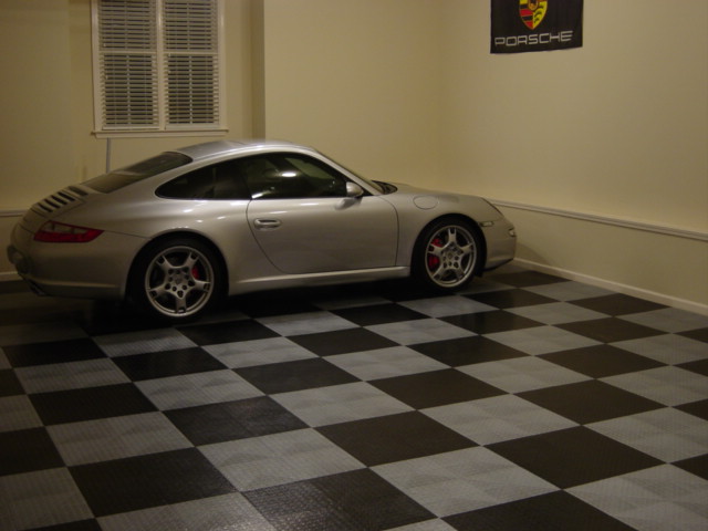

overstock.com tiles
Old Jun 14, 2006 | 08:08 AM
  #59
Mussel Kar's Avatar
Joined: Oct 2005
Posts: 592
Rep Power: 46
Mussel Kar is a jewel in the roughMussel Kar is a jewel in the roughMussel Kar is a jewel in the rough
Originally Posted by drdrilz
overstock.com tiles
Looks like a tall ceiling. FRP on the wainscott?
