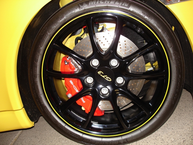

Install is straight forward. Hard part is keeping the spacing evenly from the edges.
What I did was took a 1/4" stripe, put it flushed against the edge of the wheel where it mates to the tire. Did this all the way around. This will serve as a evenly spaced temporary guide for the real 1/8" stripe.
Next, using your finger, put a thin coat of water around the lip. This will allow the 1/8" stripe to move around so you can flush the stripe against the 1/4" stripe. By sliding the 1/8" stripe in place, it will give it that rounded look vs. the angled look you get if you were to tack it in place. You have to have patience here and "squeegie" out the water from underneath with your finger. It may slide around a bit, but if you're patient, you'll get the hang of it. Try dapping it dry with a towel.
Afterwards, peel away the 1/4". By the time I got to the 3rd wheel, I got a good sense of what to do. Had to go back to the 1st wheel and redo.
I initially thought the 1/8" was too thin, but when it's on the wheel, the "halo" effect makes it look much larger than it really is.

P97- thanks for the info, your car was the one i remember seeing. It looks amazing by the way. I don't exactly understand what you did with the 1/4th stripe, was that one used to keep the 1/8th one 1/4 of an in from the tire? How does it look where the edges of the stripes meet up when u get all the way around? Do you have any close up pics of the wheels?

Yes, the 1/4 stripe helps keep the 1/8 centered on the lip and provide equal spacing all around. Pics...Originally Posted by CayenneS2083
