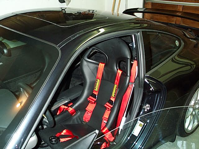

Mooty has it right, If your car comes with the corsas its a good R compound tire all around wet or dry. Once I ware my out I am going with R 6's. Tire pressure, does depend on the tire but generally hot under 40lbs and experiment from that.
On the schroth belts, they make a belt that is specific for the GT3 seats its the Schroth Profi II. you asked enough questions to go on for days, I would take each topic and search the treads you will find tons of info and opinions.
The 3 is a pretty good track car out of the box I would start stock and go on from that as the car is much better than we are starting out. You will be hanging on to the wheel rather than driving it at first.

mooty: i am still on my first set of stock tires and will probably just stick with those...michelin cups, albeit i will get a new set before the track day.
toyo and kumho are other possiblities i hear.
pressure cold on cups?
brakes. i have pccb's. so it looks like RS19 pads and castrol SRF fluid?
roll bar and belts. euro gt3 seats w/schroths a la toad.
jonathan: my track experience in a car is limited. skip barber 3 day race school. some karting. my experience on a bike is extensive. tracked prepped many bikes, ducati, yamaha, aprilia, etc. sop is slicks, steel brake lines, new fluid/pads, revalve fork, new shock, steering damper, water wetter. that'll get you started. but like toad said, porsche has pretty much done all of this for me.
i plan to do maybe 3-4 track days per year. this car is more of my street fighter. if i really wanted a track car id buy a used 996 gt3 and strip it.
toad: id like to have your setup. so much for golf clubs, ill miss the high speed runs to monterey. oh well.
where is the best place to pick up a set of seats, belts, and a roll bar? same for the oil and pads. looking for best customer service and install, no hacks please, there are a ton of them here in the bay area.

sharkwers and tcdesign (see my signuare link) are the BEST in the bay area, they can provide you all the seats, roll bar, belts blah blah. alex knows his stuff. TCdesign is a master in alignment, literally all the fast GT3's in bay area are serviced there. he can do custom roll bar for you. he did 8 roll bars for me, 2 in cayman, 6 in GT3's (yea, all my GT3's). alex can get you seats and so forth.
if you are doing just 3-4 days a year, i wouldn't do too much. just stay with factory pads, run SRF, get seats, belt and safety items. run oem mpsc or toyo R888 in 19" you are set.
