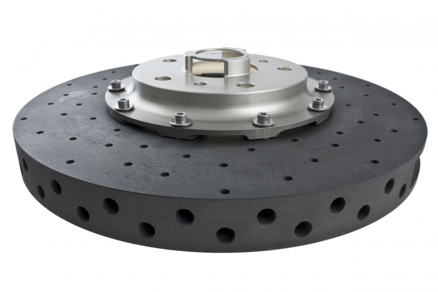

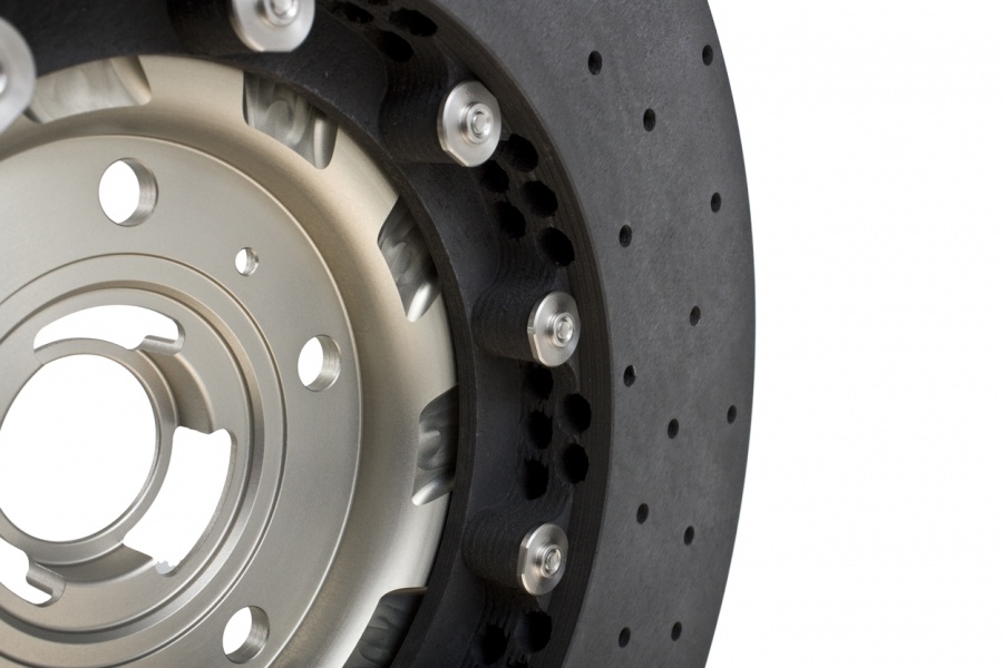

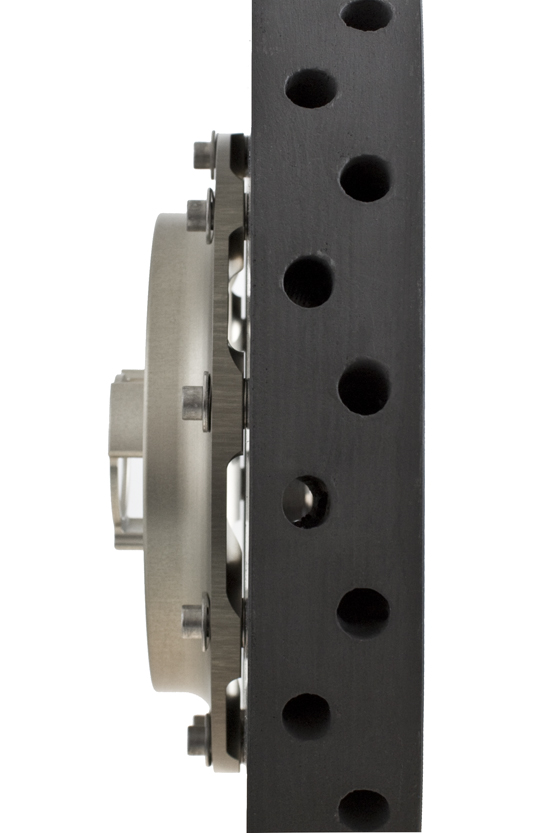

Originally Posted by Gary II
Hands down...the OEM PCCB brakes are a better choice than any of the aftermarket carbon ceramic offerings. None of the companies selling these aftermarket ceramic kits manufacturers their own discs. Most are coming from their manufacturers who do little to no testing on the actual vehicles that the brake kit will be intended for, and then selling them to third party brake kit companies who are even less equipped to handle proper lab and on road testing to ensure the proper results for performance, longevity, and safety.
Quite a few companies seem to be in a race to be the first company to market with an aftermarket carbon ceramic brake kit. What most don't realize is how difficult of a technology this is to get right for customers like us, who's cars are constantly evolving as we add more modifications, and who's usage can vary from a track event one weekend to a road trip the next, or to and from work for months at a time. As we all know, even Porsche has had issues with the first and second generation PCCB's from SGL and you'd be hard pressed to find a company who would have spent more time and money on research and development to get this right.
Sorry, having difficulty focusing on your contention as I cannot tear my gaze off these MovIt carbon silicon carbide monolithic lightweight rotors. What were you saying?
Joking aside, I agree with you in general, however there is an exception. The manufacturer of the MovIt rotors, Surface Transforms (http://www.surface-transforms.com/), also designs and manufactures for trains, planes and rockets...
