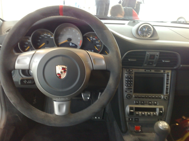

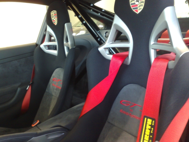

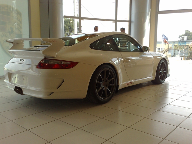

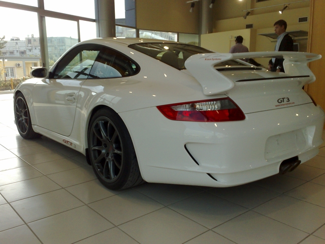

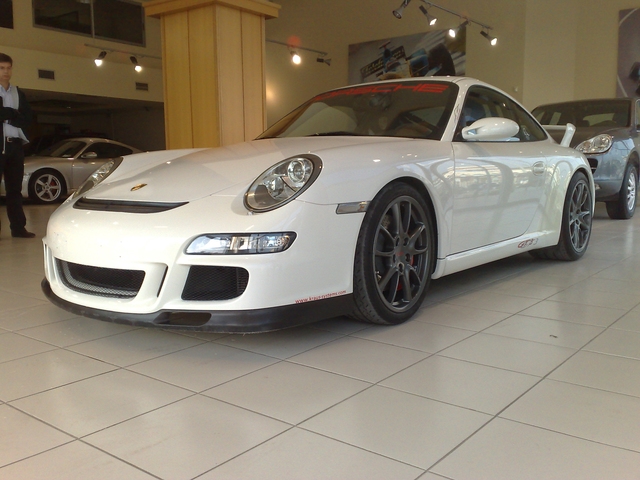

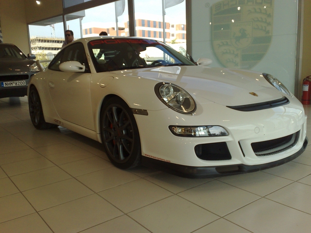

Thanks for your comment....yes,the car is very good..but is time to sale it...anyway....my suspension is stock but i have different alignment,from Kruas-systems.....marco seefried(race driver in germany) help with that....we thought that the back part of the car was nervous and we done another alignment....i can say now is better...i tested the car in Hockenheim and i find it very good balance...the brakes is stock..i have change brake pads and brake fluid....is enought ....actually i dont know the wight of the car....the redline now is 8650rpm......here is some fotos of the car..is in our PC for sale
Old Dec 15, 2008 | 03:05 AM
greekm3's Avatar
Joined: Jul 2005
Posts: 292
greekm3 is infamous around these parts
..and some other
