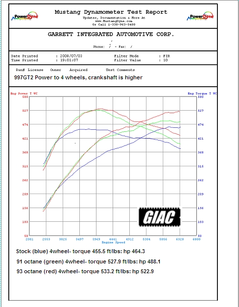

GIAC 93 octane software is now available for the Porsche 997 GT2! First release software provides a reliable 600-615 HP and 615-625 TQ with upgraded headers and exhaust (Numbers are estimated crank based on 4-wheel dyno results and assume a conservative 15% drive train loss). The gain throughout the useable power band, 2000 to 6000+ RPM, is dramatic. Drive-ability remains as smooth as stock with the exception of the impressive pull at full throttle.
An official dyno plot generated from testing is attached. The dyno plot depicts three runs:
- GIAC performance software for 93 octane with GMG turbo-back exhaust and GMG headers,
- GIAC performance software for 91 octane with GMG turbo-back exhaust and stock headers, and
- baseline stock software with 91 octane with a GMG turbo-back exhaust and stock headers.
91 octane, kill and valet programs are also available. 100 octane (race mode) and other inter-cooler programs (91/93) are still in development and will be available within the coming weeks.
We are also still testing and developing software for other hardware parts. We will post additional dyno plots on our web site and this site as new options/ upgrades become available.
Thanks to GMG for first class hardware and providing the GT2 used to generate these dynoplots.

Question< why would you have a 4 wheel dyno for a 2 wheel drive car?
A Mustang has the front and rear rollers mechanically linked. You can have a RWD car spin both rollers. My guess is they would rather have the rollers linked to increase the load on the car....

The 997GT2 must see the same speed on the front or rear wheels otherwise the traction control, abs and other systems start to go nuts.
Since the masters at GIAC tuned the software for the World Challenge GT exhaust system and headers the power gains are proven. Everything is tuned to work together.

Fabryce is correct about the 2wd vs. 4wd question. Our dyno is equipped with a pneumatic clutch that can engage or disengage the front rollers with a mouse click; however, without equal speed/load to all 4 wheels the 997 GT2 shuts down in the higher rpm. In addition to the front wheel speed, we also had to pay a lot of attention to keeping the intake air temps similar to what one would see driving their car on the street or track. As many of you know the inter-cooler design on these cars is made to capitalize on the car moving through air, but it does not really benefit from having fans placed in the front of the car with air velocities dropping off at a greater than exponential rate. Many dyno facilities combat this by setting inter-cooler fans at the rear of the car and blow air backwards through the inter-coolers. With the changes in the rear bumper cover of the GT 2 this is not effective, unless the rear bumper cover is removed or the dyno facility has a fan setup that can adequately blower air the inlets.
