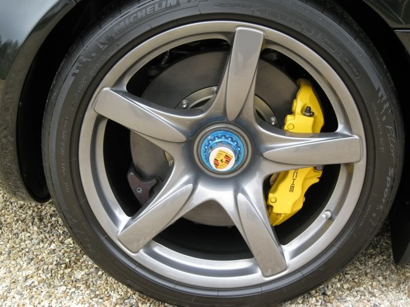

I've investigated PCCB's in great depth as I have them on my 18k mile Carrera GT and they are in the early stages of carbon burn. I've replaced them with ST rotors. These are manfuactured in the UK and sold through Movit. The entire construction of the disc is ceramic composite, and the fibres are longer and have a different orientation so the lifespan of the disc is hugely more than the SGL/PCCB solution.

I'm sorry, ST are System ST rotors. The company was founded to provide a solution for the French high speed train to reduce the number of cast iron rotors per carriage.
Their website is:
http://www.systemst.com/
Here they are fitted to my Carrera GT. System ST and Movit are currently making a set of rotors that will be cross drilled and mounted to the PCCB/SGL hat and mounting hardware so it will retain the OE look:

In the UK PCCB's are £4k GBP each + 17.5% sales tax.
The Movit/System ST including new hats and hardward is around 55% of the cost of the PCCB. This with better durability and within 0.50kg per corner of the PCCB makes it an excellent solution.
