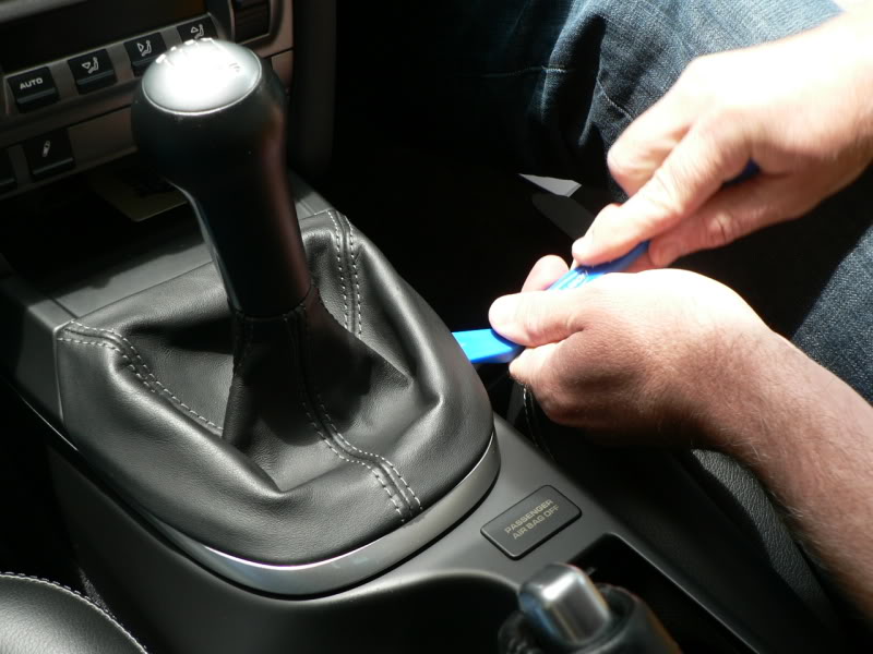

First, having a set of plastic interior trim pulling tools is very important. The tools keep you from scratching stuff and are made to deal with modern fasteners and clips Of course we sell these but… they really make things easier.

Now remove the shift boot.

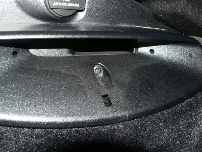

If your car has a Bose System, you need to remove the subwoffer. There is a screw in the outlet port and then once that out, one bolt secures the unit.

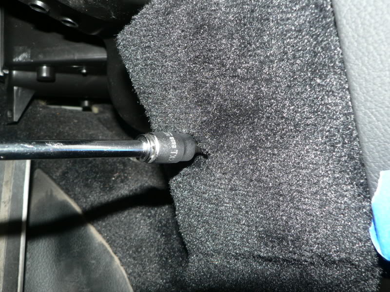

To release the large trim panels around the PCM, remove the two small carpeted panels at the back of the dash. There is a screw hidden in the pile.

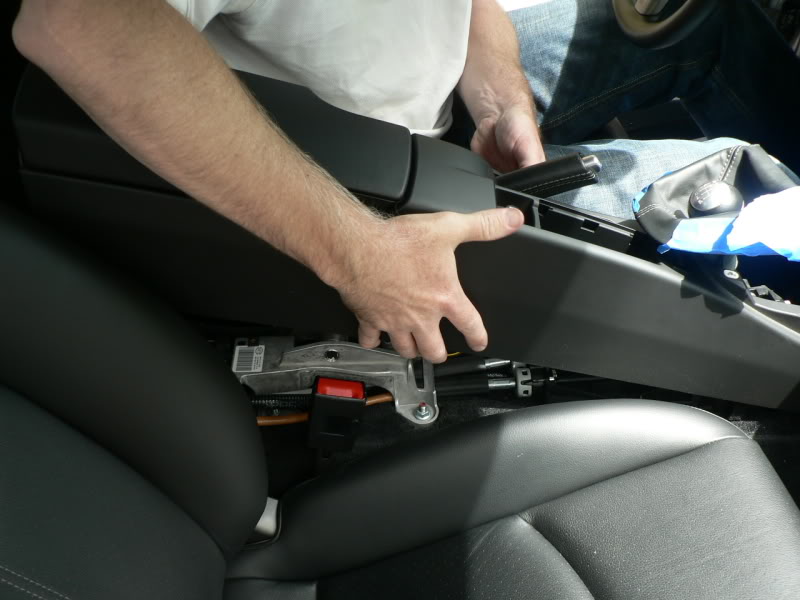

There are several more screws (six more in fact) to remove. See the guide for the list. Once that's done, remove the console form the car.

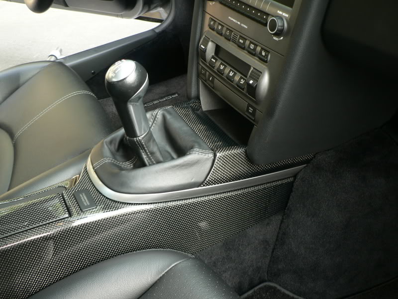

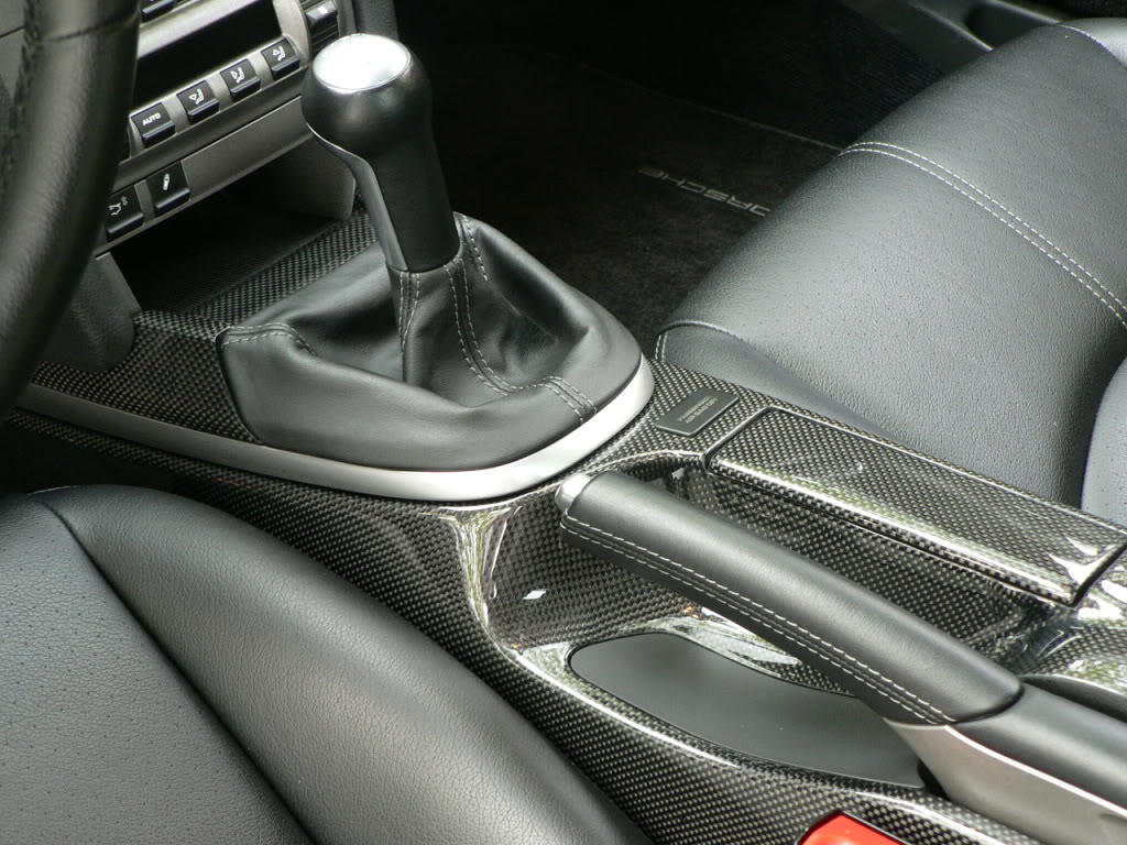

When you are done, you have a high impact carbon interior piece in your car! And the satisfaction of having done it yourself!
