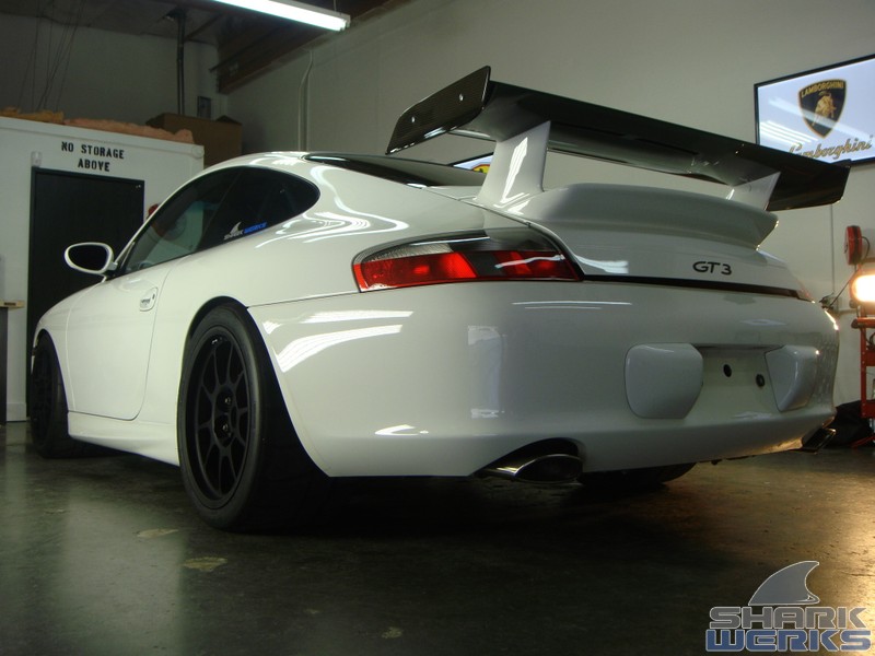

^ thanks... I was just ruminating with my tech about a decrease in the price of the 3.9 kit if I kept his exhaust etc... :-)
when rebuild time comes... I have your number :-)

Roger that and good thing that I just picked this car then eh
