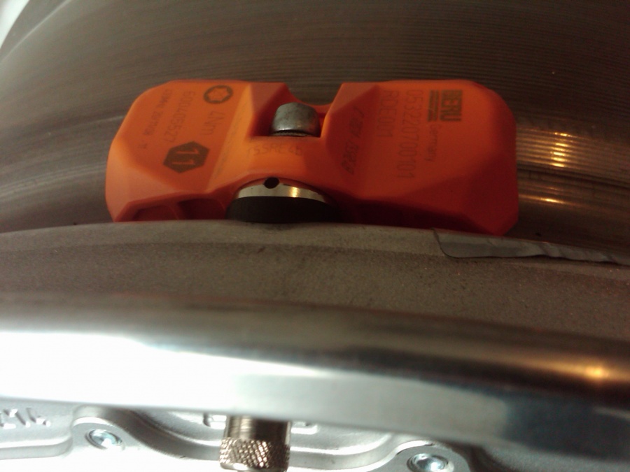

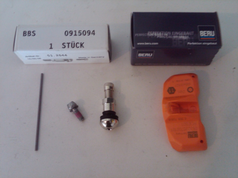

I use TPMS on my BBS E88 wheels with R6s. I love knowing what my tire pressure is during a run. Why would anyone turn down more info if it is out there?
