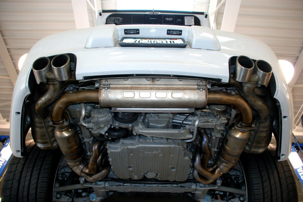

997.2 from below. any ideas on where to place the jack to lift the motor for changing the mounts?

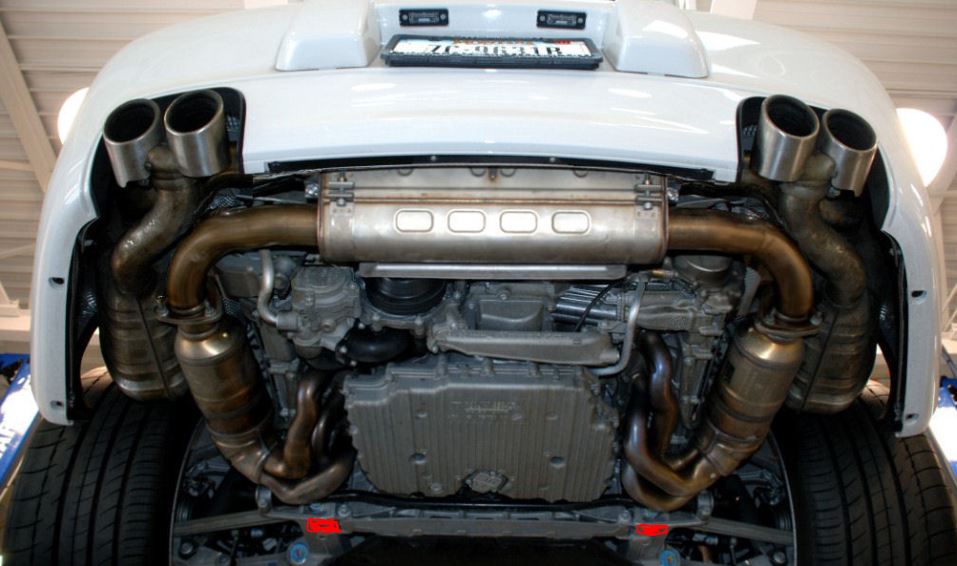

Jack up the rear of the car from the regular jack points in front of each rear tire. Position your jack stands as indicated below (at red marks). To take the weight off of the engine mounts, put a short piece of 2x8 lumber flat under the oil pan and carefully jack it up a bit.
Worked great. Thanks!
