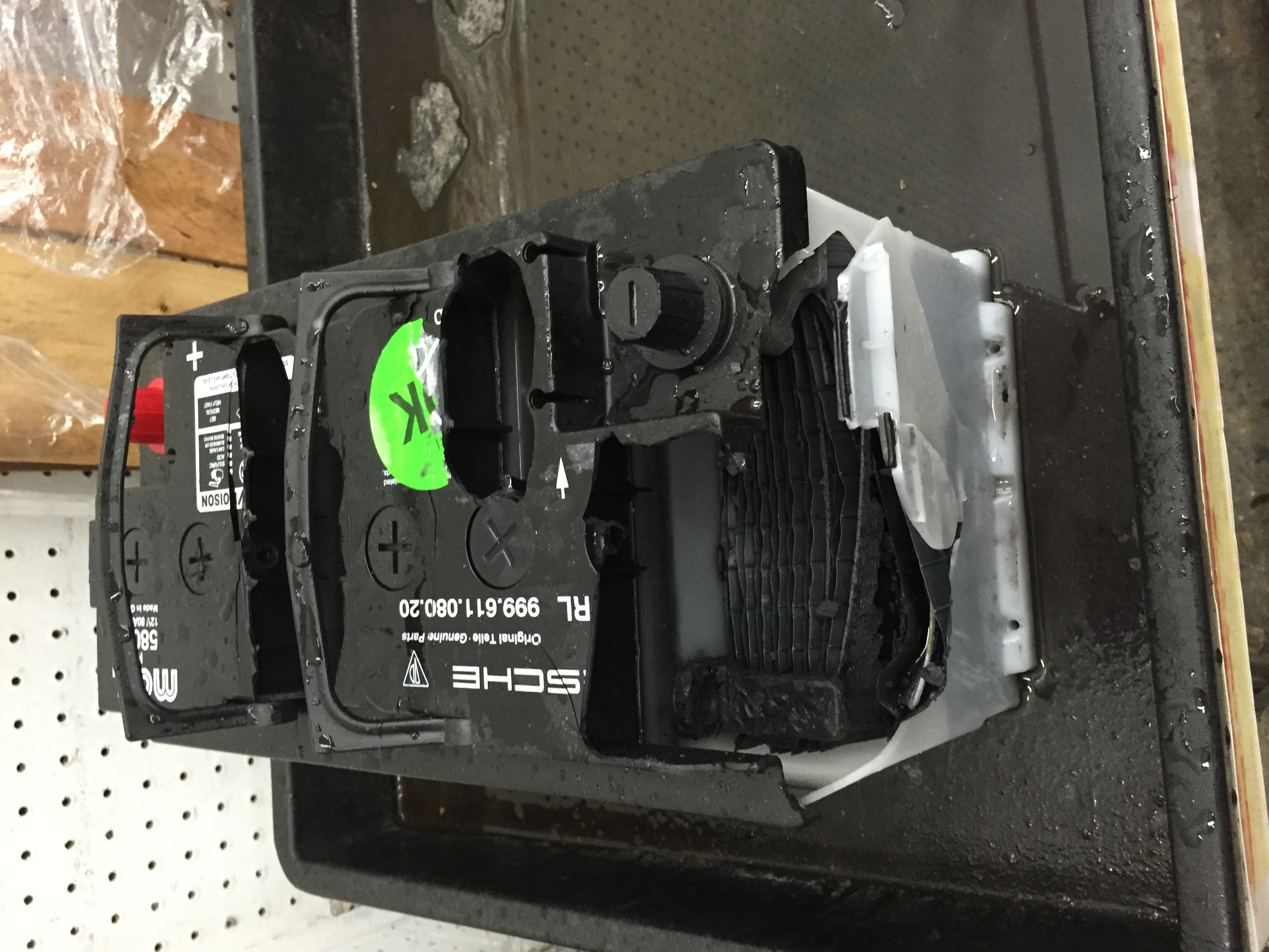

Originally Posted by wpgfordguy
QFT, this is an issue with Lead Acid batteries not Porsche
Mine grenaded in my hands today,,, original OEM Porsche battery and could have been a serious injury,,,

Use sealed batteries. They have been around for years and no need for a vent tube. Available in lead acid or AGM.
