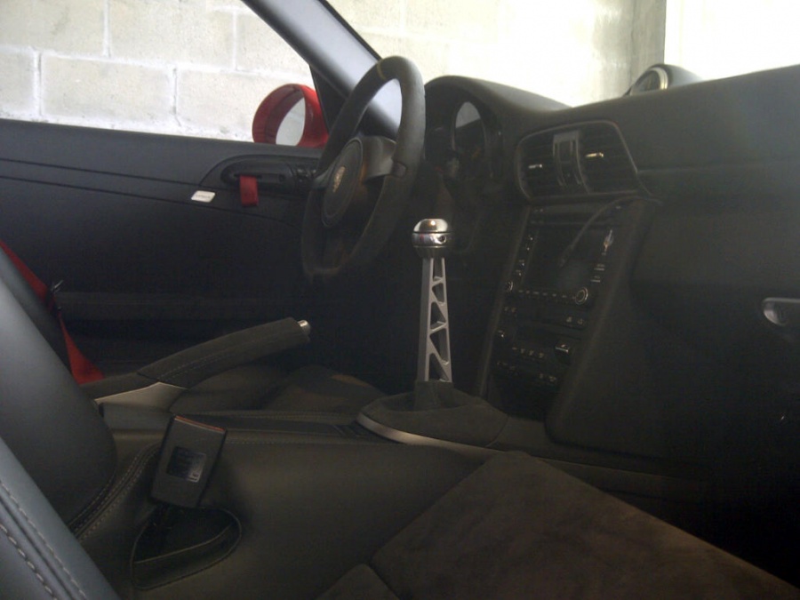

That's awesome. Thanks for the description of your new shifter experience. When you get a chance shoot a pic of the interior/shifter.

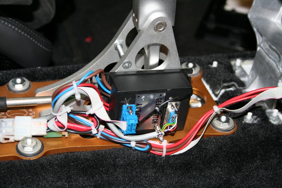

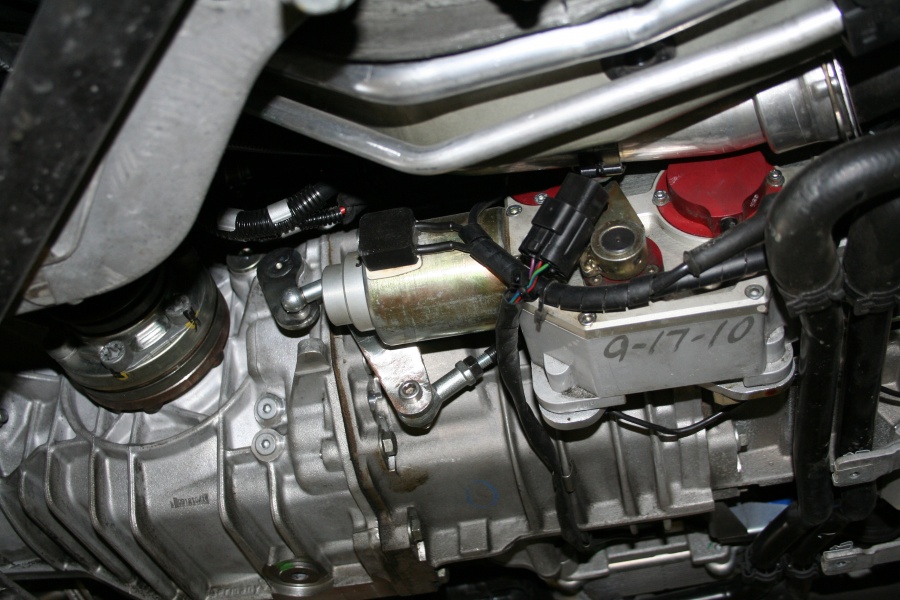

Pictures
Name:  Fort Lauderdale-20111213-00177.jpg
