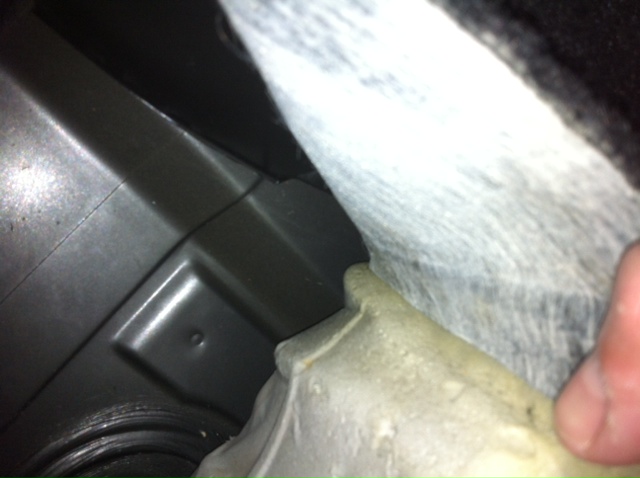

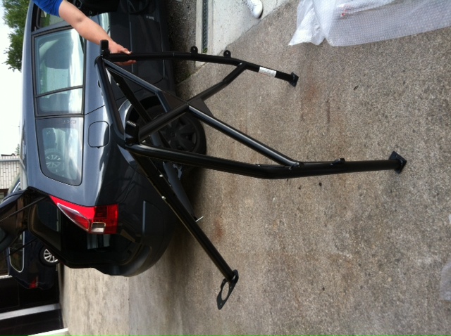

Hello dear members,
please find in attachment photos. This is the OEM roll cage ive got today for my 997.1 GT3 !

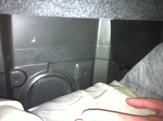

How to fix roll cage plates with holes to floor behind seats?? there is no factory plate with screws already prepared on car - see photos under the carpet i took right now.
Anyone? help please. Thanks in advance.

The OEM mounting brackets have to be welded in before you can install the OEM roll bar. That's why I decided to go with the GMG roll bar. The GMG bar is mounted to the OEM seat belt mounting points.

Clear... i did drilling of floor and installed it wituout welding with plates and screws..looks very good !

Here is some info on our roll bars:
http://www.gmgracing.com/porsche_interior.shtml
No cutting our welding required with the GMG RSR or WC bars.
