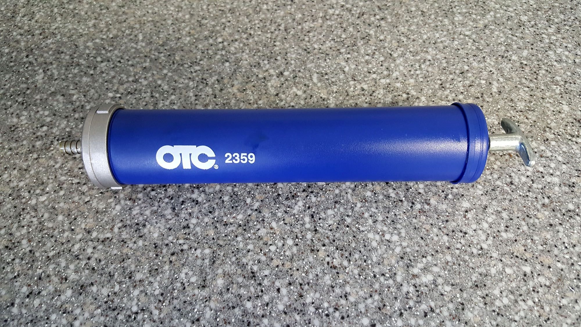

So ignoring the posted wisdom (?) I looked for the best durable liquids vacuum extractor that I could find. I didn’t want a bulky one or motorized one (air or electric) as storage space in my garage is at a premium.
There are several compact plastic versions that work once and then never again, but the <b><u>OTC (2359) Oil Suction Gun</u></b> OTC (2359) Oil Suction Gun had great performance and durability reviews, costs only $12.87 and ships free with amazon prime. Cannot get a better deal than that!
I knew I would need a longer and smaller diameter tube to get into the nether regions to augment the plastic tube that comes with the OTC (2359) Oil Suction Gun which has an OD of appox. 0.62” and in ID of approx. 0.40”

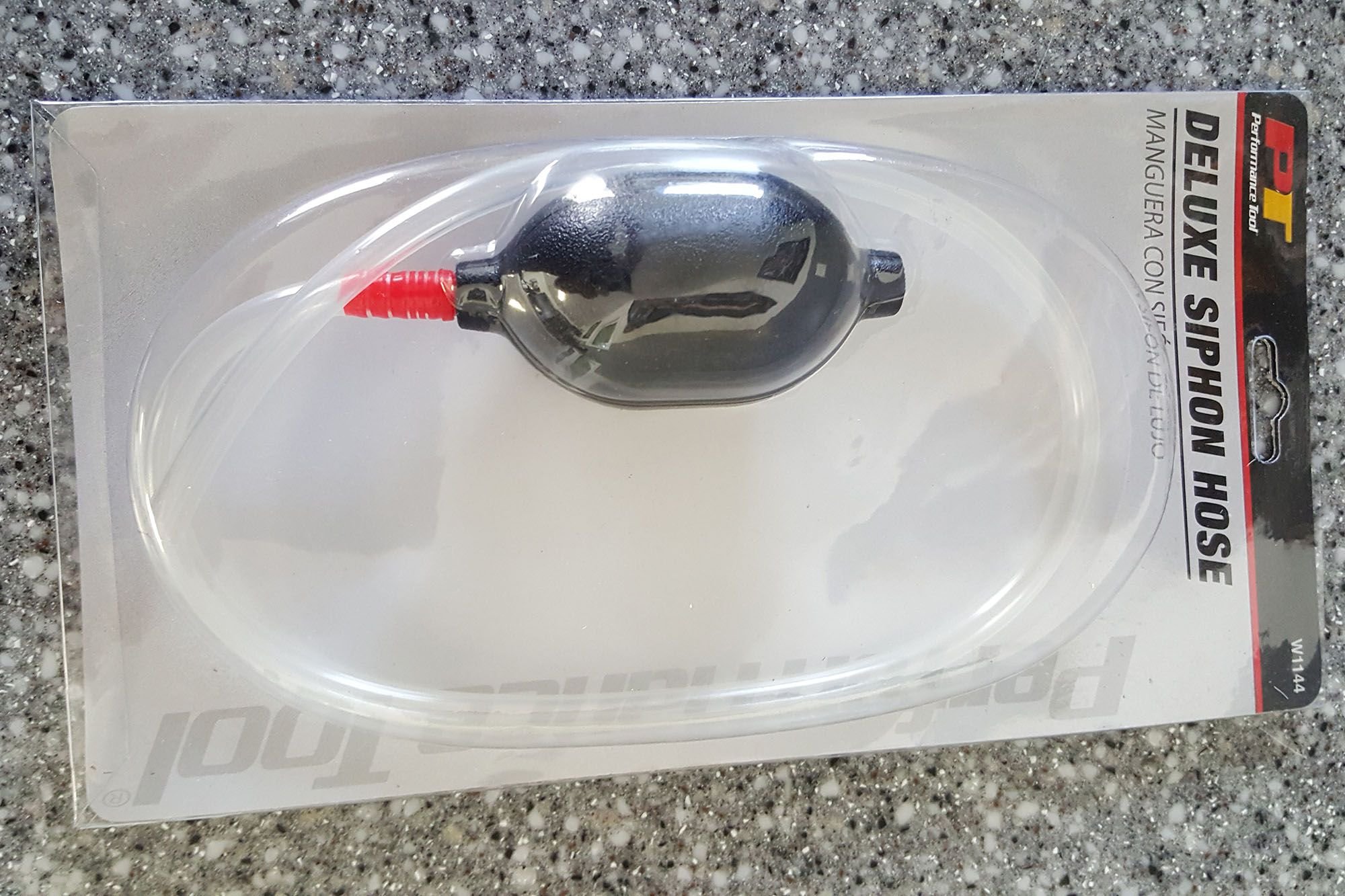

So armed with my Vernier caliper I went to my local Advance Autoparts Store to look for the right diameter tube but instead I found this hand “PT Deluxe Siphon Hose” vacuum bulb for $4.99 which had the a 0.30” OD tube that would work with some tape, but it had these perfect dimensioned 0.42” connectors that would snugly fit inside the larger tube that comes with the OTC (2359) Oil Suction Gun. (see red connectors in image below)
So I was good to go and try and succeed where everyone else had failed.

  • Connect the two tubes together and connect to the OTC (2359) Oil Suction Gun

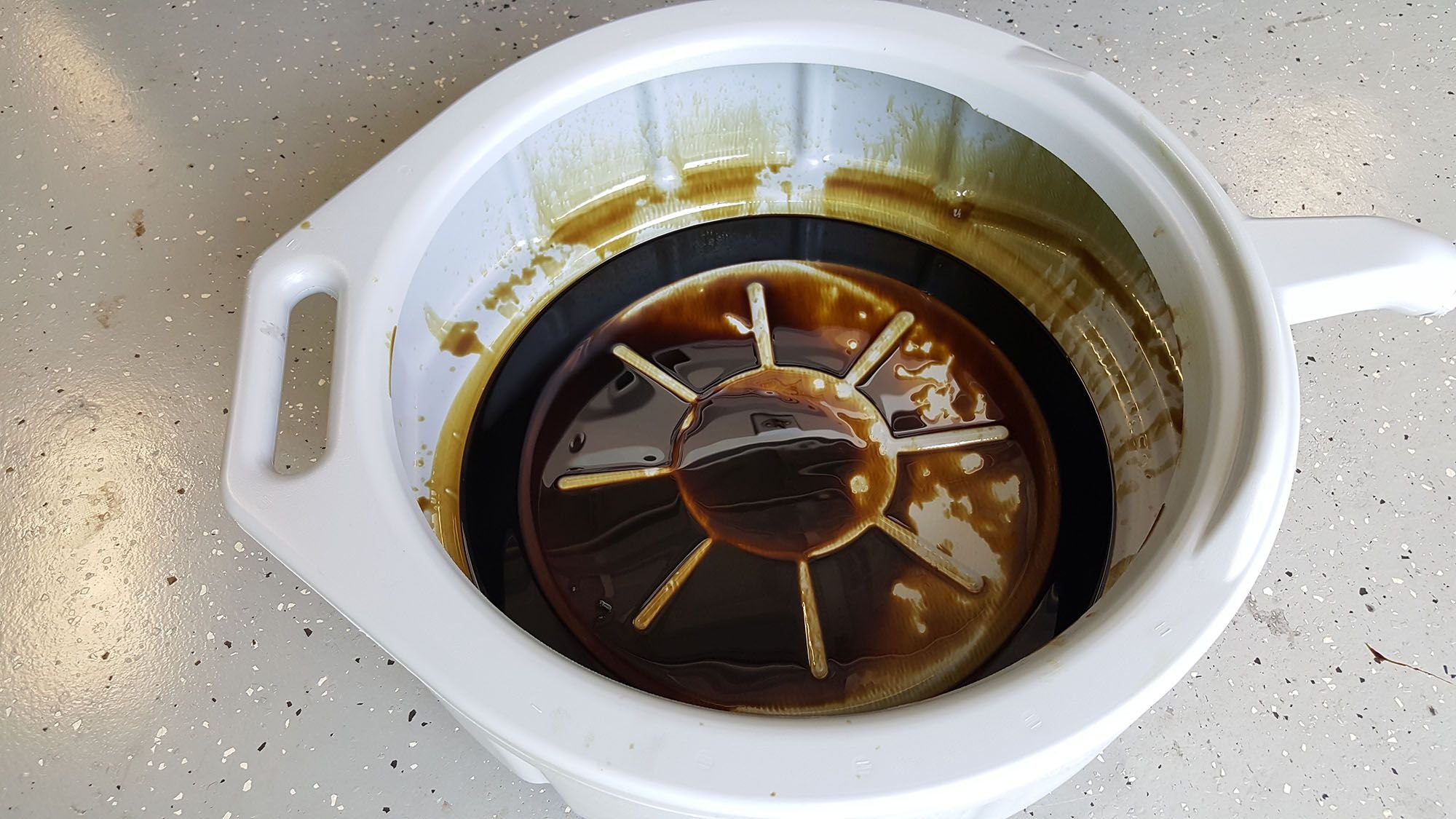

  • In my case I immediately hit oil (ha ha) and rapidly came up the tube into the OTC (2359) Oil Suction Gun and I was easily able to dispense about ¼ QT it in the oil drain pan (not a complete stroke on the gun). I suctioned the oil twice to remove too much as it is way easier to add if needed to. Just be careful when removing the plastic tube from the oil filler neck. You will want to grab it to stop it dripping BUT REMEMBER THAT THE OIL IS HOT SO USE MECHANICS GLOVES!
I did the entire process getting the oil level to the top green indicator in less than 5 minutes from the time I parked the car, so much simpler and easier than jacking a car up onto stands, draining oil from the drain plugs, replacing sealing rings and more

How long has the engine been overfilled with oil? That oil looks pretty dark. I've run oil 5K miles in both my Porsches -- albeit with 5K miles accumulated in a week or so's time driving half way cross country and back again -- that looked better upon draining.
Just under 1,700 miles.
New car, changed oil and filters at 100 miles and again at 500 miles. Do this with all my cars. Now just shy of 2,200 miles
