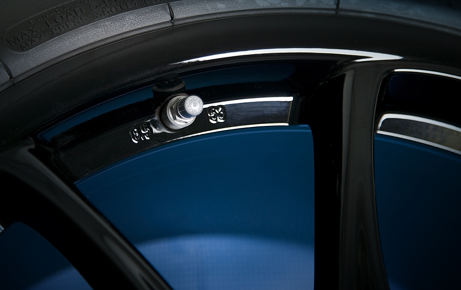

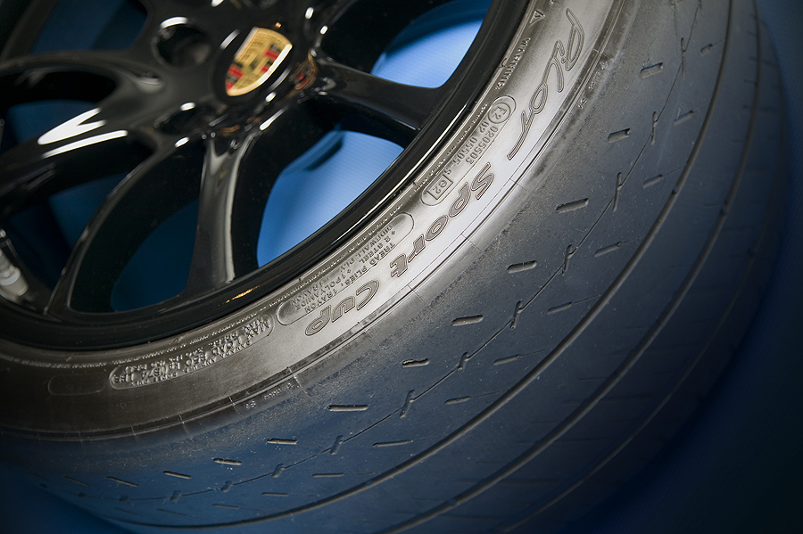

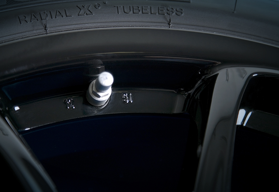

Not sure if you found the exact answers yet...just skimmed the thread.
STOCK GT2/GT3RS RIMS
Fronts: 8.5 x 19 offset 53 with 235/35’s MPSC’s tires mounted
Rears: 12.0 x 19 offsets 51 with 305/30’s MPSC’s tires mounted
NOTE: Acceptable tire size/range for the fronts: 225-245 & 295-335 for the rears.
Vehicle application: 996 wide body, 997 widebody. Not sure of tire clearance for narrow body cars.
