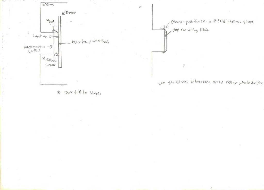

The wheels arrived with a mis/unmachined mounting surface on the front wheels.
This was the diagram which my mechanic drew to outline the issue with the front wheels.

The wheels fit halfway, leaving a very small gap between the rotor hat and the wheel mounting surface, this caused vibrations while driving that feels like the wheels are unbalanced.
I immediately pulled back to the workshop after I felt the vibrations, and the brakes seized in front of the workshop. The workshop then took off the wheels and started dismantling the brakes to see what was causing it to seize.
It turns out the brake rotor was cracked, and the rotor hat was warped from the vibrations caused by the ill fitting wheels. The rotor was grinding on the calipers, steering knuckle and brake dust shield which caused it to seize completely.
The mechanic took the wheels to the machinist and also brought the stock wheels for comparison. It turns out that he was correct, the mounting surface of the forgiatos did not fit the hat and does not have the same profile as the stock rims. They then offered to machine the Forgiato to match the profile of the stock rims. Below is the picture of how much material they had to take off the wheel mounting surface.

6. Tech disassembled the front brakes and found that the front wheels mounting surface was not the correct shape.
7. Vibrations from ill fitting wheels destroyed rotors, bent steering knuckle, and dust shield.
