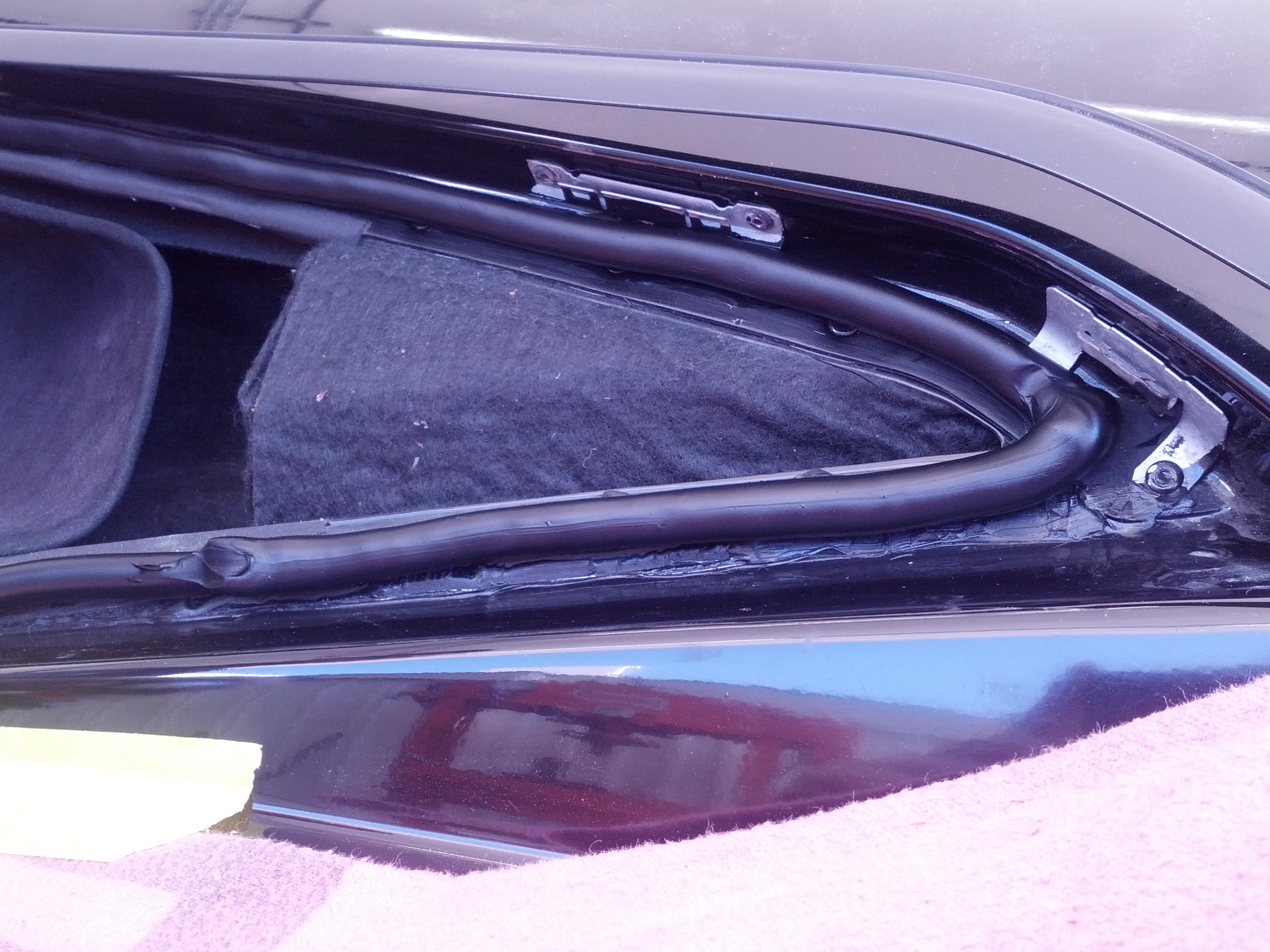

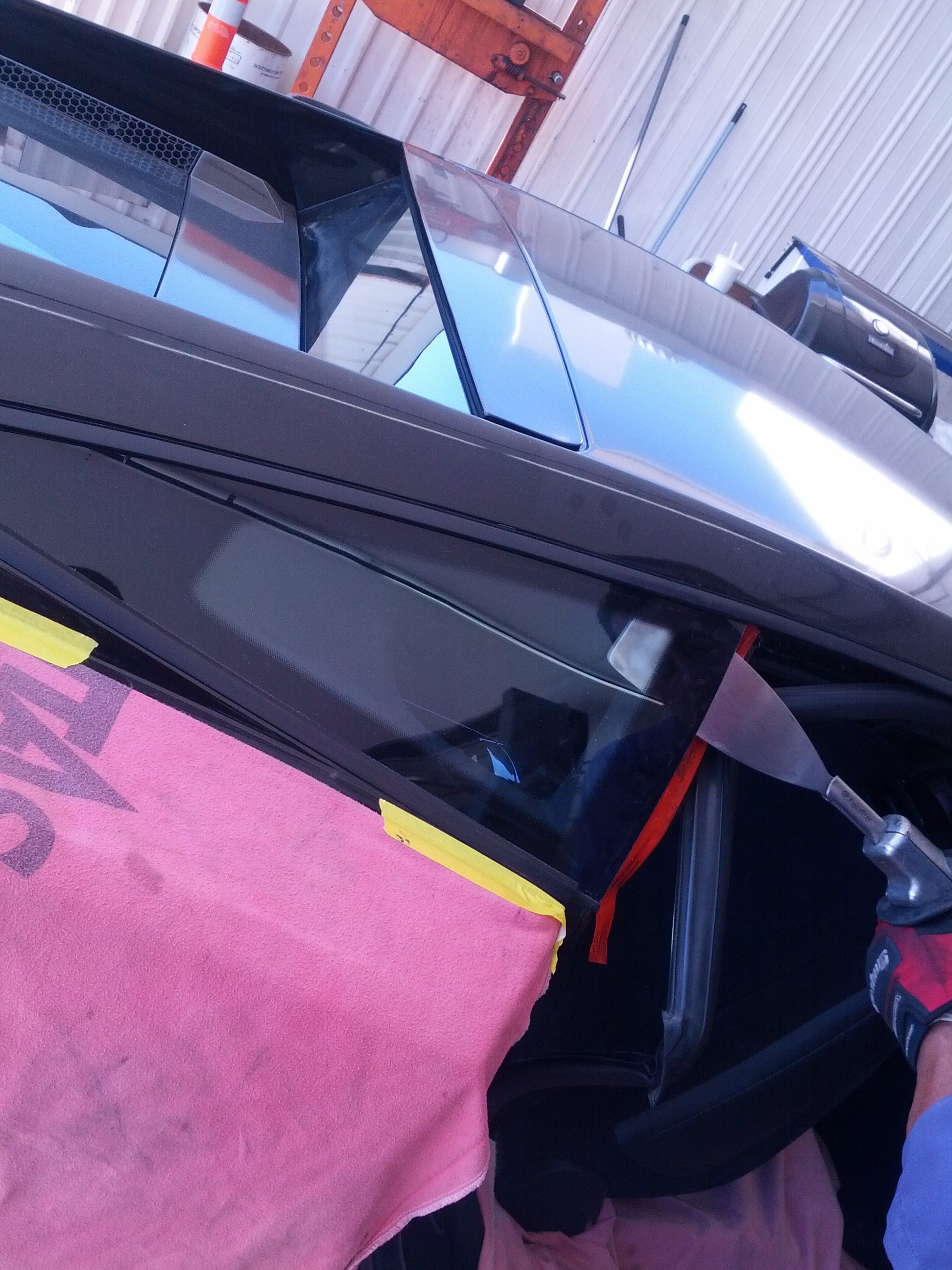

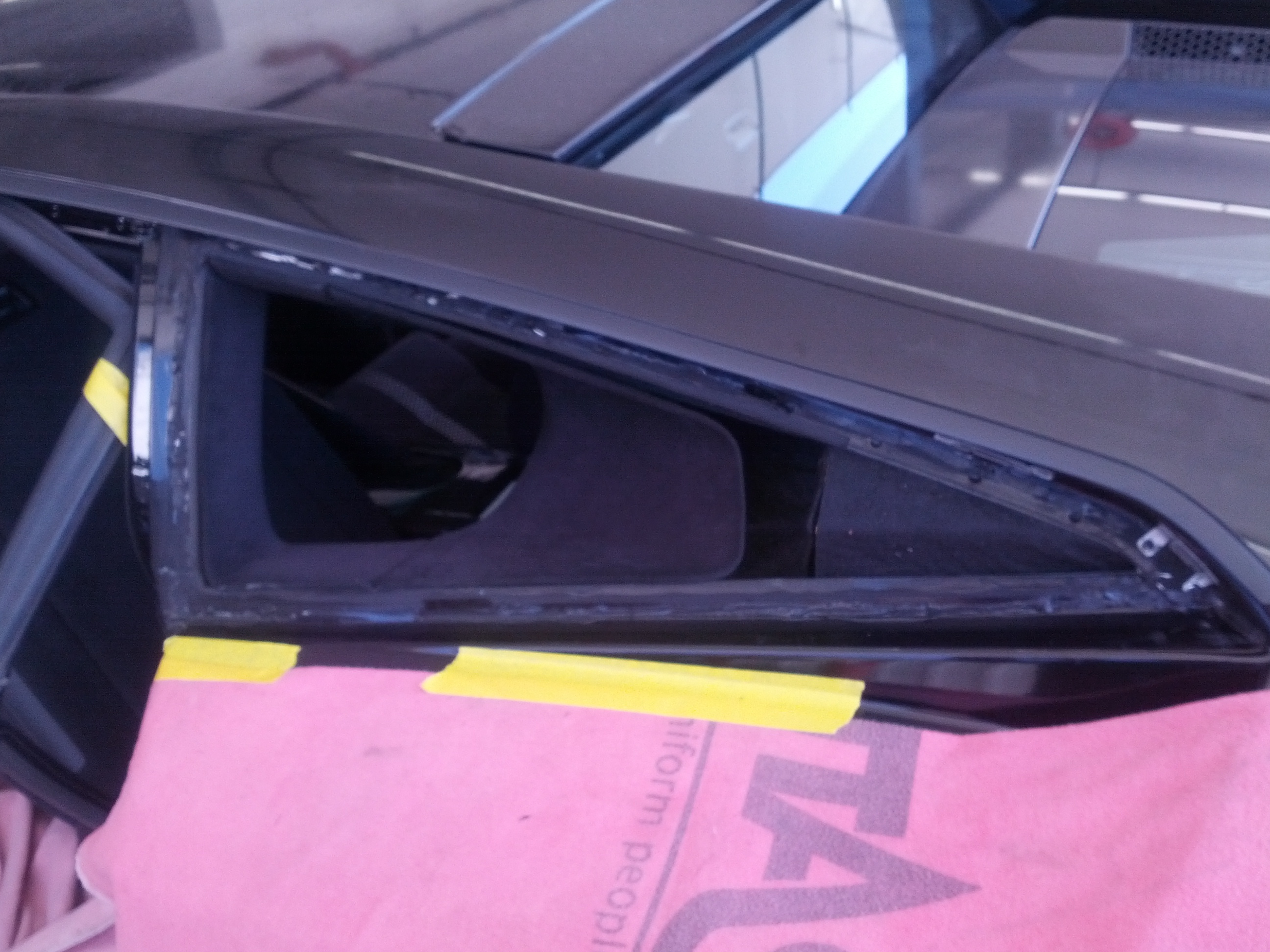

Since I was extra anxious about this repair job, I watched it
in person. As a result I have a ton of pictures. A few of them
are attached; if you find yourself in need of more (because
you face this same repair), then drop me a line.
Last but not least, so far I am very happy with the repair job.
The work was contracted out from LGLC to George from San
Jose -- he is knowledgeable, meticulous, detail-oriented, and
professional... and he charges a reasonable price.
So thumbs up from me -- CA rainy season, here I come! :-)
