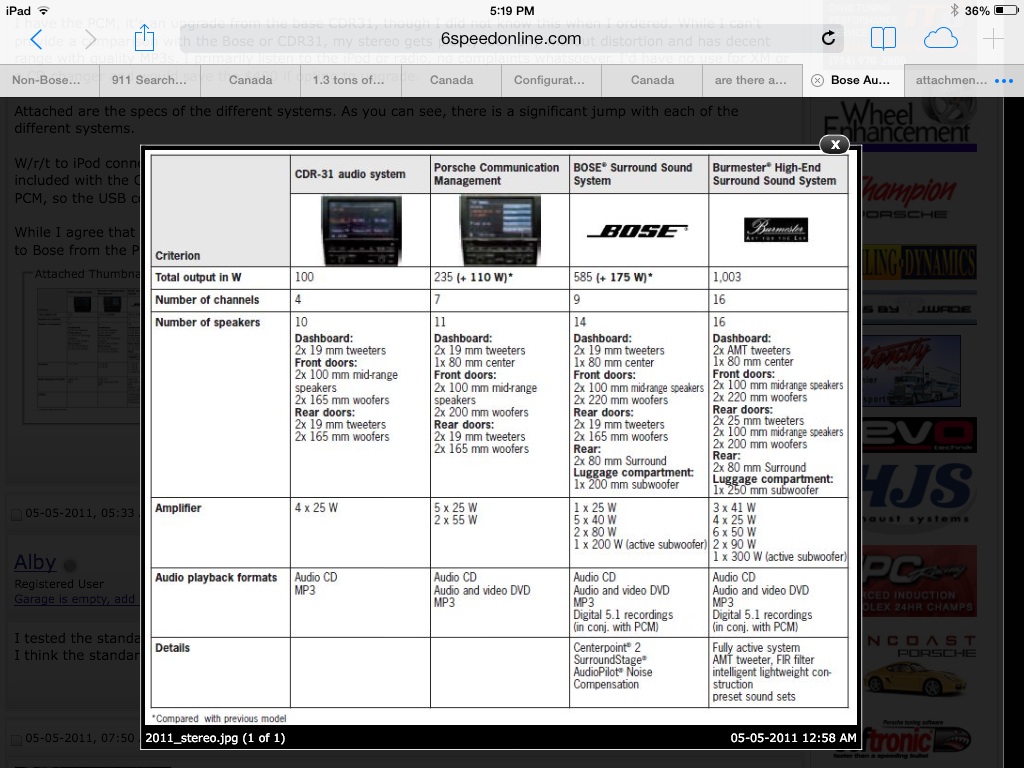

Thinking about audio config on a Macan S.
I am familiar a bit with Porsche sound systems and understand that if one specifies Bose, then the head unit has a MOST (optical) output which can be difficult to integrate into. Also, I'd rather install a custom system than go with the Bose - the $1500 odd dollars is a good start towards a custom system.
My question is if anyone has details on the configuration of the CDR plus with PCM system. The specs say 11 channel, 235 watts, etc. I would like to know if there is a separate head unit and amp and further if the head unit has line level outputs that can be used as input to a custom system.
Also, has anyone investigated potential locations for aftermarket amps, processors, etc.
Lastly, anyone figured out a good place for an aftermarket sub (other than a big box in the cargo area)
db

Hope this helps.

Handy chart. Thanks
