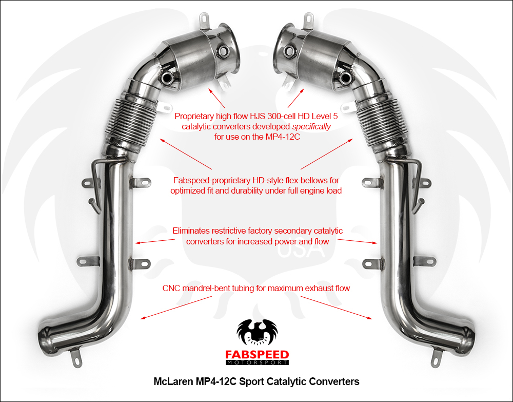

Fabspeed Motorsport logically and initially designed these systems to utilize a 200-cell sport/racing catalytic converter that we had previously used on our super-high horsepower, world famous Porsche 997 Twin Turbo sport exhaust systems. The logical hypothesis and assumption, in conjunction with off-the-shelf thinking, was that these large round long HJS 997.2 Twin Turbo catalytic converters could support 800HP, so therefore they would support the 650-800+ horsepower of the 3.8L McLaren Twin Turbo engine.
Fabspeed’s engineers were able to make this cat fit and work with a lot of tedious work, but the super-long 997 Twin Turbo catalytic converters did not fit properly and there were too many complications and outright negative compromises that limited the performance and durability. In other words, the 997TT catalytic converter and other off-the-shelf HJS catalytic converters that Fabspeed Motorsport utilizes for other supercars were much too long and too big to fit correctly, and Fabspeed had to bastardize the catalytic converter and compromise the symmetry of the inlet and outlet pipes to make the 997.2 Twin Turbo catalytic converters and other off-the-shelf HJS catalytic converters fit. Fabspeed Motorsport USA and HJS Germany mutually decided that forcing or manipulating a 997TT catalytic converter that is over 32% longer than a stock McLaren primary catalytic converter to fit was the WRONG solution for the McLaren Twin Turbo, which must meet Euro Level 5 emissions.
Faced with this unique challenge, Fabspeed Motorsport called HJS headquarters in Germany and discussed the parameters and the issues that had become apparent. Joe Fabiani, the president of Fabspeed, spoke with Klaus Osterhaus and HJS racing engineers and then Joe Fabiani paid for the tooling, engineering, and development of an ultra-high-flowing 300-cell HJS catalytic converter specifically for the McLaren MP4-12C cars. Fabspeed Motorsport is HJS Germany’s largest volume customer in North America and South America, and HJS provide this super high-flow short 300CPSI catalytic converter – as an exclusive – to Fabspeed Motorsport. These Fabspeed Motorsport HJS MP4-12C specifically designed and engineered cats match up perfectly to any stock or aftermarket McLaren rear muffler system.
Fabspeed Motorsport’s compact 300CPSI tri-metallic OBD2 EURO Level 5+ certified proprietary catalytic converters fit precisely, and as expected given their short length, significantly outperform the 32% longer and incorrectly-fitting 200-cell 997TT cats in back-to-back testing. From exhaust flow to power gains and 300CPSI cats also have a 50% more precious metal coating and stronger core structure so the Fabspeed McLaren cats are better under any and all engineering based criteria.
This is logical, given that Fabspeed Motorsport USA took a blank sheet of paper and partnered with HJS Germany to develop, at great expense, a dedicated and bespoke catalytic converter for the wonderful new-at-the-time McLaren MP4-12C cars. The Fabspeed Motorsport bespoke McLaren catalytic converters are HD directional, 50% stronger than 200 cell HJS 997TT catalytic converters. The Fabspeed 300-cell McLaren catalytic converters also cost significantly more in terms of custom-tooling and precious metal wash coating/loading materials than did the standard off-the-shelf Porsche 997TT catalytic converters. After more than 20,000 combined miles and over 60 systems installed, not one CEL light or failure has been reported on Fabspeed ultra flow McLaren catalytic converters.
This in-depth research, development, engineering, and testing led Fabspeed Motorsport to market their new system with the specifically-designed 300-cell cats, instead of the 200-cell versions that are in use by their competitors’ systems. Fabspeed was the first company to design and use 200-cell HJS cats, but quickly realized that 200-cell cats were a weak unacceptable compromise for deployment on the McLarens.
As clearly mentioned above, the bottom line for Fabspeed Motorsport USA and HJS Germany is that the extremely long 200-cell cats were not suited for many qualitative and quantitative reasons. The final conclusion was that given the MP4-12C’s exhaust geometry and flow pattern, that the Fabspeed-exclusive 300-cell HJS HD Level-5+ cats were – and are – the premiere performance option for these cars.
