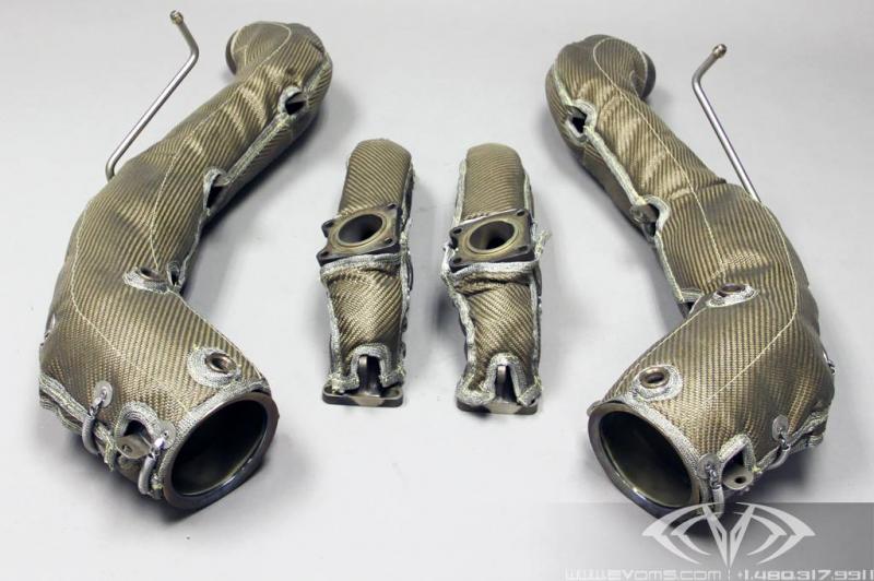

Here is a picture of the heat covers that Evoms made for the Mclaren great looking and working addition to the car.

This car broke into the 9s running our EVT825 Turbo Kit. The kit includes Garrett-based ball bearing turbos, exhaust/high flow cats, thermal protection blankets for the exhaust and manifolds, and an EVOMSit ECU flash tune. It puts down 700whp and 600wtq on our Mustang AWD dyno, matching the stock turbos on initial spool up but delivering dramatically more power and torque at every engine speed. The power curve is silky smooth, and generates violent acceleration regardless of engine speed. OEM diagnostics, traction control, various engine modes, etc. are all maintained like stock.
