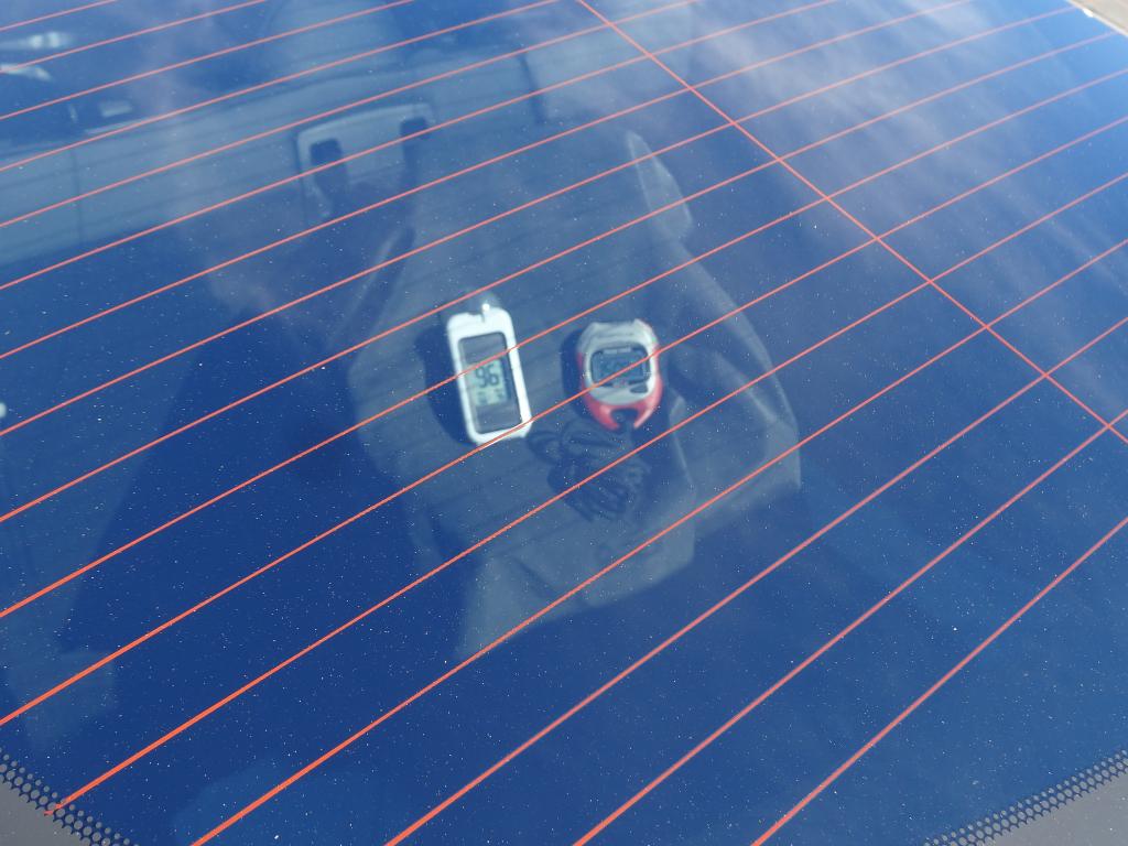

We recently conducted a test to see how hot the Tesla Model S gets in the rear. There is a general consensus among Tesla owners regarding too much heat build up. For the rear hatch of the Tesla Model S, there is an option for rear facing seats for children. Owners of the Model S have been complaining and executives at Tesla even know of this issue. With that said, we decided to conduct a test to measure the ambient air temperature of the rear hatch. Tesla's rear hatch glass is a laminated glass that has a metallic coating to it to reject some heat; however, even this is not enough from our findings.
Though this is not a 991, we believe it is necessary to show the efficacy of every product we carry at Premier. Below is our test:
Test Subjects - 2 Tesla Model S
Tesla 1 - factory laminated OEM Glass with metallic coating
Tesla 2 - Spectra PhotoSync 45 installed to the side glasses + rear hatch
30 Minute Test in the Rear Hatch with both vehicles side by side
Duration: 30 Minutes
Time of Test: 3:35 pm
Exterior Temperature: 88 degrees
Purpose: Compare air temperatures inside hatch between vehicle with no window film and the other with Spectra PhotoSync installed
Here are the two test mules:
Test Vehicle 1 - No Film
Start off at 84 degrees
In just 3 minutes the temperature rose to 92 degrees
Close to 7 minutes, the air temperature rises to 105 degrees
At the 15 minute marker, temperature is at an unbearable 123 degrees
26 Minutes - Temperature now reads 136 degrees
At the end of the 30 minute test, it is a scalding 140 degrees, which is the reason why leaving children in a vehicle can be a fatal mistake.

Test Vehicle 2 with Spectra PhotoSync 45 installed to the side and rear hatch.
Test starts at 85 degrees
At the 15 minute marker, it is 96 degrees compared to Vehicle 1 at 123 degrees.
At the completion of the test at 31 Minutes, the Tesla Model S with Sepctra PhotoSync is at 104 degrees compared to 140 degrees in the other Tesla. This is a 36 degree differential!
