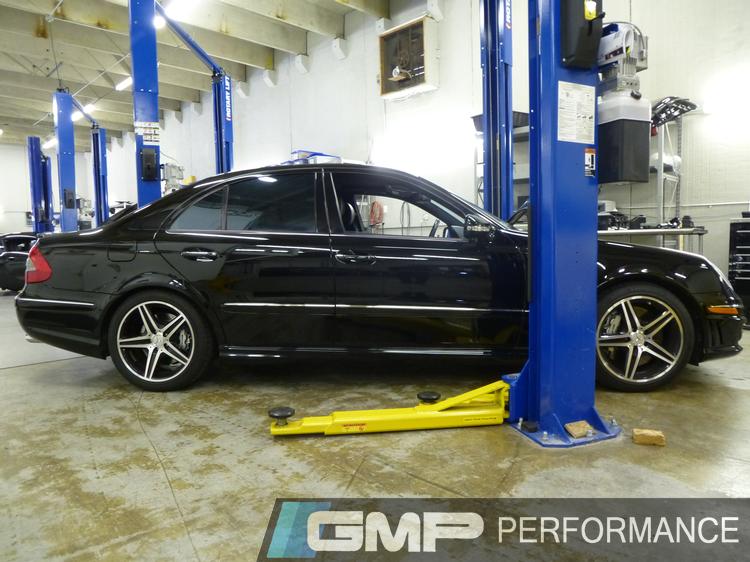

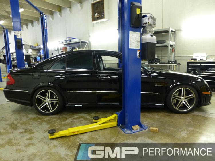

The owner of this 2008 E63 has been preparing for his supercharger kit for a while, having brought it to us for a Quaife limited slip differential to set up the car's handling for the future power upgrade. Getting their upgrades from Kleemann, pros at the mechanics of a Mercedes engine, it's no joke to say this E63 will be one bad Benz by the time we're done with it!
Parts Installed:
Mercedes AMG V8 2002 MY-on Quaife ATB Helical LSD differential
Mercedes 63 AMG (M156) V8 Supercharger kit by Kleemann
Mercedes AMG63 Long Tube Kleemann Headers
KLEEMANN Electronic Body Lowering module (EBL)
Mercedes AMG63 M156 Billet Idler Pulleys
The Build

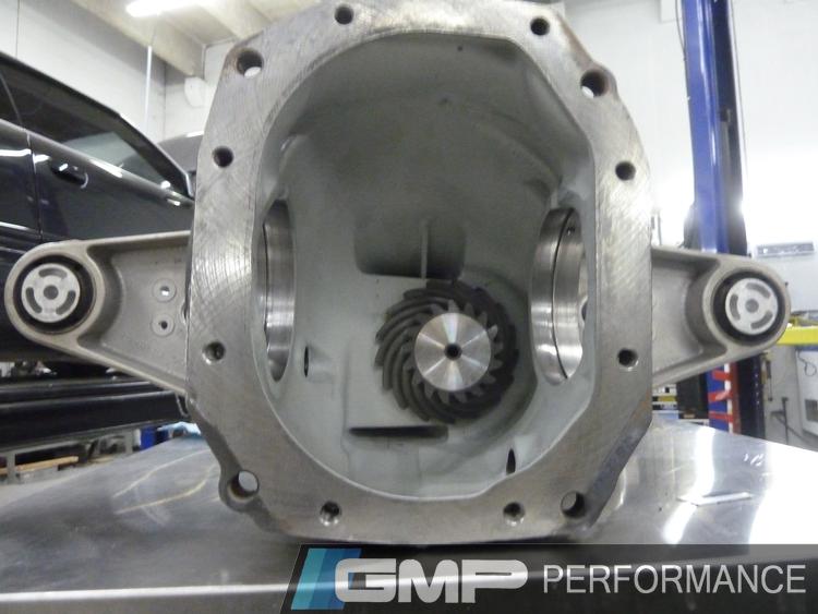

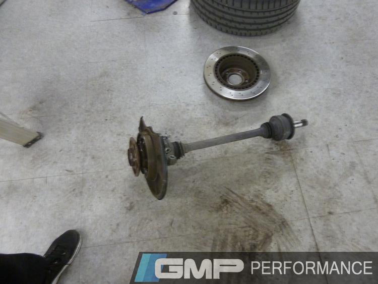

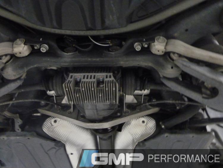

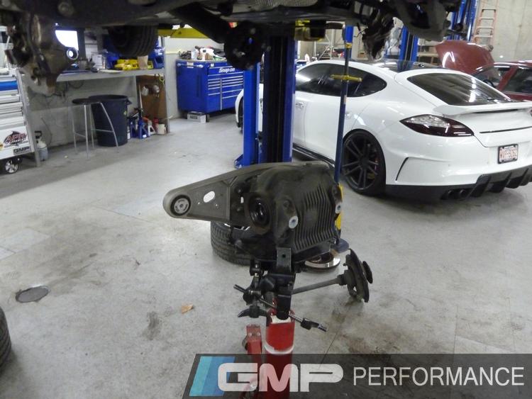

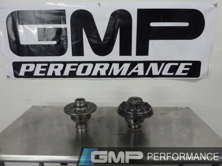

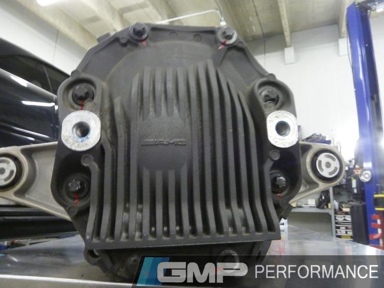

Quaife Limited Slip Differential
First, getting it out!
Quaife versus OEM
Kleeman's lowering module
Before the module
After the module

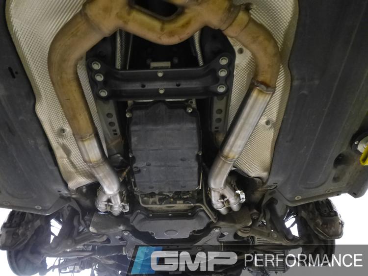

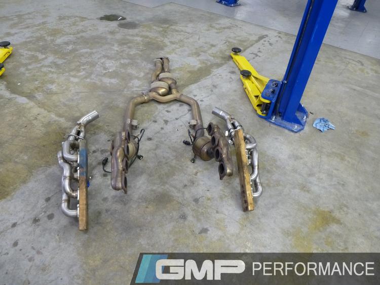

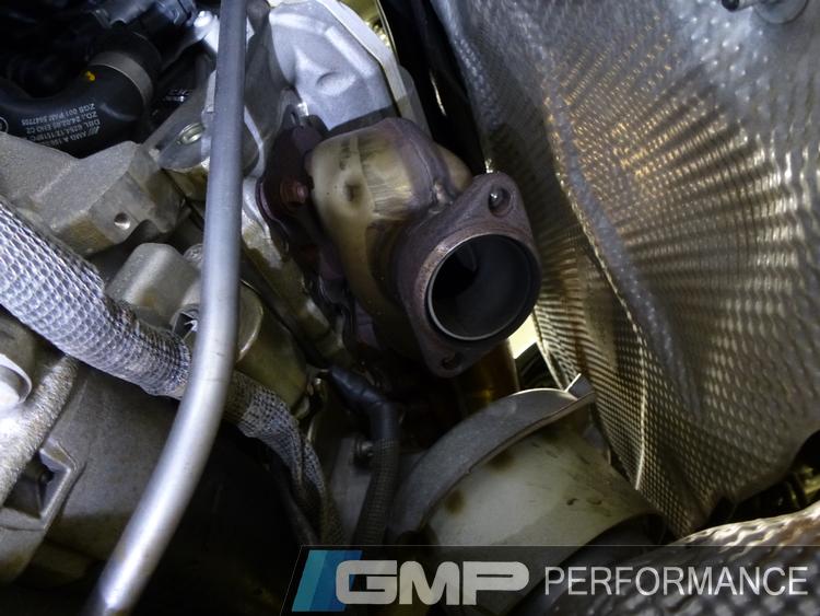

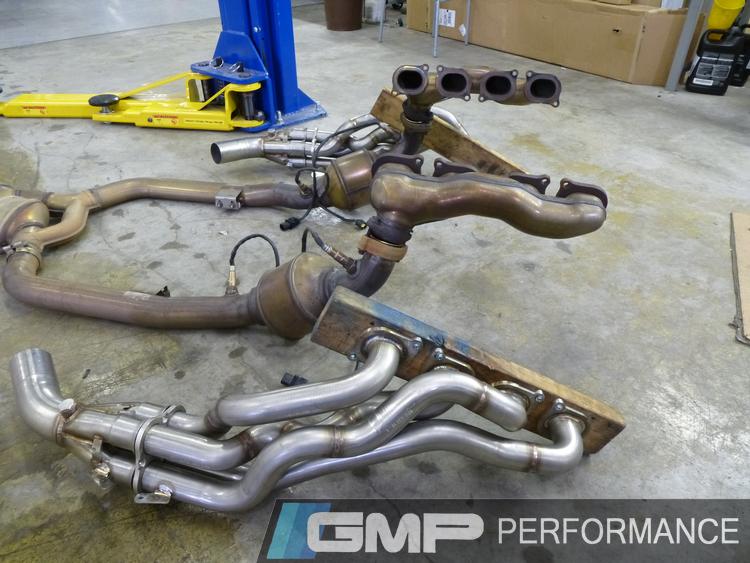

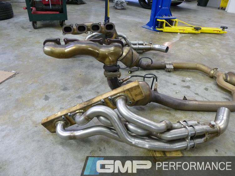

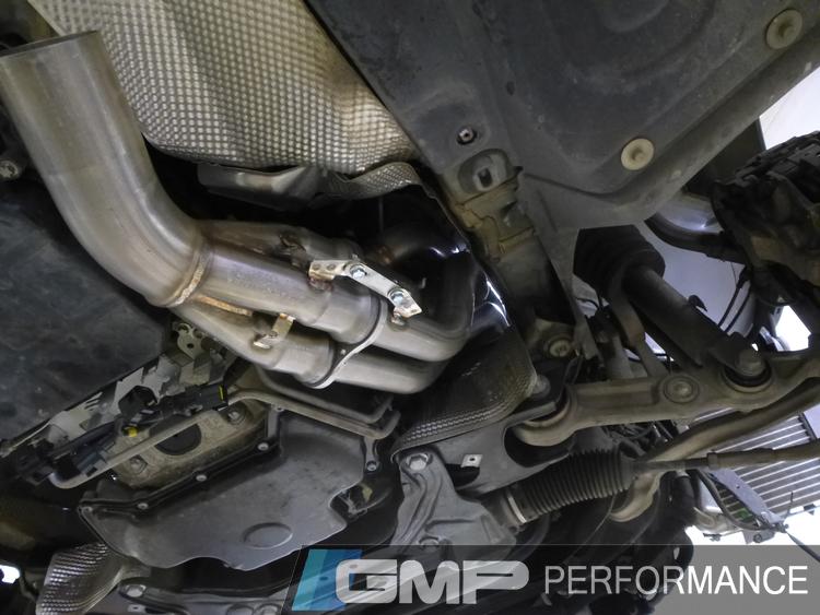

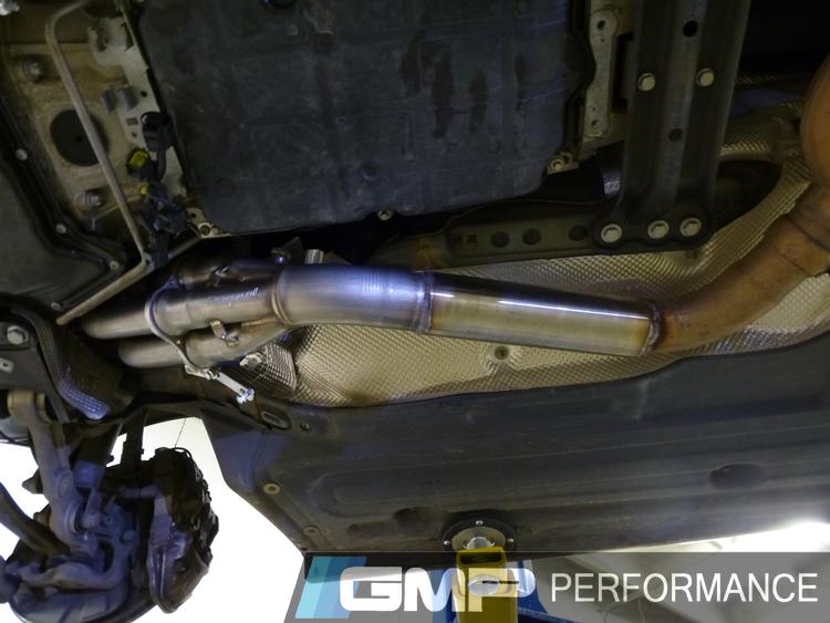

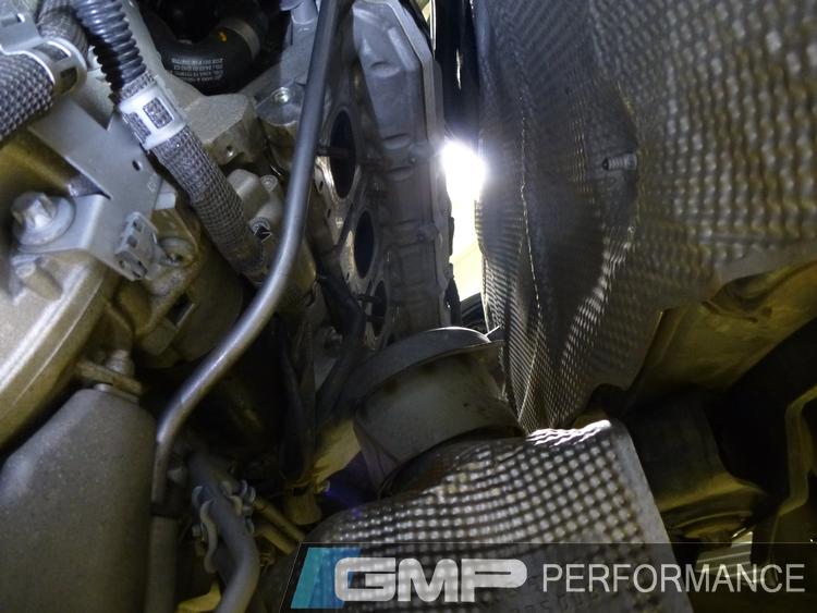

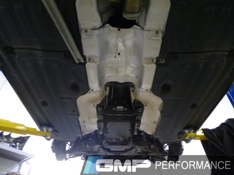

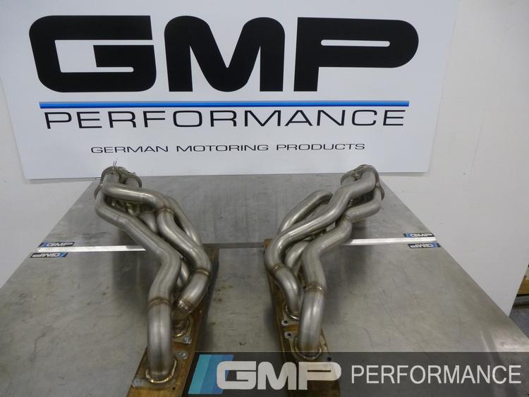

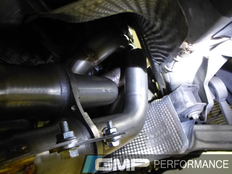

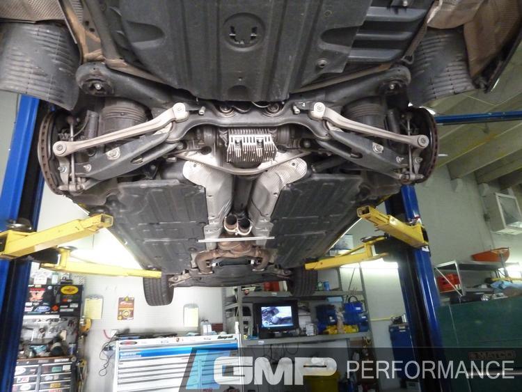

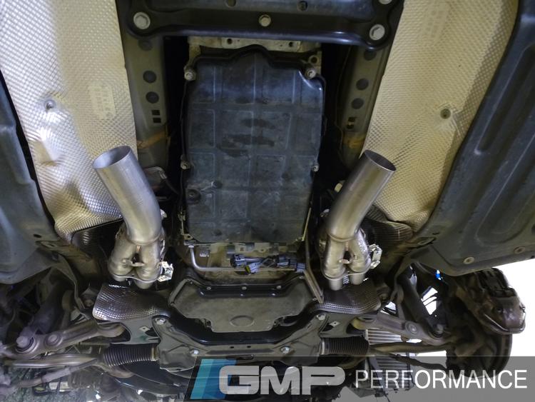

Kleemann long tube headers

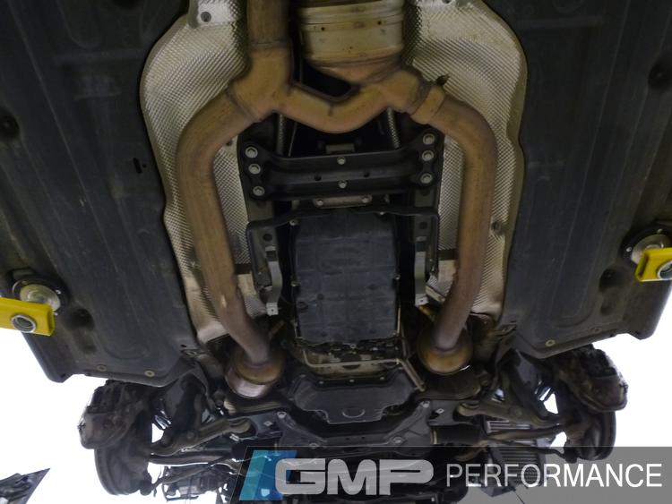

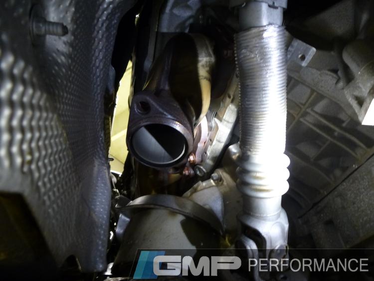

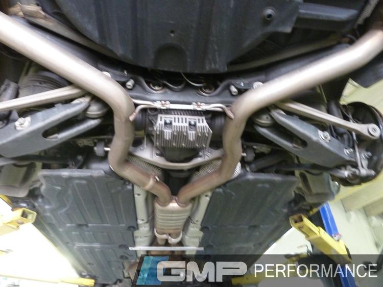

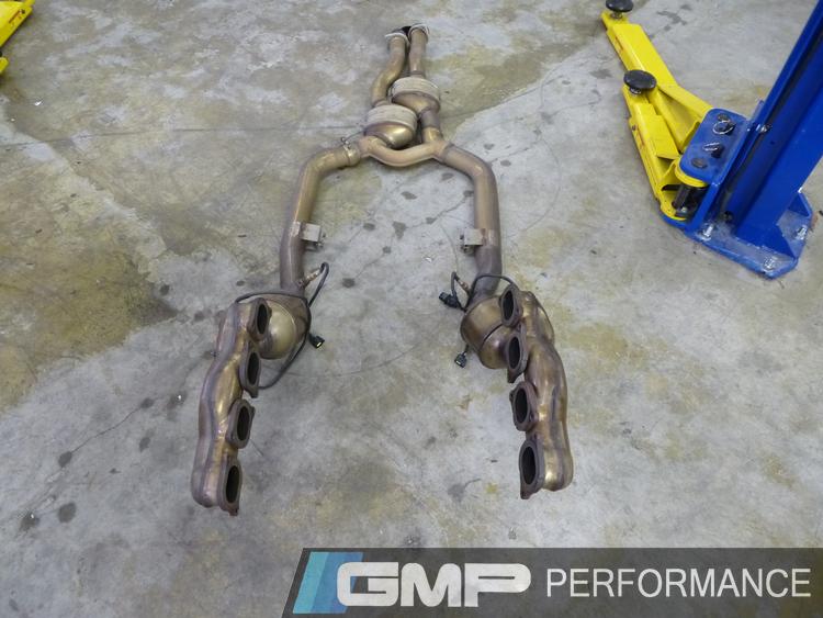

OEM Exhaust
Cats and Resonators removed

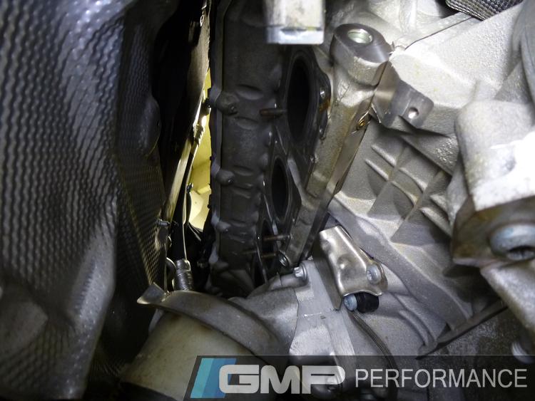

Manifolds removed
OEM Exhaust Removed
OEM versus the new Kleemann
Time to start getting it all in

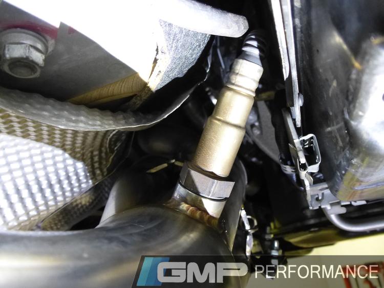

O2 Sensor Installed
All Installed

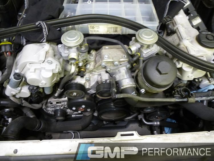

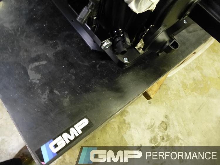

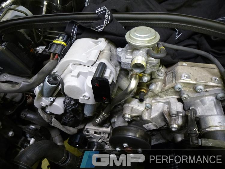

Supercharger!

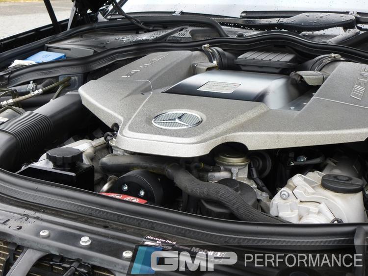

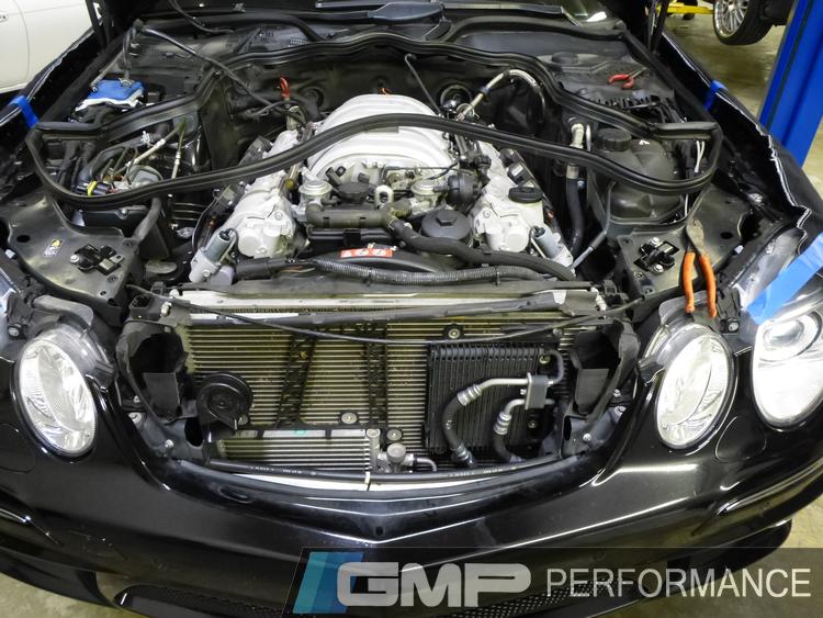

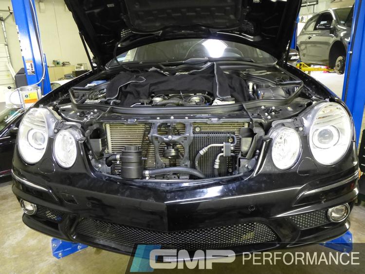

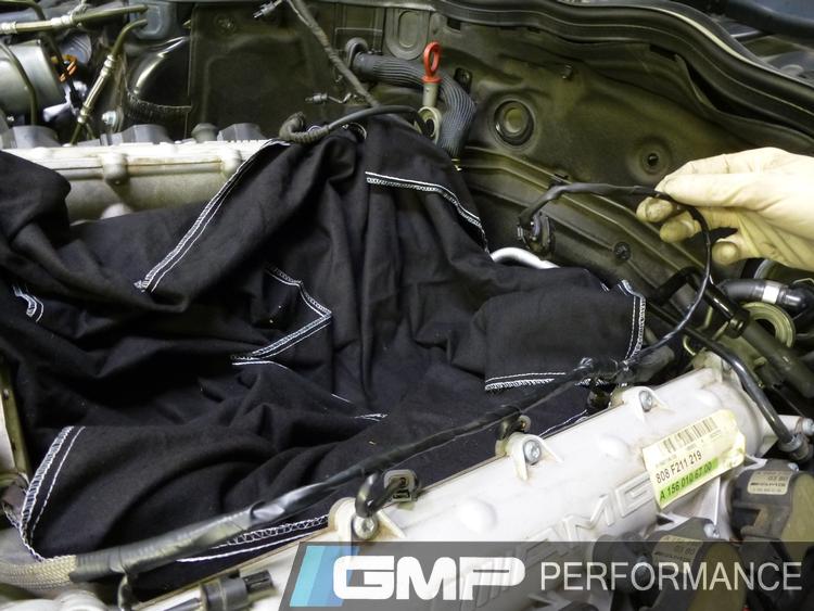

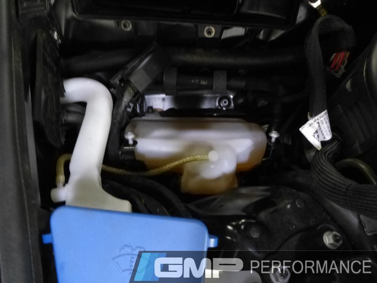

Engine bay before supercharger install

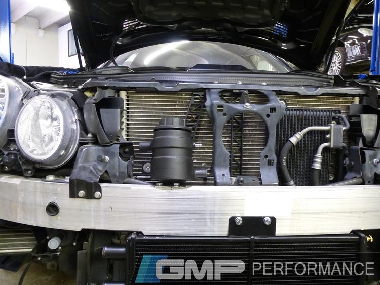

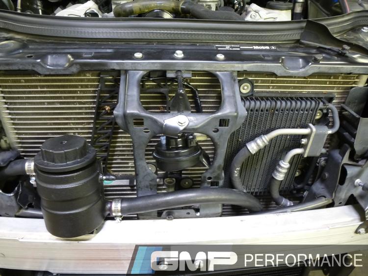

Engine covers and radiator support removed

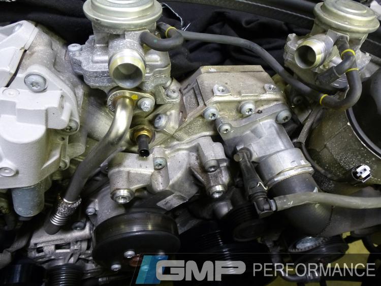

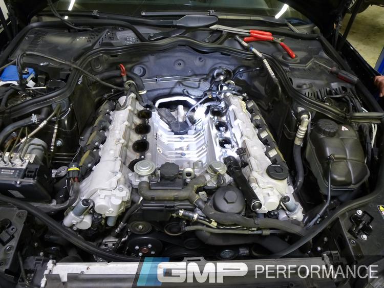

Intake removed

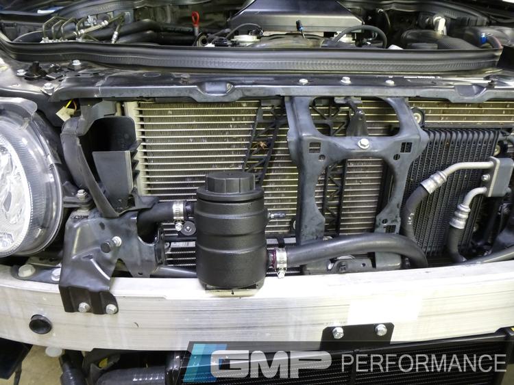

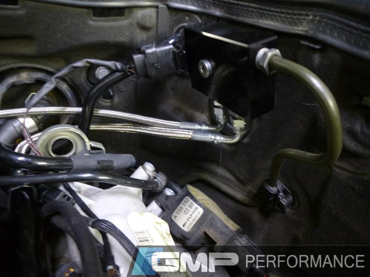

Power steering tank and lines removed

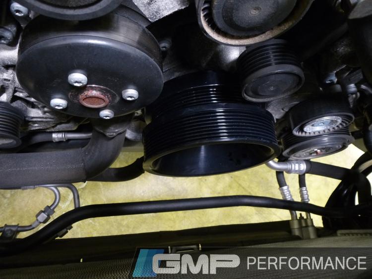

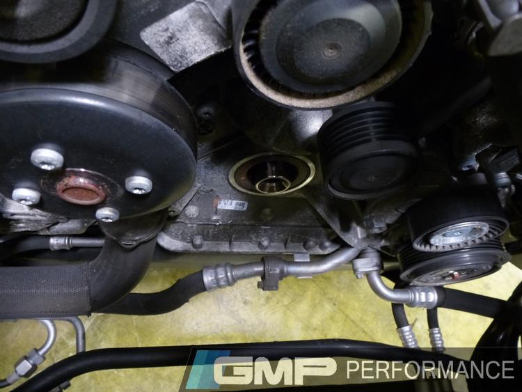

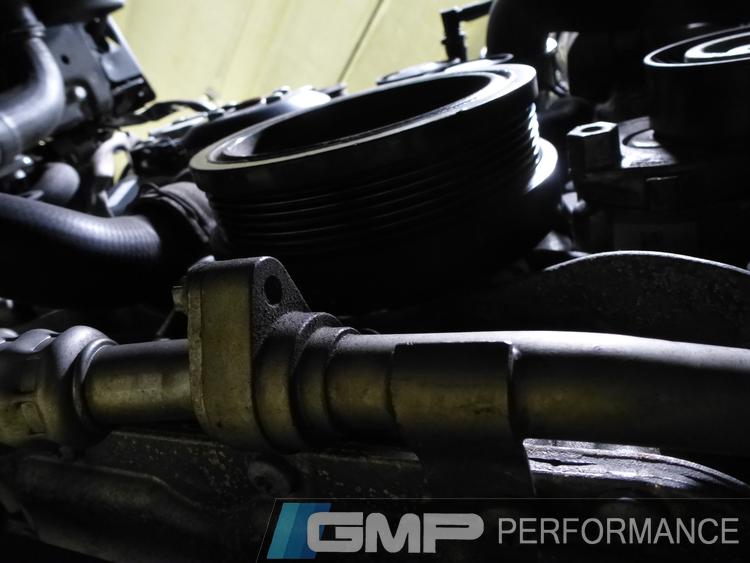

Removing OEM crank pulley
Kleemann crank pulley installed
Idler pulleys removed
Supercharger tensioner bracket installed
Power steering tank bracket installed

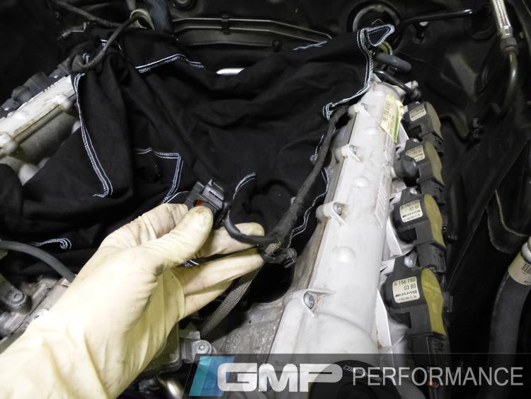

Fuel pressure sensor harness relocated to rear of engine bay

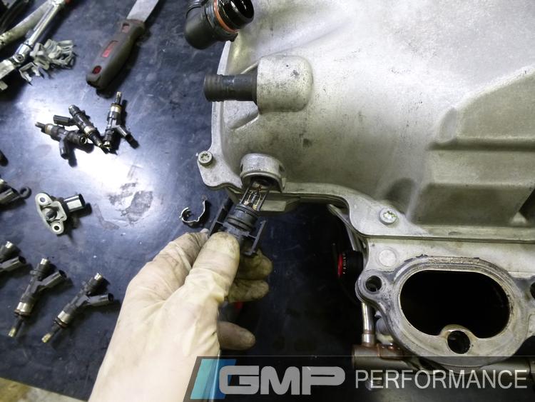

Air intake temp sensor removed
MAP Sensor removed

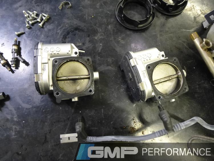

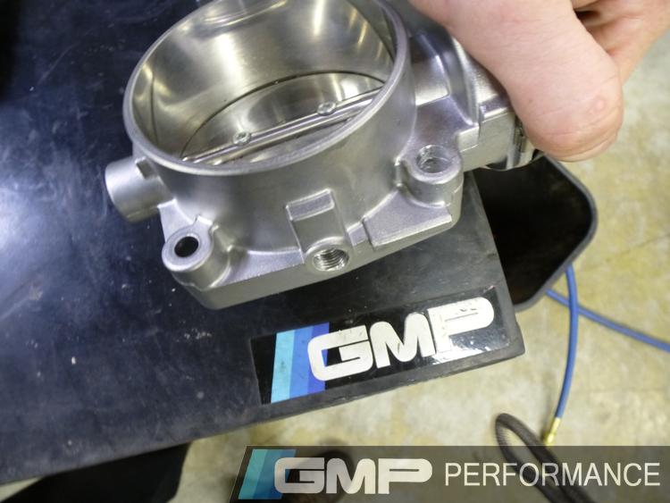

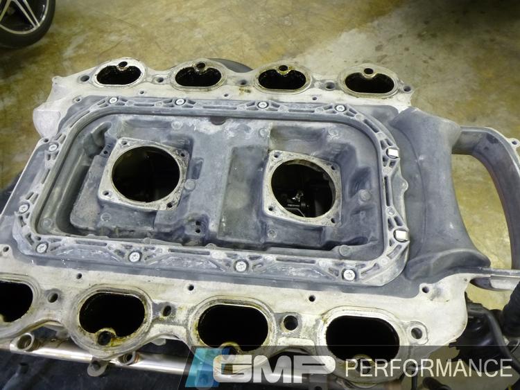

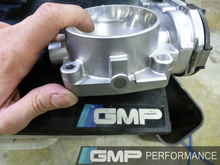

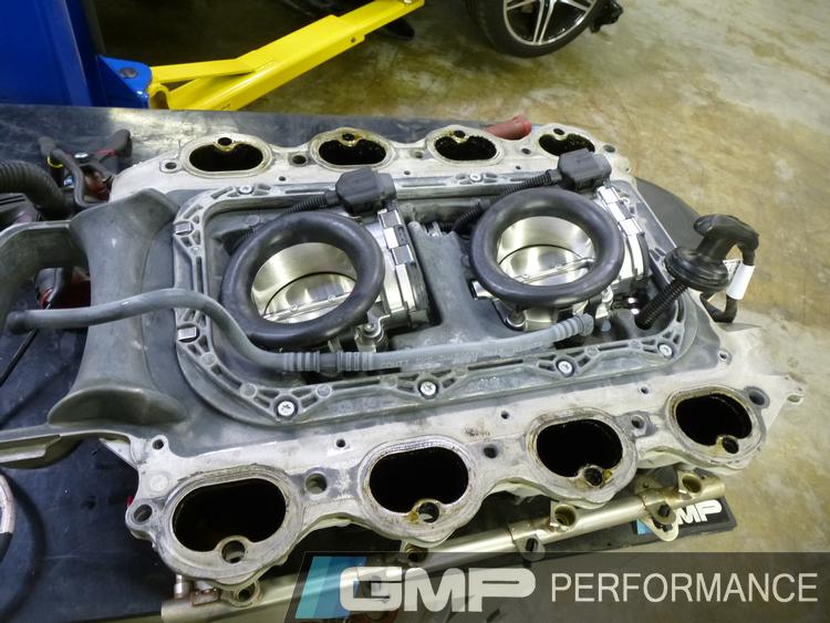

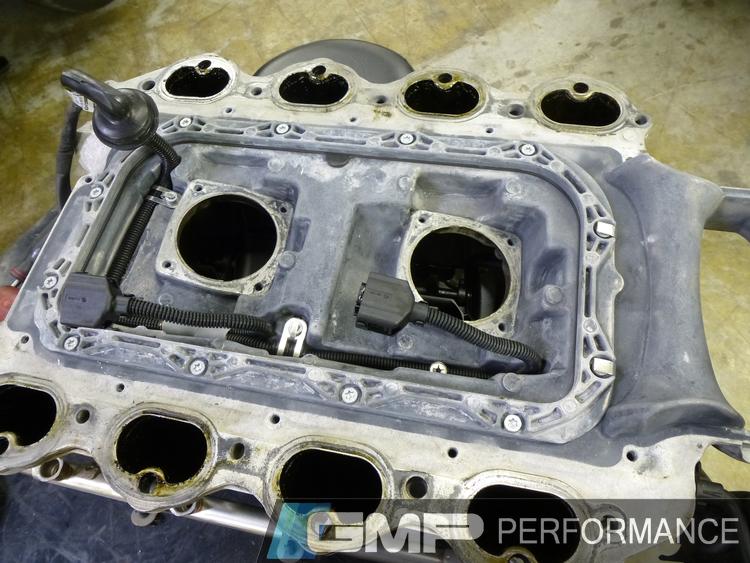

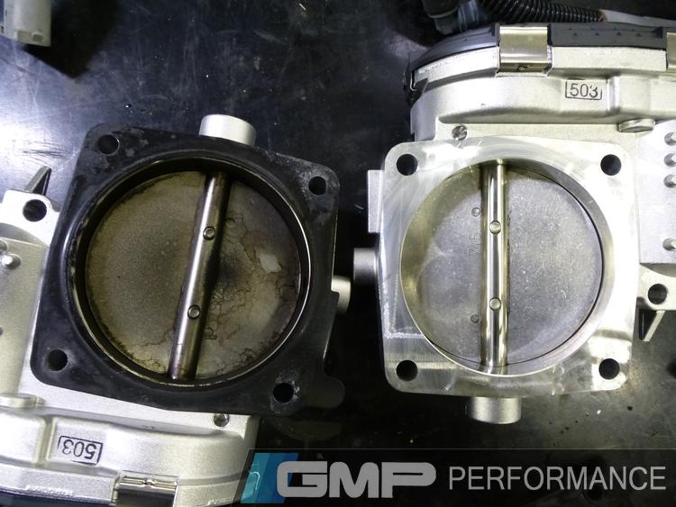

Intake plenum opened up to expose throttle bodies

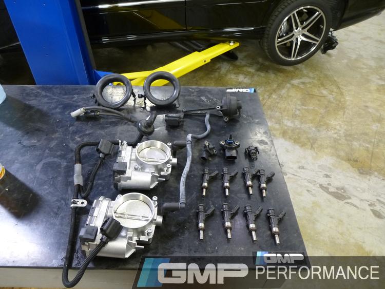

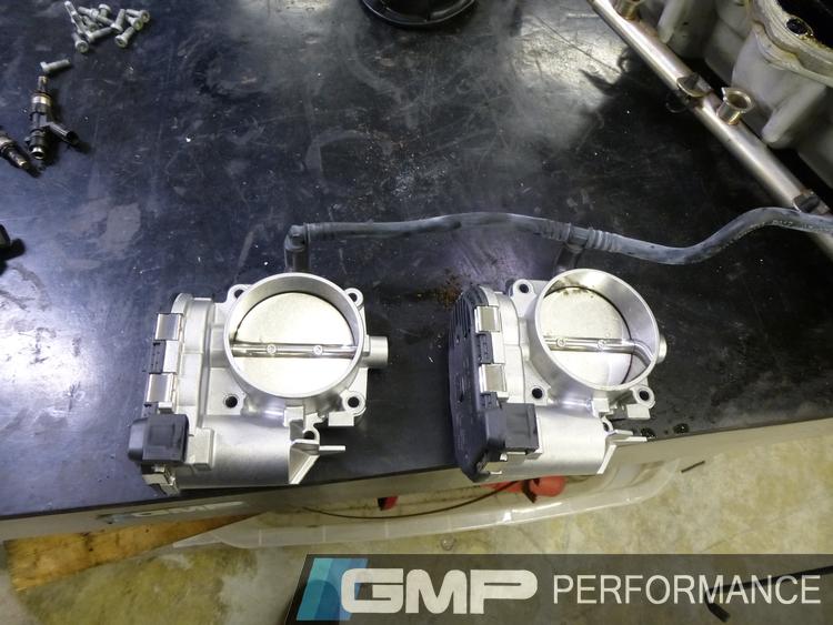

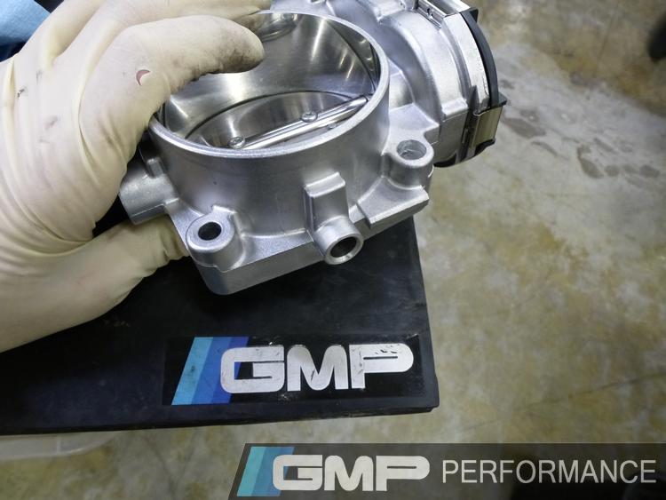

Throttle bodies removed

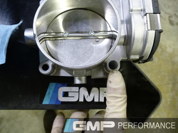

Right throttle body after hand cleaning compared to before
Throttle body wiring harness removed
All parts removed from intake cleaned, inspected and ready to be reused

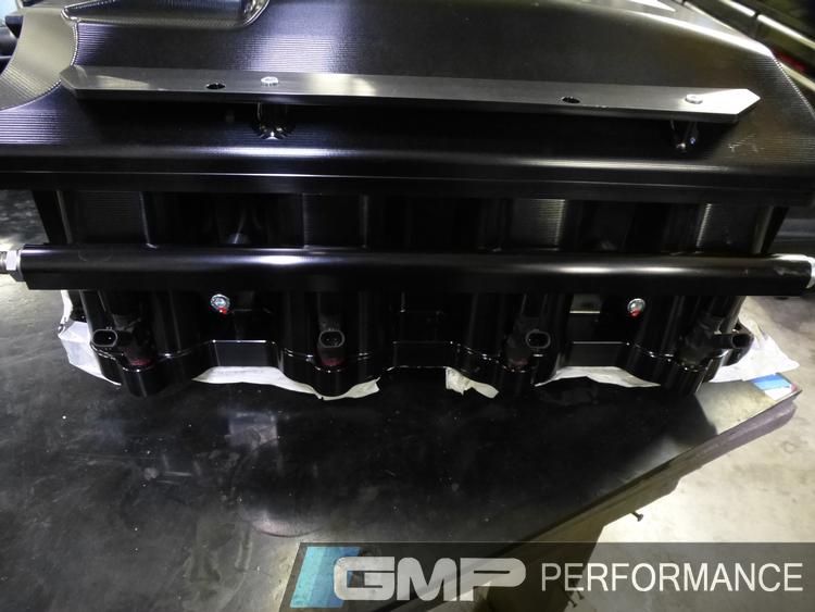

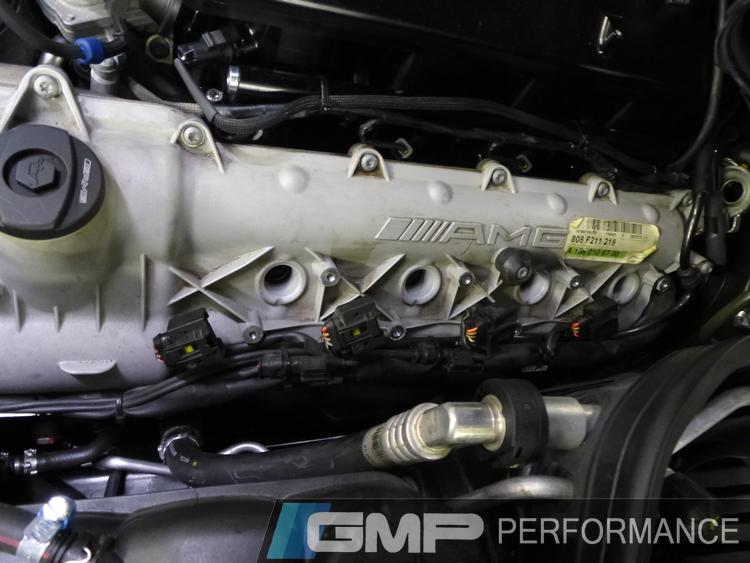

Fuel injectors installed
Air intake sensor installed
Hole enlarged for installation on supercharger
OEM Bleed port cut down and taped for plug
Air bleed hole plugged

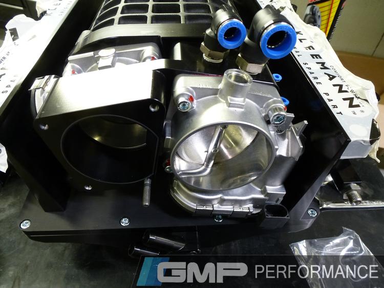

Throttle bodies installed on charger unit

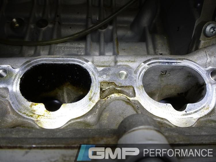

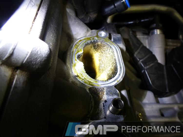

Intake ports getting a good cleaning
Charger is mounted in

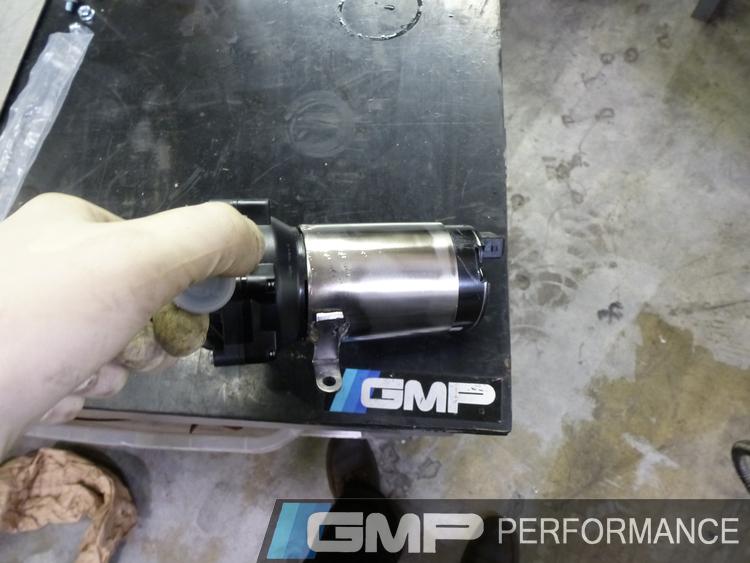

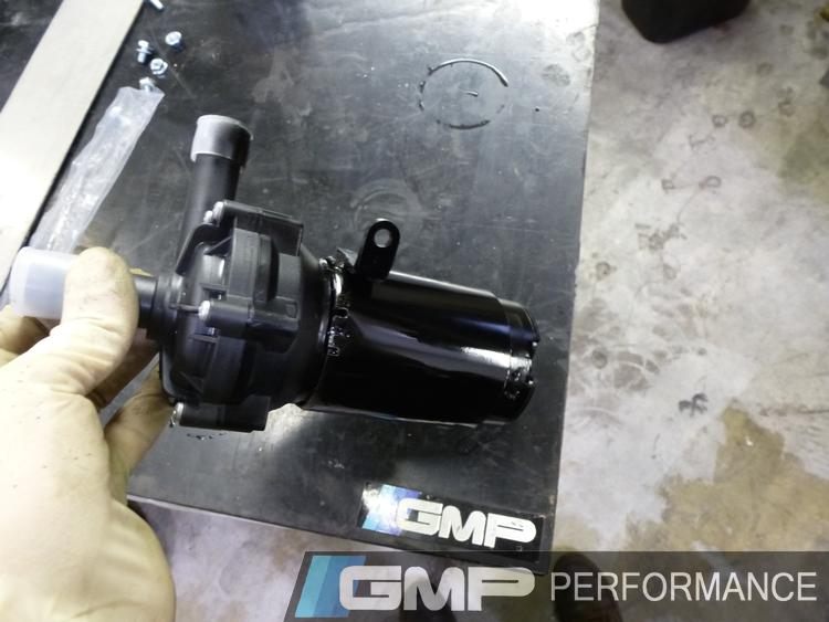

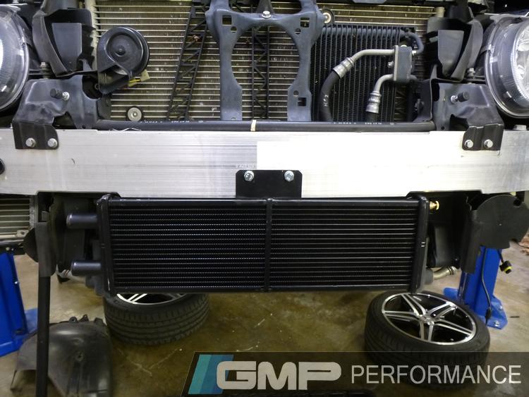

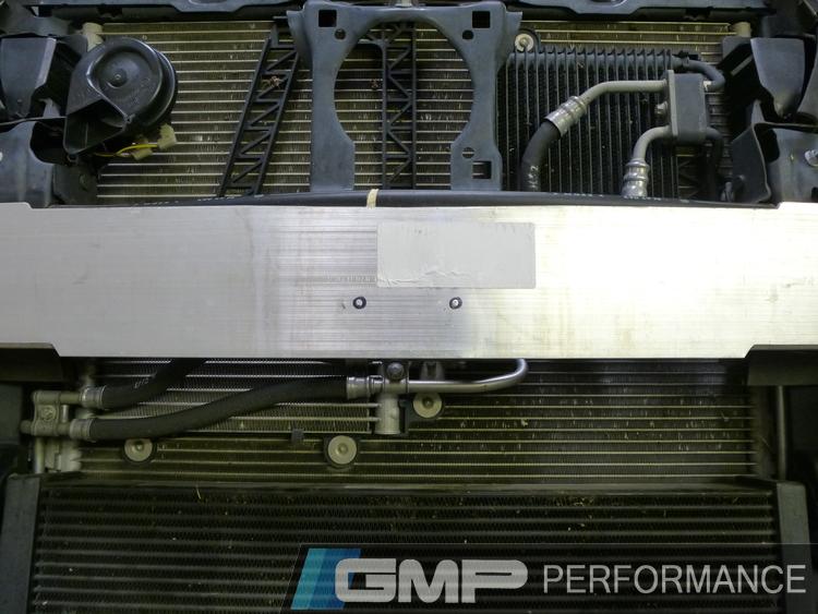

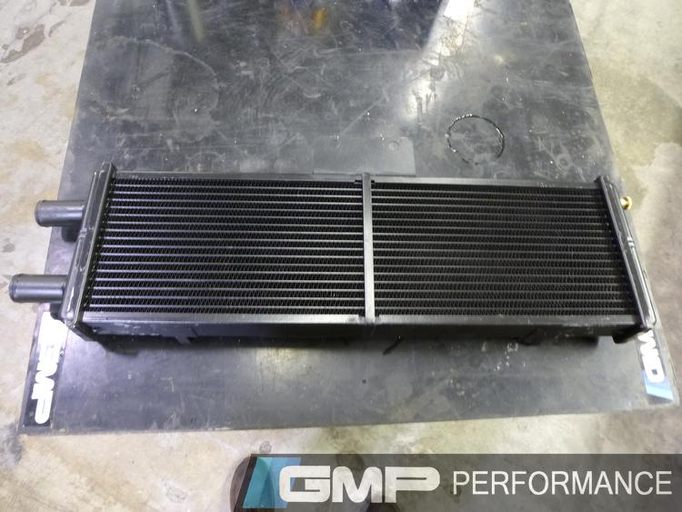

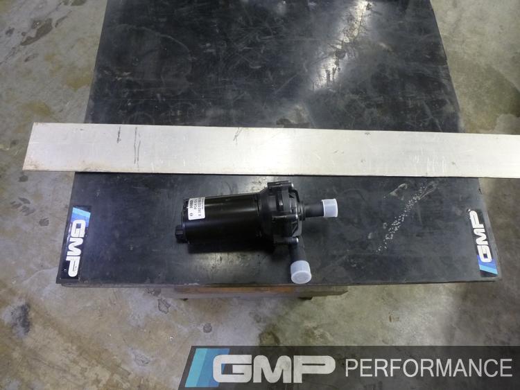

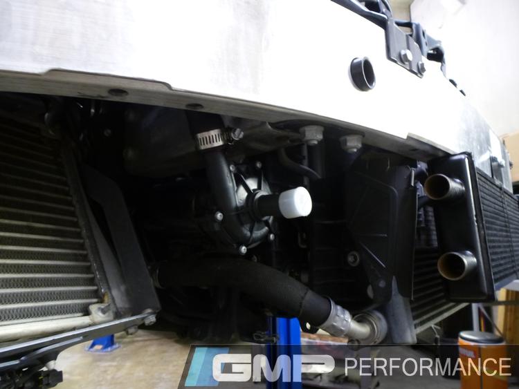

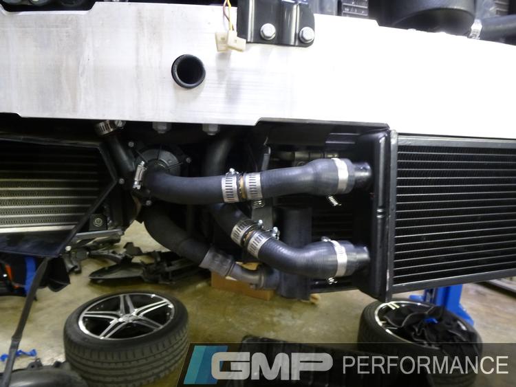

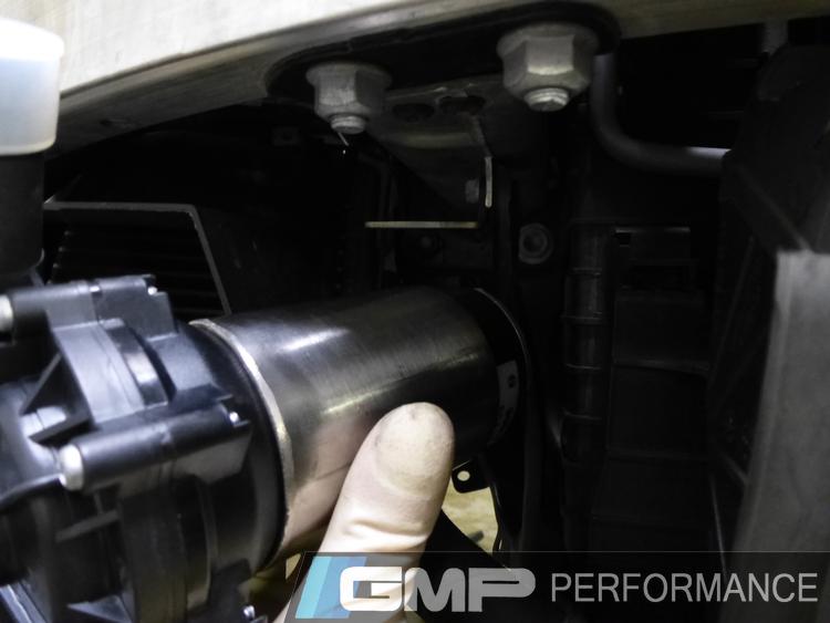

Supercharger radiator water pump and the custom bracket we made
Low profile supercharger radiator
Fuel lines connected to fuel block
Radiator and water pump installed

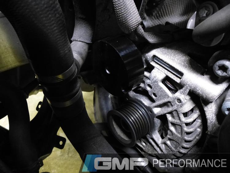

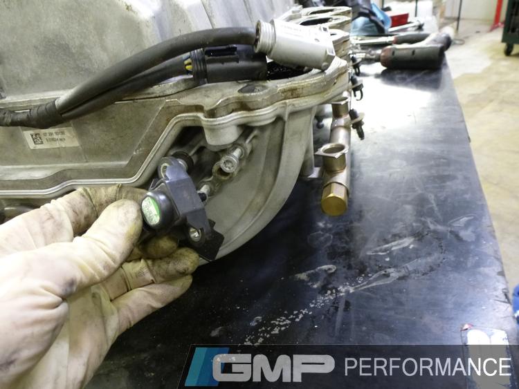

MAP Sensor removed

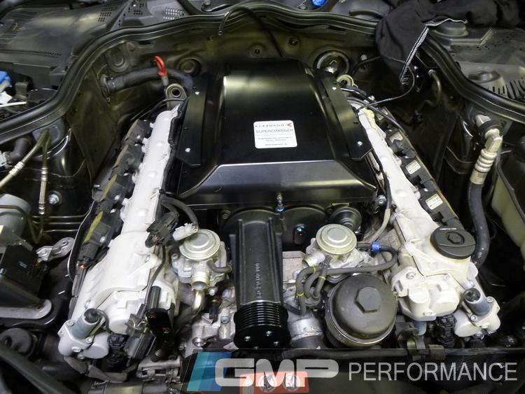

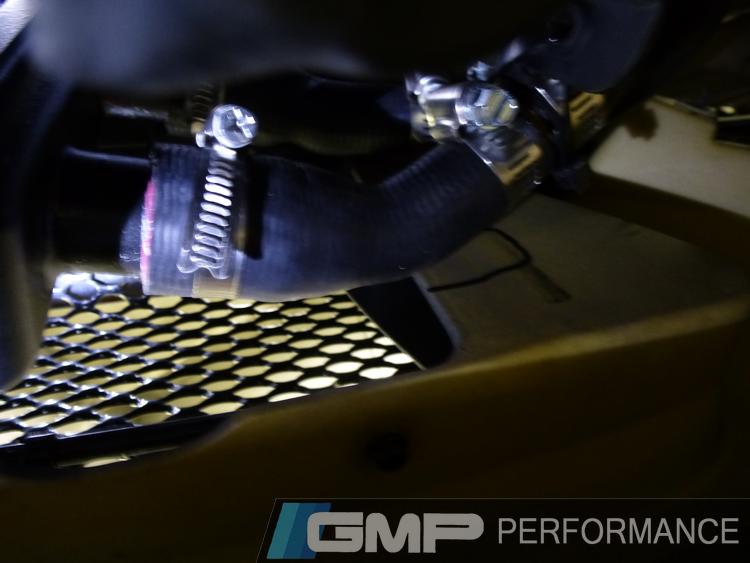

Horn removed and radiator tank installed
Coolant hoses routed and connected

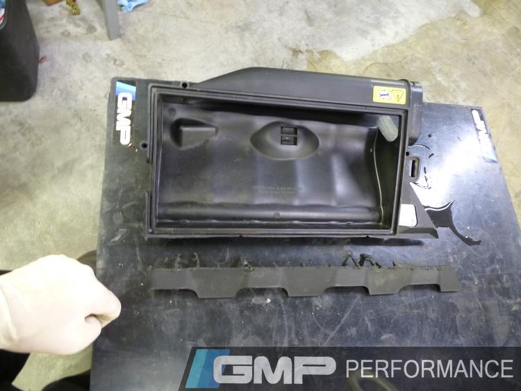

Air filter housing modified to fit over charger

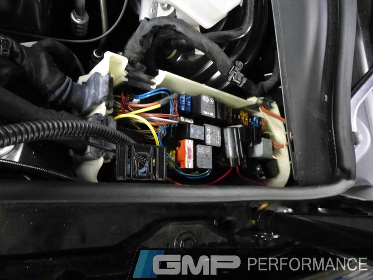

Wiring the water pump fuse and relay
Radiator coolant lines installed

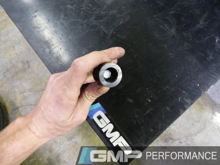

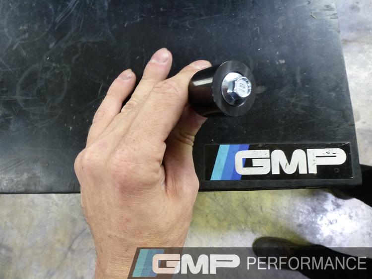

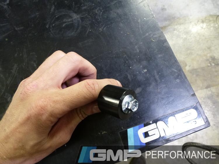

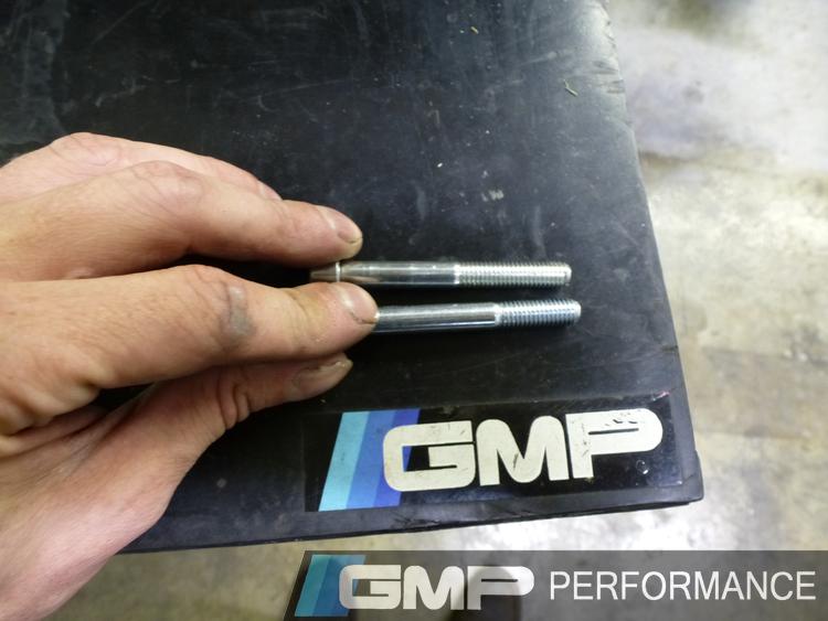

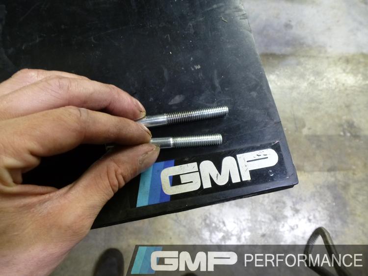

Bolt for new pulleys
Bolt sized to fit in hole
Not enough threads on new bolt so we went ahead and machined some more!
Charger pulleys and belts test fitted

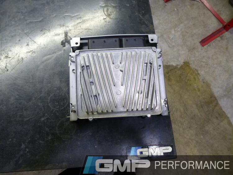

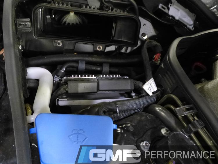

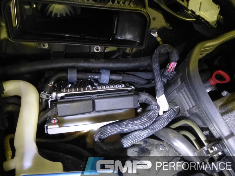

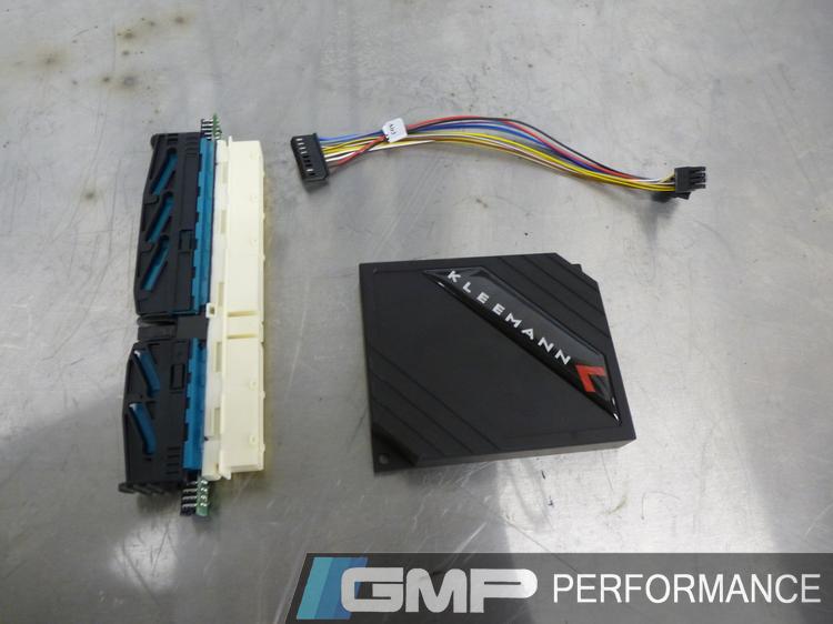

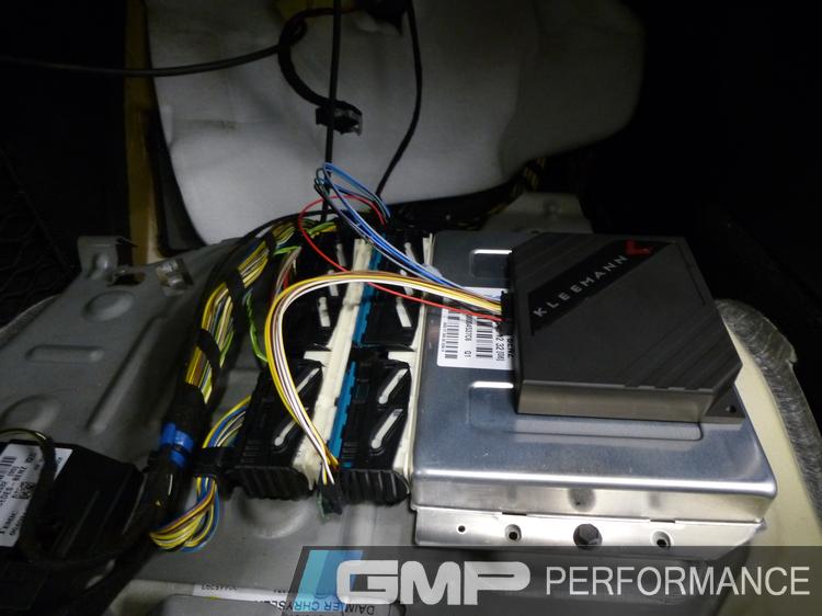

Pulling the ECU for programming

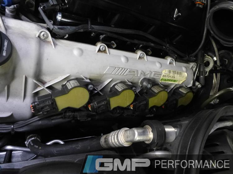

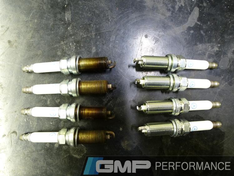

Changing spark plugs

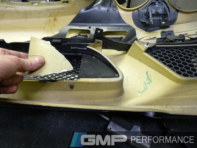

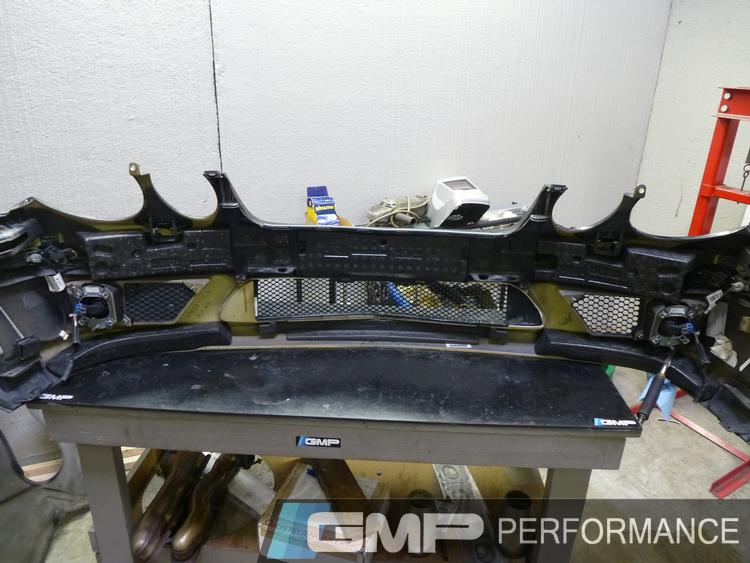

This is where we found out that the front bumper cover would need more clearance for all the hoses.
Nothing to worry about! With some careful trimming, we cut away enough space to allow that room.
All foam inserts back into the bumper cover

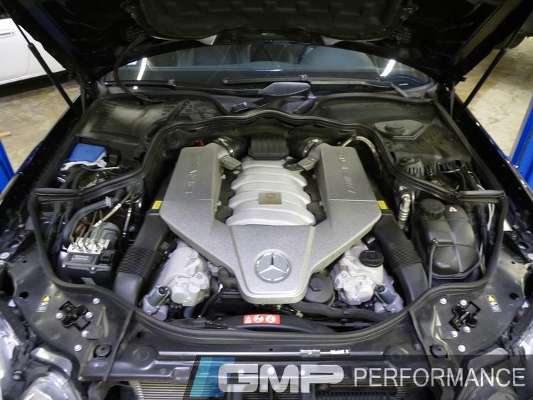

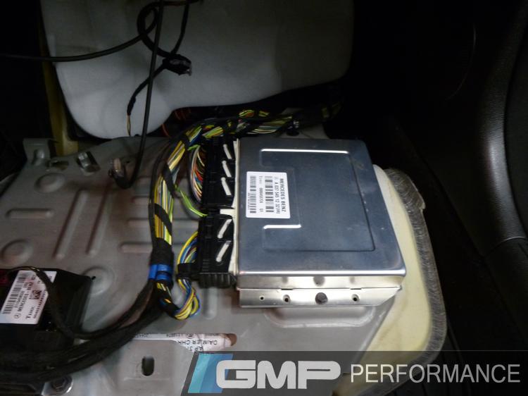

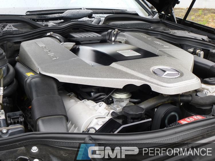

Bumper, ECU and engine covers all get placed back in
And just like that, this 2008 E63 has morphed into something new, something incredible. Anything rocking that AMG badge is already a stout, powerhouse of a vehicle but when you add the expertise of Kleemann to the mix, you know you're talking something special. Our client is ecstatic and in the end, that's what matters most. We still can't wait to get this bad boy back to do some dyno numbers with though!
