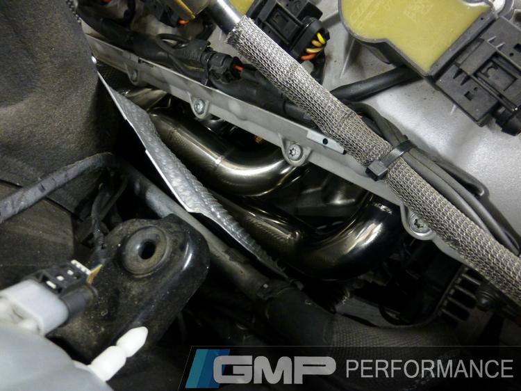

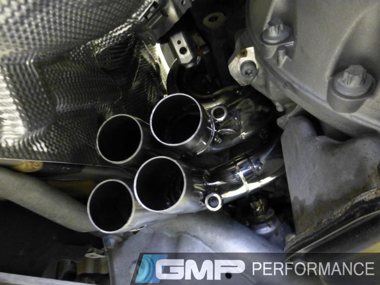

Kleemann Long Tube Headers

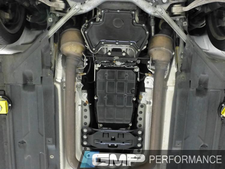

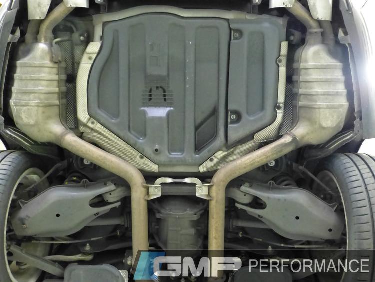

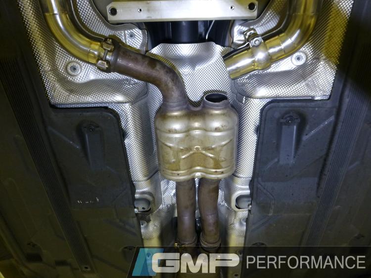

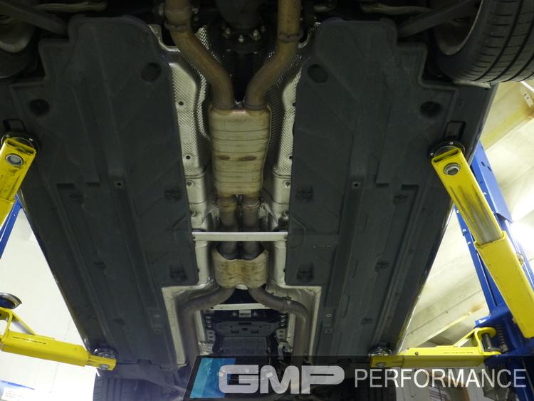

OEM Exhaust
http://gmpperformance.com/CFJFiles/G...3887-20202.jpg

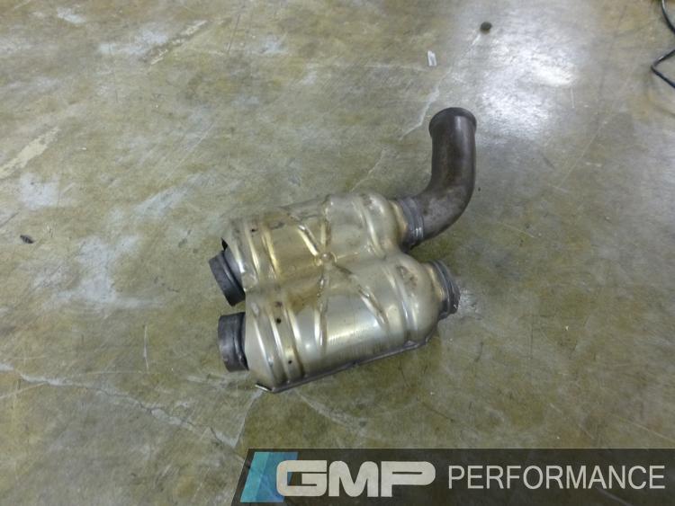

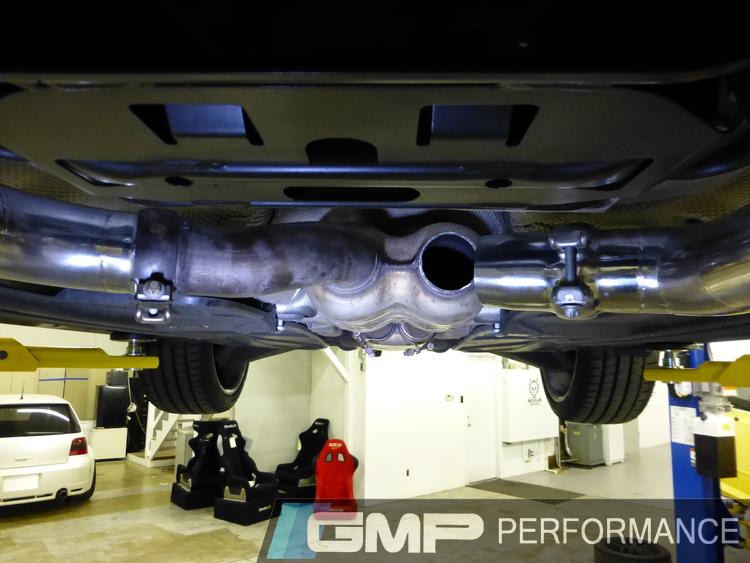

Cats removed

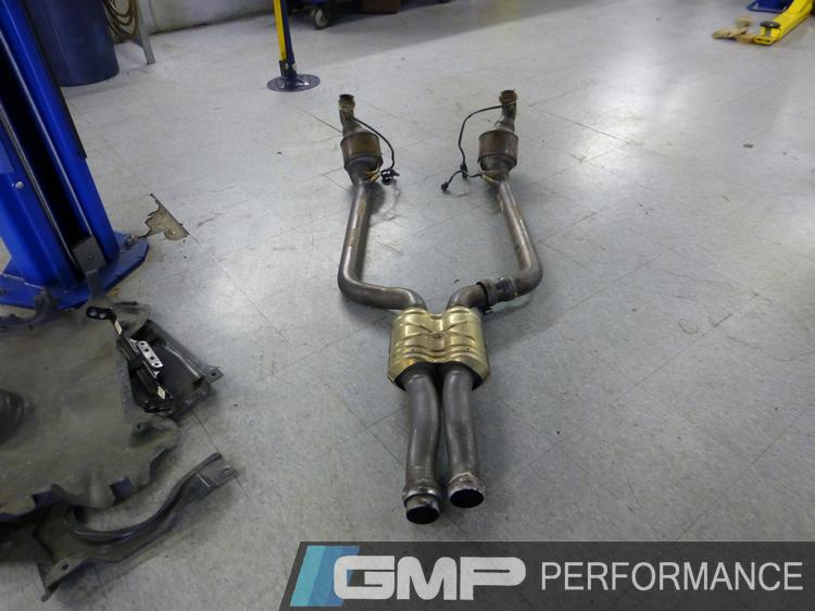

Oem exhaust with cats

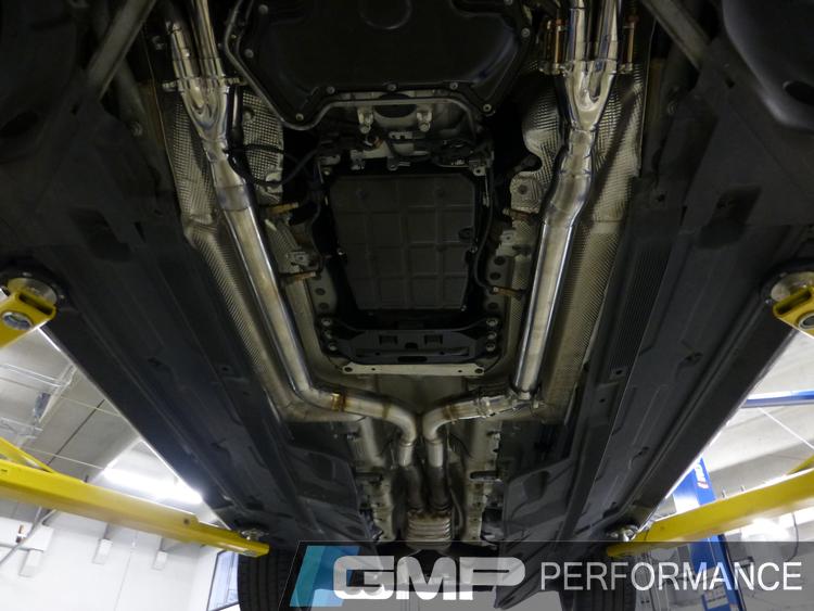

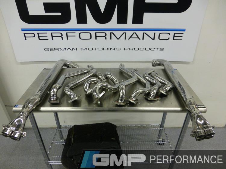

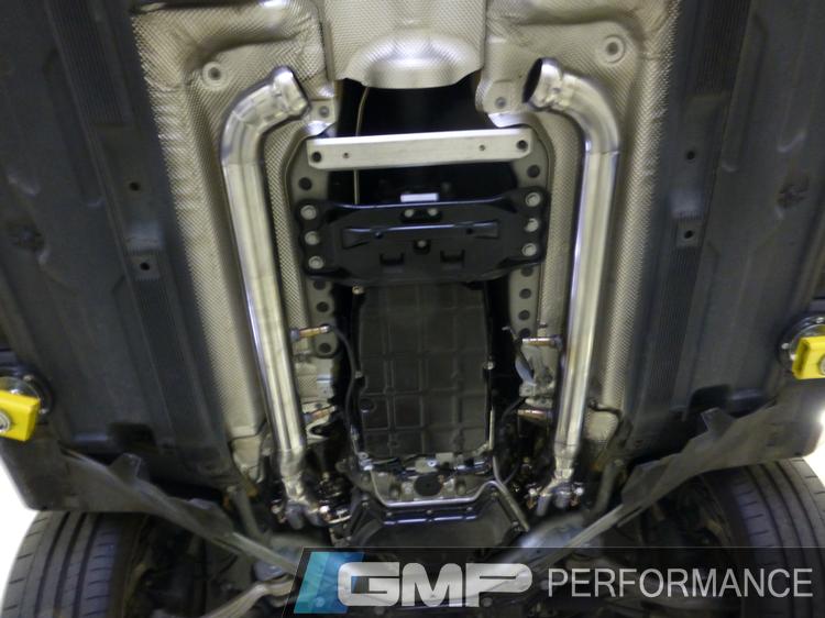

Kleemann long tube headers
Left side header pipe being test fitted
Right side Kleemann headers installed

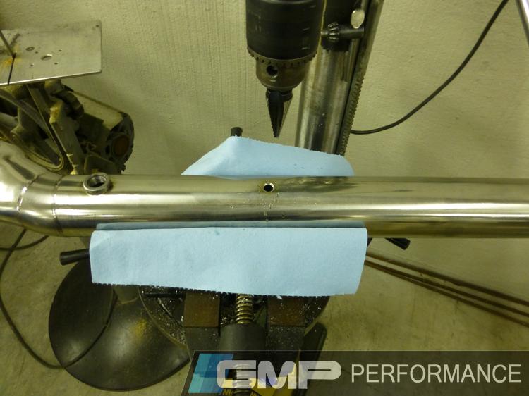

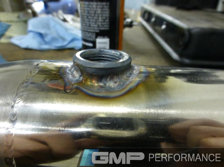

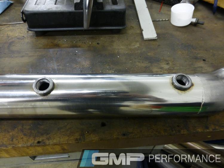

Installation of oxygen sensor bungs
Exhaust collectors installed with oxygen sensors

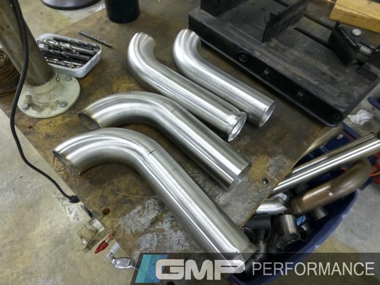

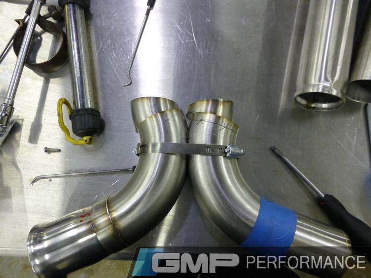

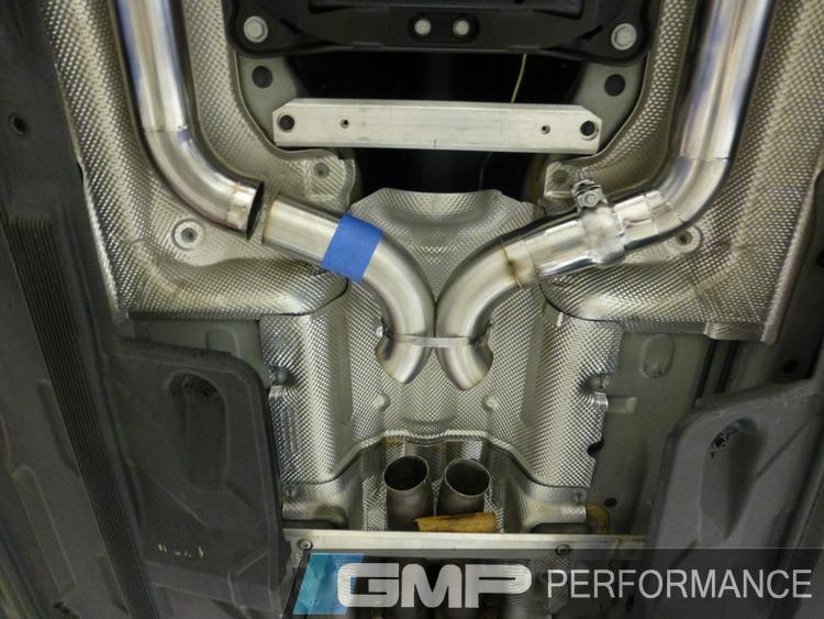

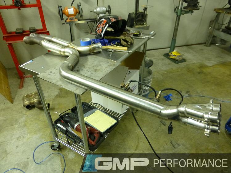

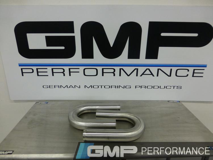

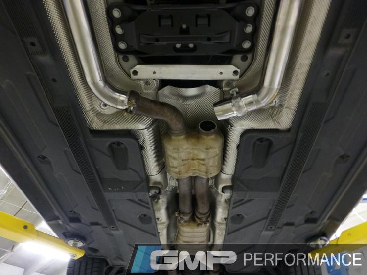

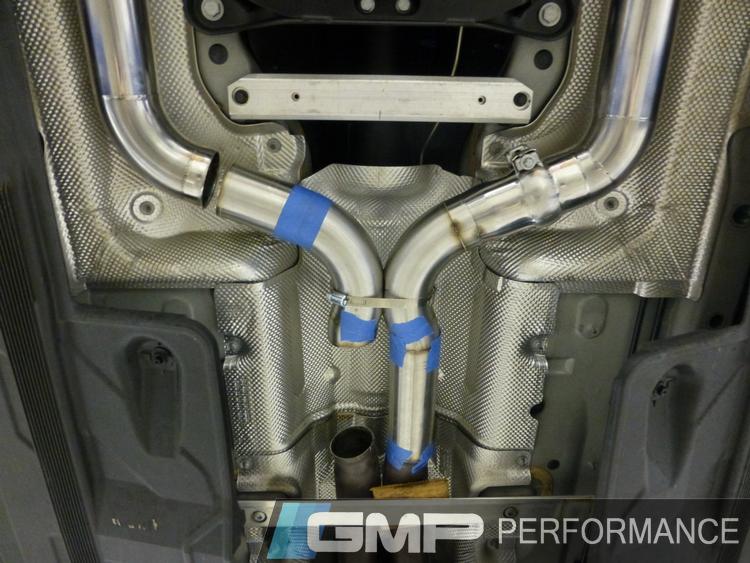

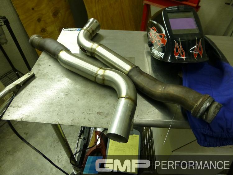

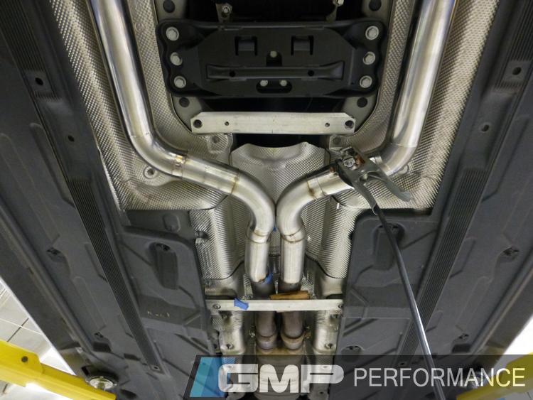

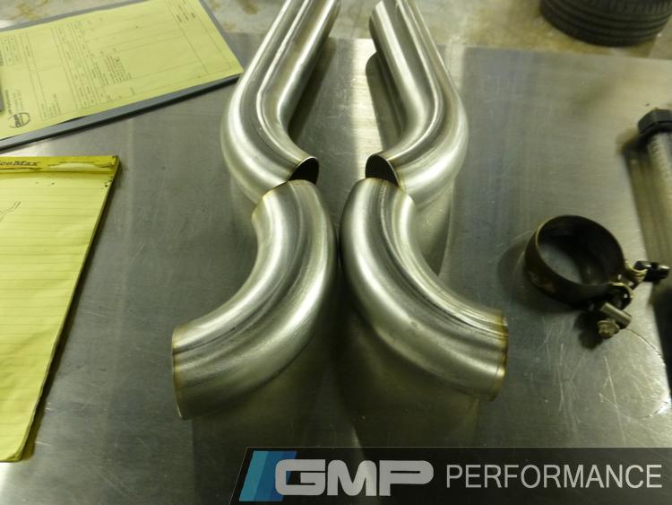

Custom X-pipe and center muffler delete
Stainless Steel U-bends

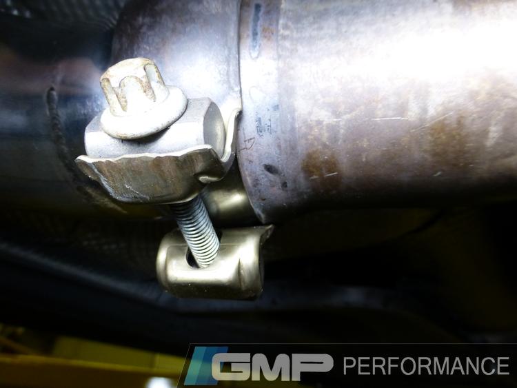

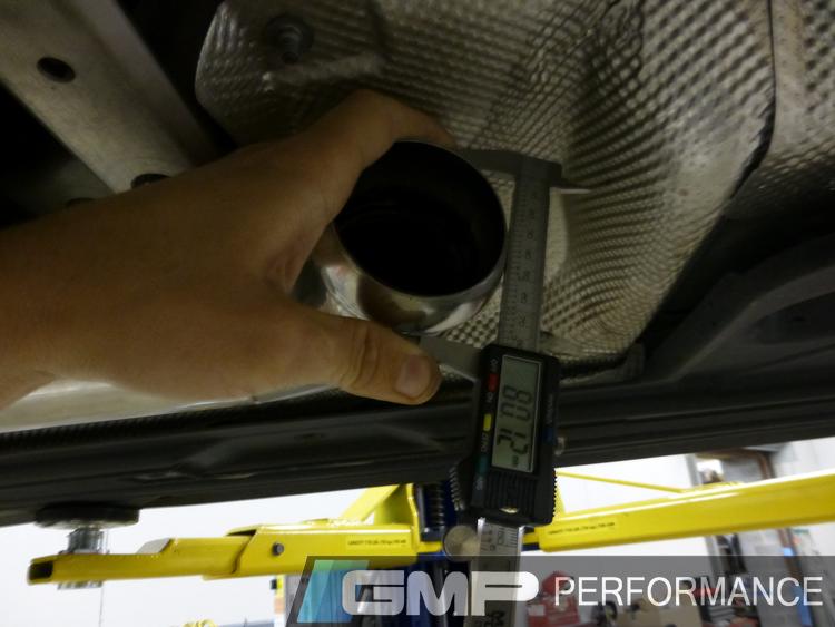

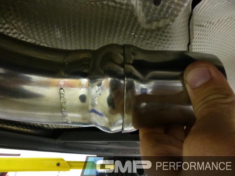

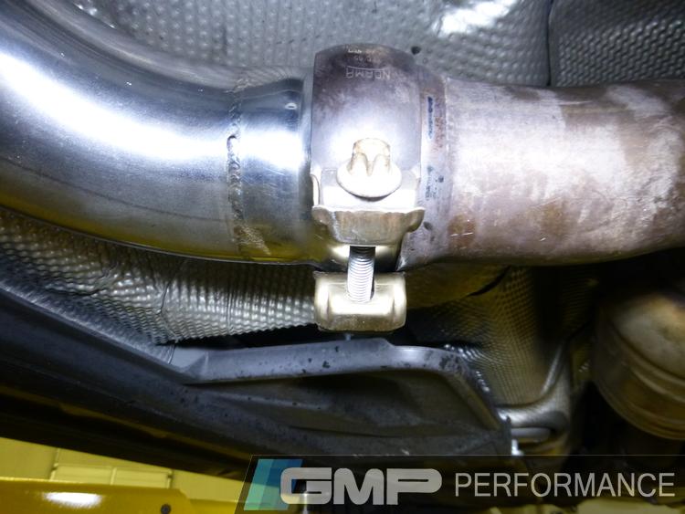

With drivers side pipe removed from stock cat we test-fit the cat section to take measurements and found fitment issues with the headers.

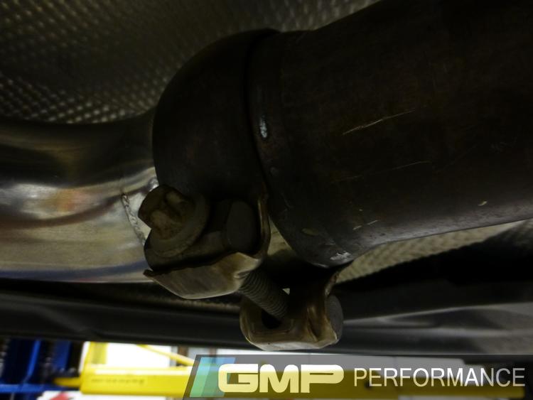

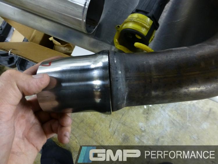

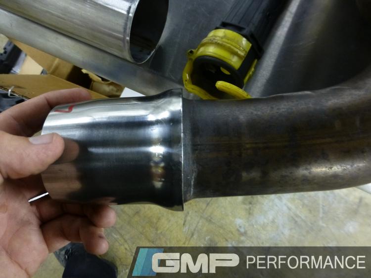

The ball seat on the Kleemann header is too large for the stock socket to fit
You can see here how the socket will not sit on the ball correctly and this the clamp will not fit

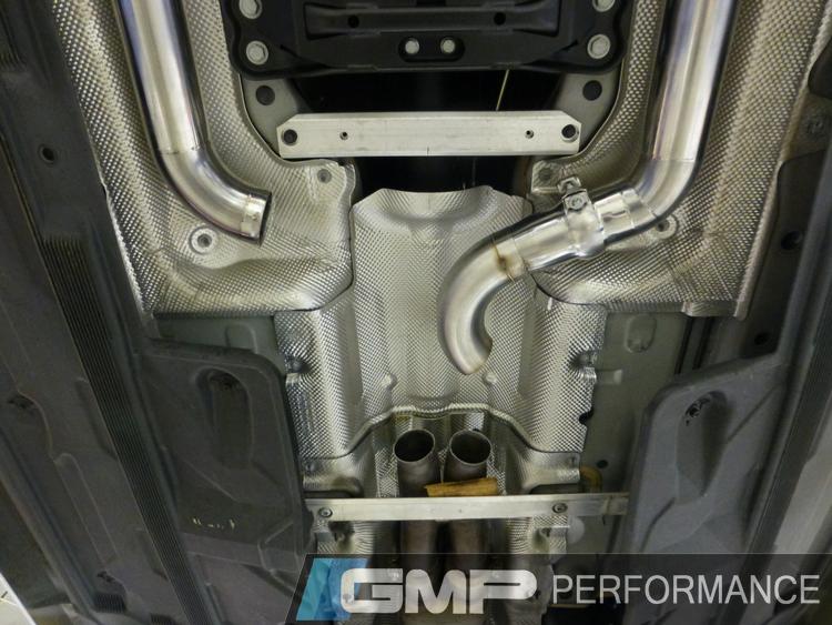

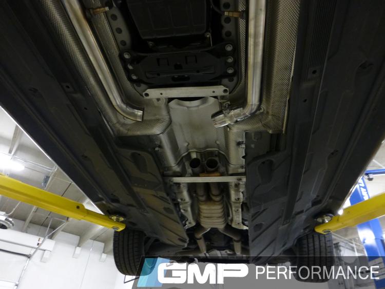

This illustrates how far to the drivers side the exhaust is being pushed by the Kleemann header

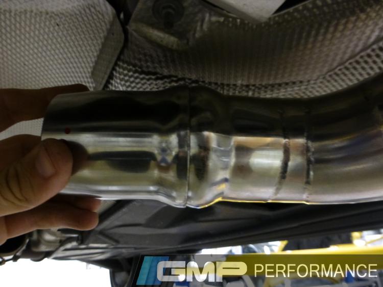

Kleemann adapter pipe fitted to drivers side (where it belongs)
Kleemann adapter pipe fitted to passenger side to show that it fits the same

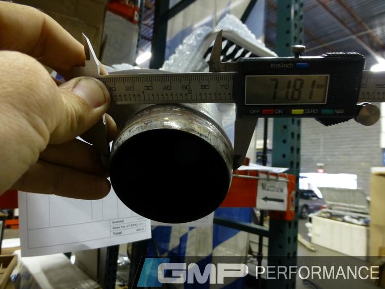

The Kleemann adapter pipe's socket is significantly larger than the stock one
The Kleemann adapter pipe's socket is significantly larger than the stock one, the stock pipe fits entirely inside the Kleemann one
