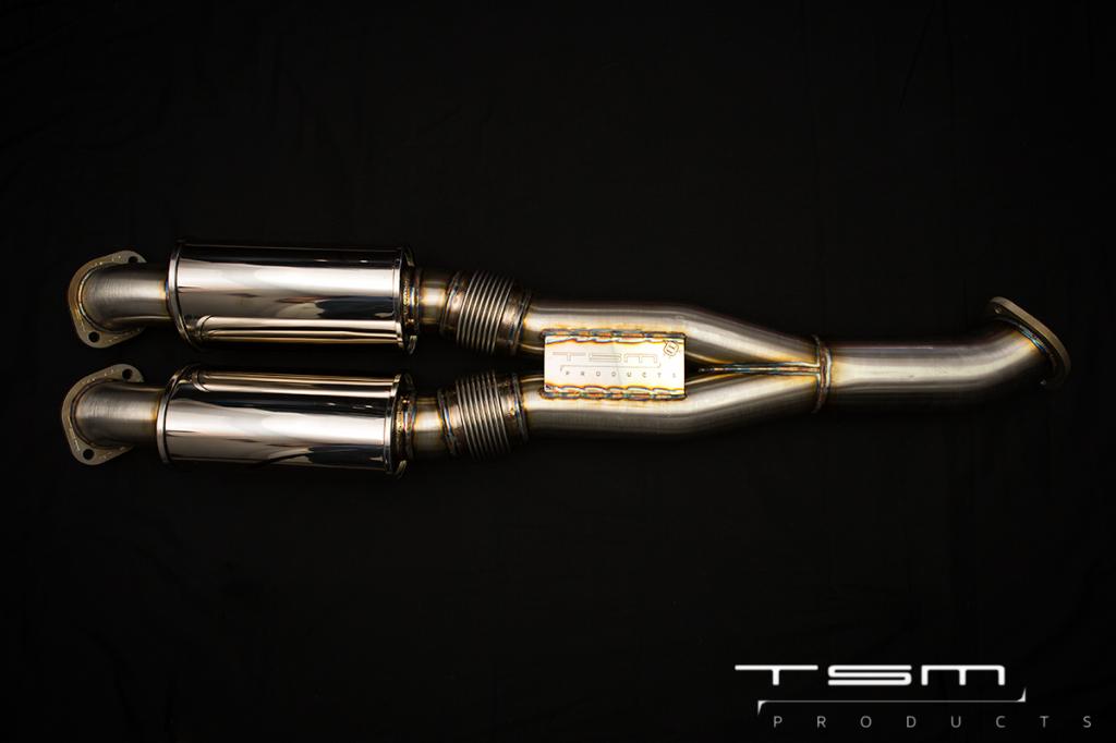

Check out the pictures below of both our resonated and non-resonated y-pipes. We have a full stock of both units on the shelf ready to ship. Please let us know if you have any questions at all.

Resonated and Non:
First off we wanted to offer both a resonated and non-resonated option allowing the customer to decide just how loud he or she wants the car. Our super quite dual resonated design cuts noise as good or better then any y-pipe on the market. These quiet mufflers cut the drone out of almost any exhaust system. They also retain their packing for much longer then some of the less effective units on the market. That means that your car retains the same nice quiet tone throughout the life of the y-pipe instead of the car getting louder over time.
Bellows vs. Mesh Flex
Furthermore we turned the industry upside down in order to find 3" stainless steel bellow flex units rather than the traditional mesh style units. We have found over time that the web style flex sections break down and ultimately can cause small exhaust leaks. Not only that but most stainless flex section have mild steal crimps which over time can rust which causes further deterioration of the unit.
321 Stainless Flanges
We purchase in bulk 321 vs. traditional 304 stainless steel for the flange material. 321 Stainless has a higher nickel content then 304 which is not only stronger but also creates a much better mate to the tubing. The end result is a flange that is FLAT, will not warp during the welding process at all and stays consistant through time and with heat cycles.

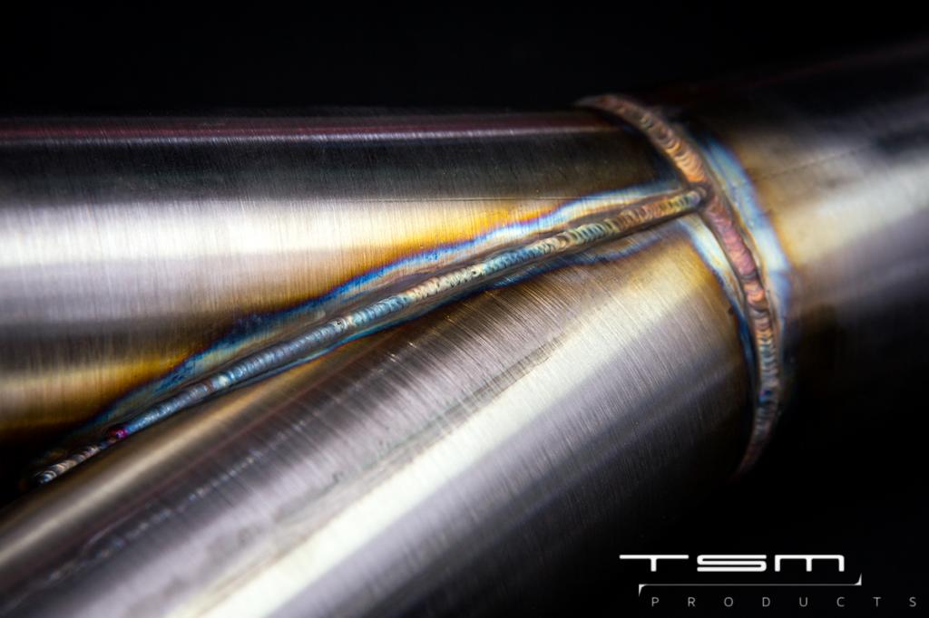

The Merge
We do not buy pre-made merges for these units. Every 90mm merge is fixtured and cut in house then tack welded together for hand smoothing and port work. They are then welded together by hand in order to guaranty a seamless transition.
Internally & Externally Welded Flanges
Each flange is welded onto it corresponding pipe both from the outside and the inside walls of the tubing. The welds are then hand ground on the interior of the pipe and ported smooth. This allows the exhaust exiting the downpipes to flow into the pipe with absolutely zero restrictions! The transition is smooth and without obstruction once the pipe is bolted on.
Back Purging
Back purging is a process used in welding any exotic material that is susceptible to oxygen or any other contaminants I.E Stainless Steel, Inconel and Titanium. There for; cleanliness is key to producing a quality and reliable weld. When stainless steel is TIG welded, the molten pool on the weld side is protected by a shield of Argon gas to keep it from soaking up contaminants in the oxygen around it. In order to ensure a quality weld a “Back Purge” must be used. What this does is fills the inside of the tubing (or backside of the weld) with Argon gas to keep the oxygen out, or purge it from the chamber. This process not only strengthens the weld immensely but keeps all contaminants and oxygen away from the molten metal. The results is a weld that looks just as good on the inside as it does on the outside. When a back purge is not used in conjunction with stainless or other exotic materials the weld will soak up the contaminants in the oxygen making it porous, brittle and immensely less reliable. This will result in welds that will crack break or overtime deteriorate.
Included Hardware
We include RemFlex exhaust gaskets for both the runners and the primary pipes. These gaskets are much better than traditional metal exhaust gaskets. They are designed for a total seal and guaranteed not to leak at all. We also include grade 10.9 flanged bolts, washers and nuts. It is very easy to cheap out and cut corners on little things such as these, however every little detail is important to us when it comes to quality.
Below is a full list of the features of the new TSM Y-Pipe:
- 100% Made in house at TSM
- 90mm Primary w/ 76mm Runners
- High Flow/Minimal Angle Design
- Fully TIG welded with a sealed back purged process for maximum durability and strength
- Internally and Externally Welded flanges
- Hand Ported transitions from flange to flange
- Hand cut and assembled 90mm merge
- High Quality 304L .065 wall stainless steel mandrel bent tubing
- Proprietary 321 Stainless CNC water jetted flanges
- All flanges engraved with the TSM logo
- 3” Stainless steel bellows
- RemFlex exhaust gaskets (Guaranteed Not To Leak)
- Grade 10.9 flange bolts and nuts for install
- Each Y-Pipe comes with serial numbered name plate and (KILL)
- Life Time Warranty against cracking or build defects
