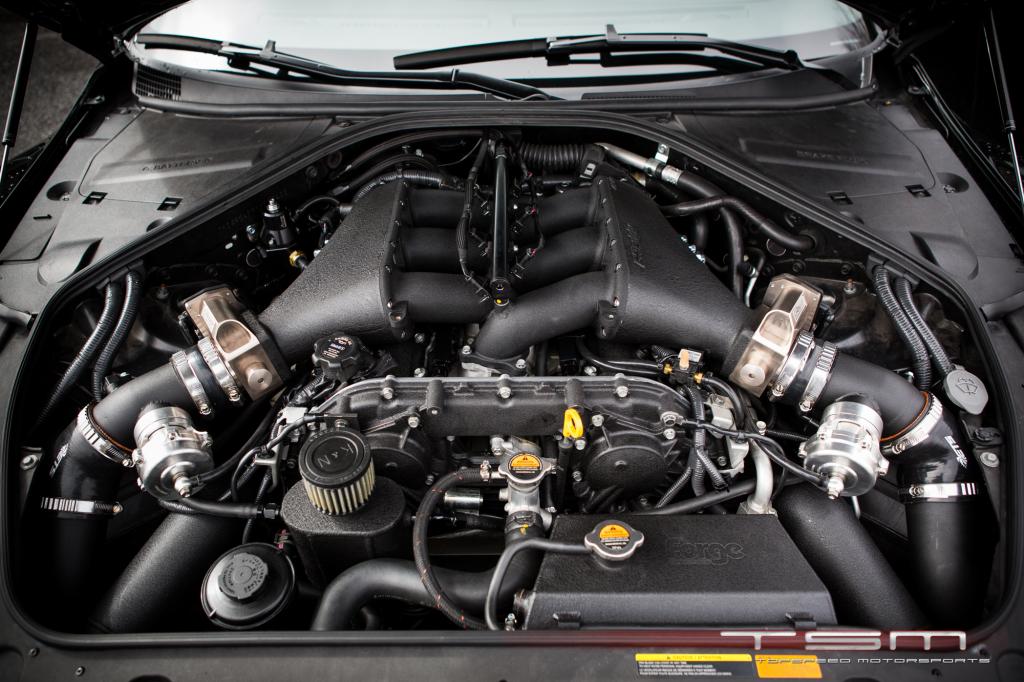

As I explain in the video below this is one of our iron sleeved, custom compression race engines. We have put tons and tons of development into our engine program in the last year which is something I have actually become very passionate about. This engine has our proprietary billet Diamond pistons as well as our in house developed block strengthening. The heads have Kelford components and are hand ported to TSM Race specs. The turbo system is an ETS 3794 kit which we modified to help it make some more power when really leaning on it.

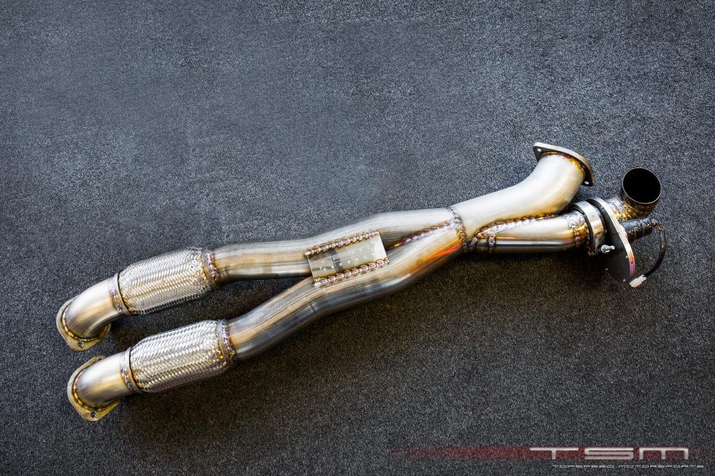

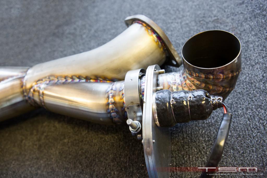

So originally the car had the standard ETS kit with three inch components and the car was making good power. 1375WHP @ 38-39PSI which at the time we were happy with. On this last round of upgrades we wanted to really max out what the 3794 turbos could do so we removed the 3" components and designed a 3.5" setup with externally dumped wastegate routing as well as a 3.5" primary to 4" Y-Pipe. Just to go the extra mile we also put a slide style 3" cutout in the rear section of the y-pipe to get rid of any of that pesky back pressure..... plus it sounds really cool when it's open
The exciting part is that with this car we were able to actually perform some somewhat back to back testing on this particular car since it was originally setup with the standard components. So as I said before we were making 1375WHP before the custom setup. After putting it back on the dyno at very similar boost levels we were well over 1450whp and were able to pull over 1500 @42ish PSI. So giving those big turbos a little more room to breath certainly resulted in a happier car overall and extracted a considerable amount more power.
