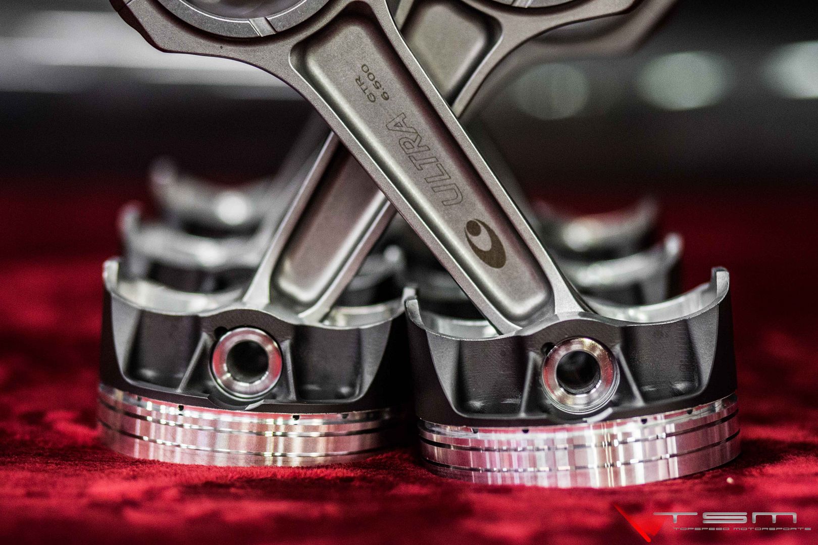

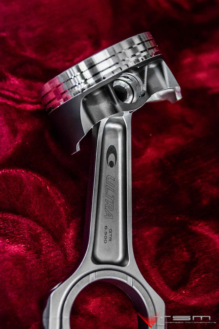

Piston Info:
* Developed & manufactured from 2618 Billet material
* Total Seal 1.2mm x 1.5mm x 3.0mm Stainless AP Ring Set
* Moly skirt coating for cold start protection
* Heavy Wall .205W H-13 wrist pins Included
* Ultra flat ring grooves for maximum ring seal
* Engineered to withstand boost levels over 40 psi

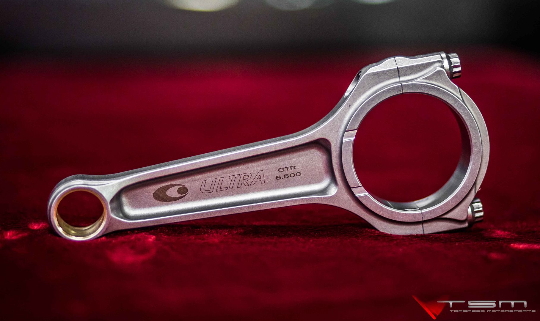

Rod Info:
Material: Timken 4330
ARP 260Ksi tensile Bolts
Weight ~710-715grams
Length : 6.500
Housing Bore: 2.323
Pin: .905
Bolt Spotface Gussets
100% Thread Engagement
Ultra connecting rods are made entirely in the U.S.A. Every Ultra connecting rod is produced from specially formulated Timken 4330V steel. This material is then precision forged in Michigan and fully machined in our Fostoria, Ohio facility. Many geometric nuances have been incorporated into the design of Ultra connecting rods. These design features enhance the Ultra against specific loads and stresses which are applied to connecting rods subjected to high load, high RPM applications. Ultra connecting rods are fastened by high alloy cap screws made specifically for severe duty service by ARP Inc. Produced with rolled threads, these unique bolts offer improved thread engagement for a smoother more consistent net clamping load. To eliminate deformation and extrusion only AMS 642 bronze alloy is used within the wrist pin housing bore.
Our rods have made numerous appearances in many famous high horsepower engines, such as The Ohio Boys LS Engines, Mark Carlyles LS Engines (making an estimated 2700+ HP), Tom Kempfs LS, and many other record holders. Ultra rods were designed for some of the most punishing applications.
