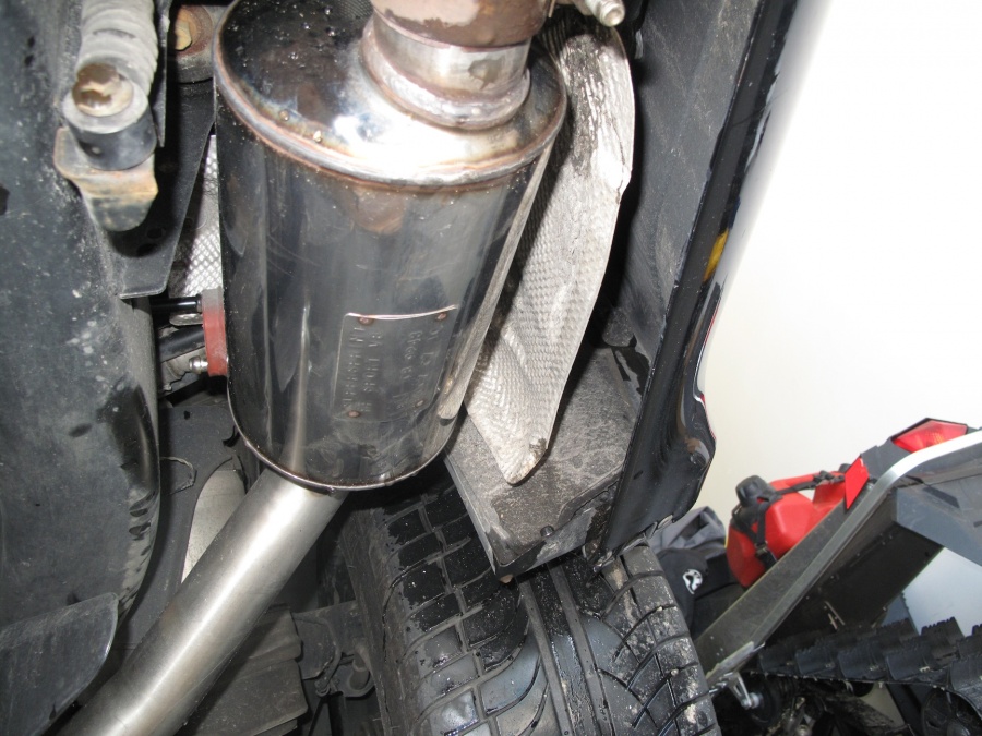

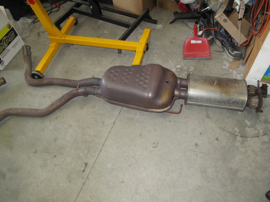

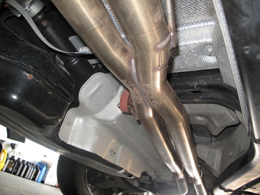

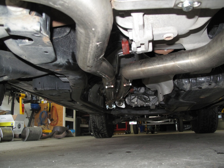

Had this exhaust for a while and was a little hesitant to install it cause some people said it's too loud. Really can't judge from a video clip. Its the Super Sprint cat back system with X pipe and mufflers. Ended up doing it right on the ground just by putting the truck to the highest setting. Wasn't that bad, just a little tight. Soooo glad I did. Ya it is louder then stock and has a bit of drone but boy does it sure sound nice when you put your foot into it. instantly noticed the power increase and better throttle response. Sure save a lot of weight as well. If your into performance I strongly recommend it.
I was gonna do the pulley Kit a while ago but really don't like how it works. The stock pulley, which is steel, has to be pulled off with a special puller. The new pulley is aluminum and has to be heated then slid in the charger shaft. Would be a lot nicer if it was a bolted on with the charger shaft splined. Guess Land Rover knows that people love to play with pulley's so made it as difficult as possible. Heard of a few cases where it has actually came off. I personally like parts that are easy to re & re in case of a warranty situation.

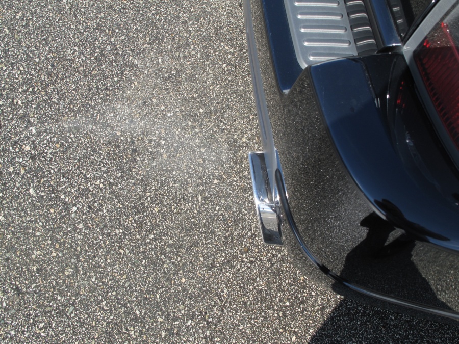

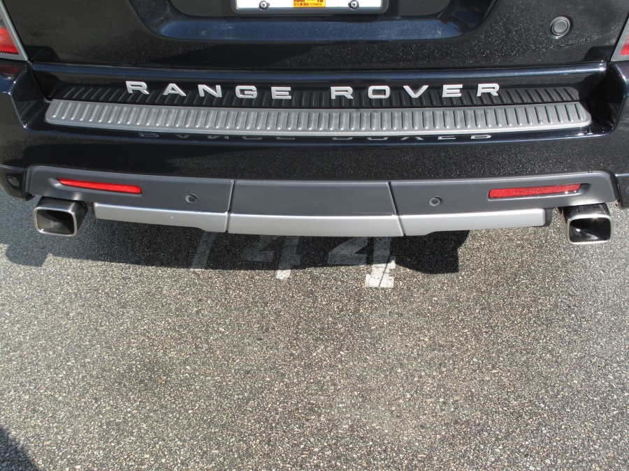

Anyhow check out some pics of the exhaust. My truck is autobiography so I used the stock tips. Stuck them out just a bit more then before. Looked a little too flush.

1 More pic.

I like how the tips stick out a little more, good choice.
