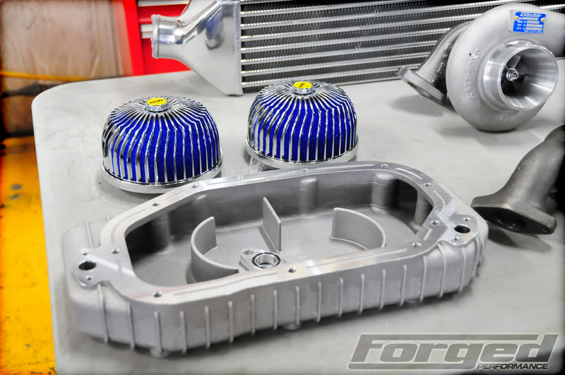

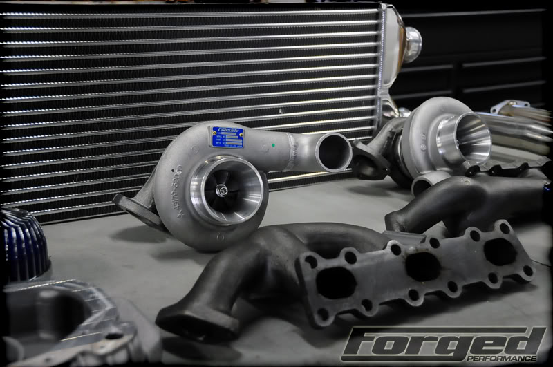

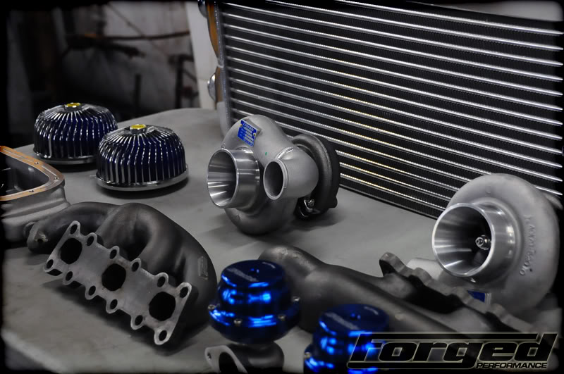

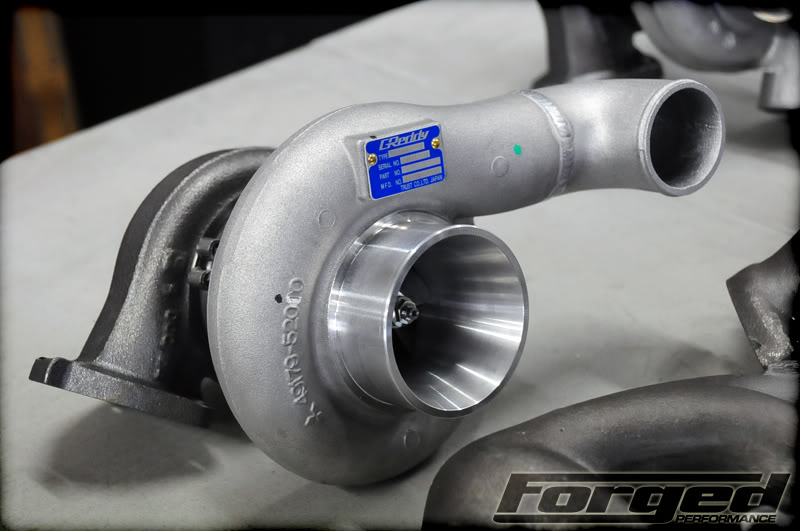

Hello everyone!
Just wanted to share a recent project we just completed. For this project we decided to adapt a Greddy TT Kit from the 370z and install it on a G37 Coupe. Many of our customers have long wanted another TT kit option for the G37 and with Greddy's support we determined what changes would need to be made to the 370Z kit in order to adapt it to the G37 Coupe. Turns out that almost no adaptation was required aside from relocation of a few items due to the automatic transmission coolant lines. We also had to fabricate a bracket for the adaptive cruise control distance sensor. It's amazing how well the kit fit when it's not even technically designed for the G37 Coupe. The kit shipped the day we ordered it was well packaged, and was missing zero parts. The kit does not require any special driveline spacers or aftermarket steering couplers, making installation a breeze. We managed to achieve 440whp on our dyno dynamics at a very conservative wastegate pressure of 6psi. The big 20G turbos can produce 700whp+, but still spool very quickly and are happy at wastegate pressure. As always, I calibrated the factory ECU with UpRev's Pro Tuner software. This particular vehicle is an 08 G37 5AT with about 40,000 miles on the odometer. The owner lives in Texas and drives the car every day, so reliability and OEM look feel are extremely important.
Seriously this is one of the best looking cars that's come out of our shop. It's a perfect combination of power and class. I didn't want to see it go, but alas, the client flew in from Texas and proceeded to drive it straight home 12hrs without missing a beat. Next upgrade is a Big Brake Kit!
Simple, reliable, clean, and undetectable from inside the cabin.
Performance Upgrades:
- Greddy 20G Twin Turbo Kit (Nissan 370z)
- Greddy BOV Set
- Greddy Ti-C Exhaust (G35)
- DeatschWerks 600cc injectors 350Z/370Z/G35
- Walbro Fuel Pump 255lph
- Transgo Valve Body Upgrade Kit
- Uprev Ecuflash Tuned by Sharif at Forged Performance
We documented this project with pictures, and video. Please enjoy them!

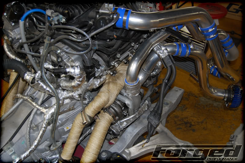

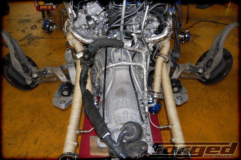

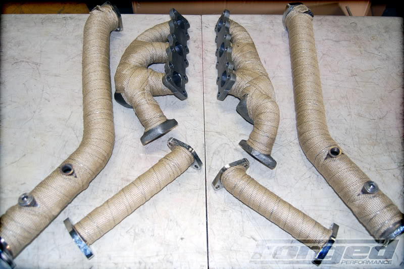

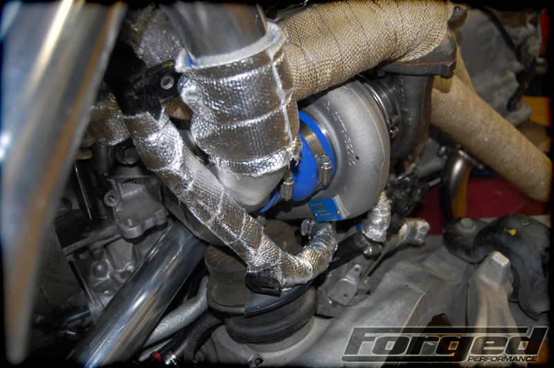

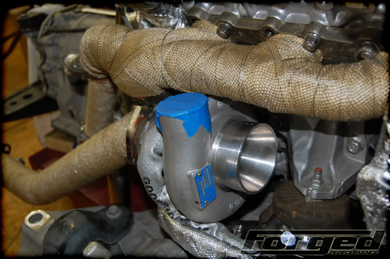

Heat wrapping all exhaust components.
Thermosleeving lines and Heatshielding critical engine components

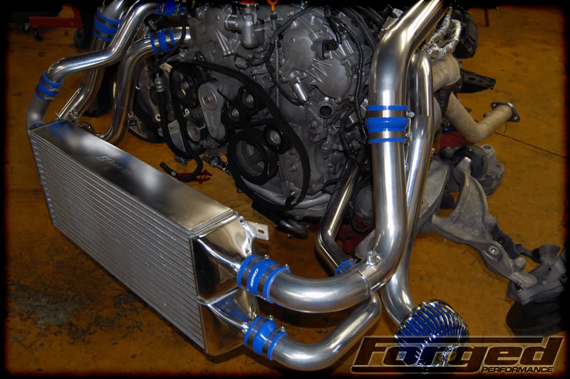

Greddy Twin Turbo Kit installed on motor

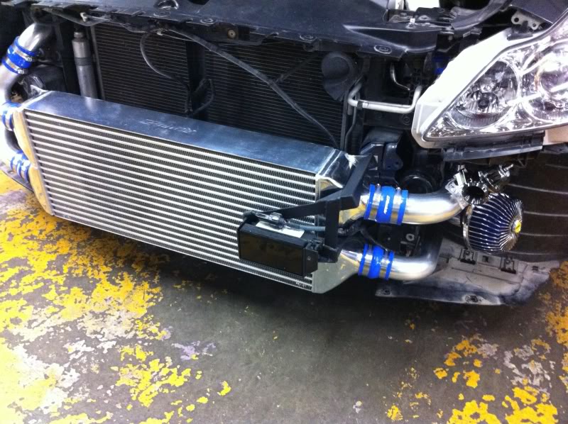

Fabricated Active Cruise control module to fit the bumper.

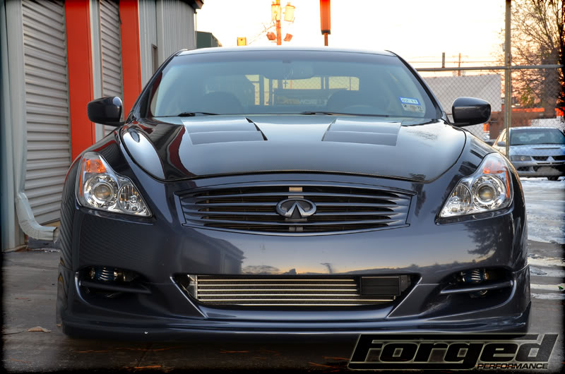

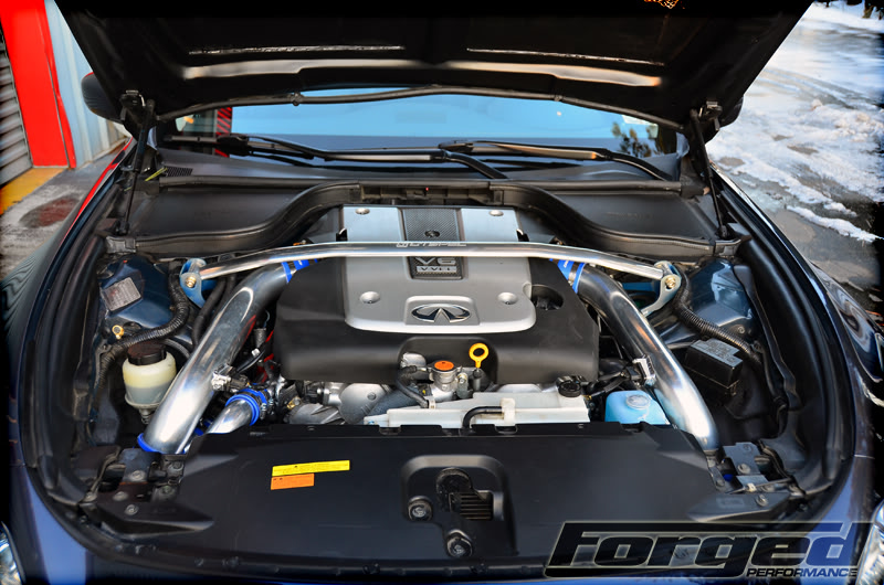

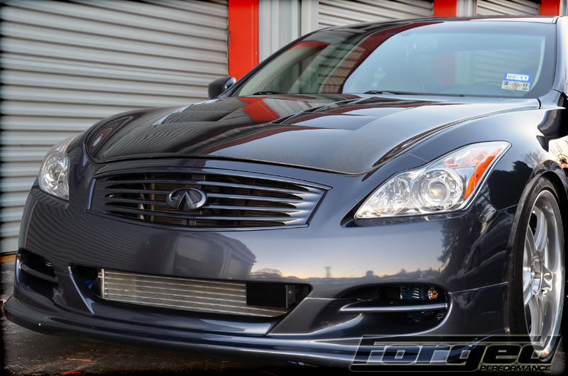

Finished Product:

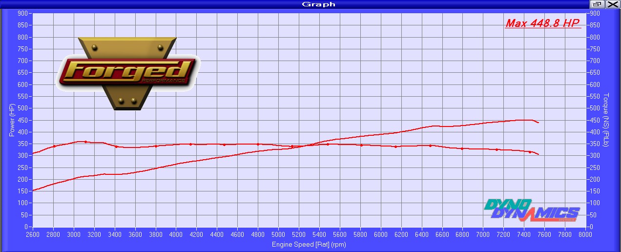

Updated with Dyno Chart on opening page as well:
