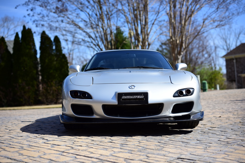

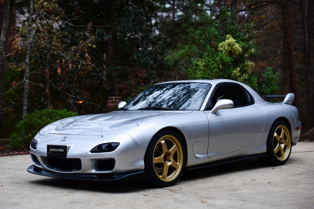

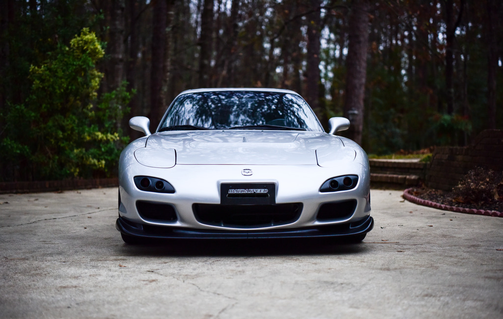

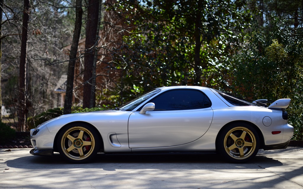

I had a chance to work on my 1994 SSM FD RX-7. It had a small coolant leak somewhere so replaced and tighten some hoses to the turbos and such.
And decided to put on my Mazdaspeed MS01-Mag wheels on.
Here are couple of pics of the car.

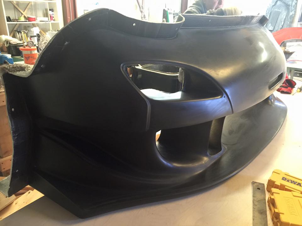

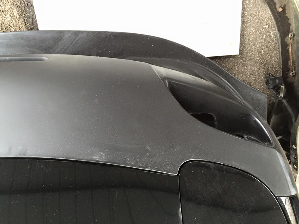

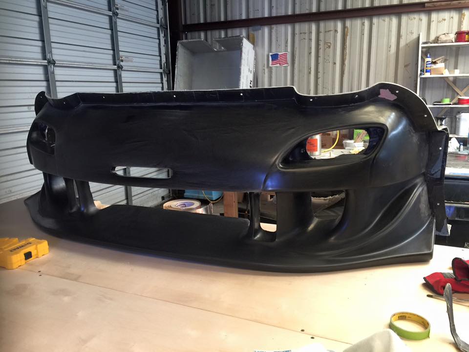

Back in 2015, I decided that it was time to fulfill my goal of making a bumper that meets my vision. Instead of using RE-A N1-02, I decided to used the N1-05 which has the molded in undertray/diffuser. We cut the both bumpers and started to put them together. (Oh, I should most definitely give credit to my engine builder and long time friend Luis Canizales and his son Luke Canizales for their help putting the bumper together and helping me make the initial mold).
I did not like the 90's 'hump' on the front bumper so we made it to sit flat.
Here is an initial shaping of the bumper.. It weighs 40-50lbs
We made a mold and pulled one bumper off. When running the bumper on the, it didn't quite fit correctly. It sat quite low and required some hand on modification. Again thanks to Luis and his friend, we were able to have it on and made it to an event very next day (low as in I couldn't make it out of my driveway).
I was able to have it on the car and get it featured in SpeedHunters.
http://www.speedhunters.com/2015/07/...rotary-maniac/
But I wanted to make the bumper correctly and more of it.

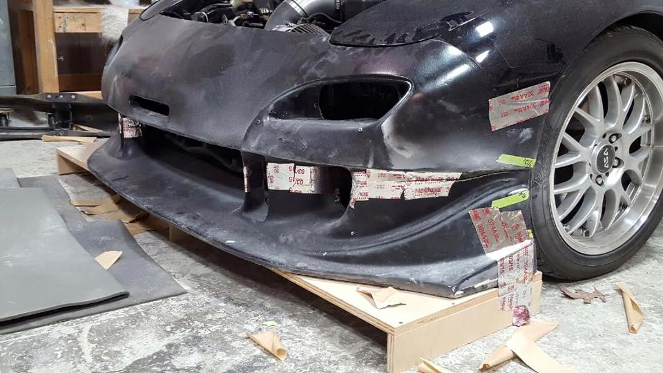

Following year, I was conversing with my friend Michael about the project. He said he knew someone who might help me regarding making a new updated bumper.
So, I took my initial bumper and started to correct some of the issues. Being extremely low was an issue, so first bumper was cut, fix the height issue, and corrected the flat part of the bumper.
First bumper pulled from the second mold.
Im running out of time so I will update next week regarding the fitment and the results.

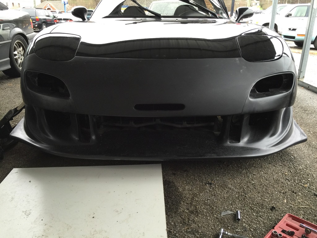

Continuation of the bumper making..
Here are the detail pics of the bumper.
Test fitments:
Overall, I was very happy with the results. Fitment was satisfactory for being what it was. Height of the bumper was similar to the stock 93 bumper with 99 front lip. Compare to the first version, its night and day difference in fitment and quality.
Test fitments:

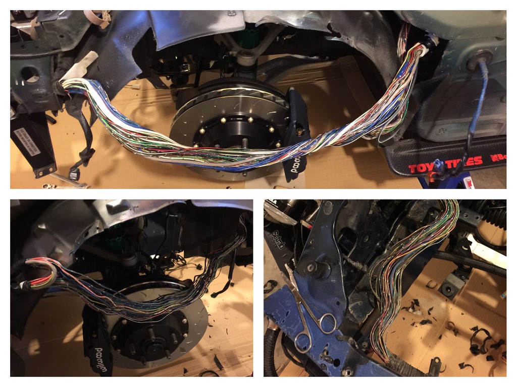

I've decided to clean up some wiring to get ready to put a new set up in the car.
To do it right, I also needed to pull the dash and clean up the hacked up 20 year old interior harnesses.
More to come next week..

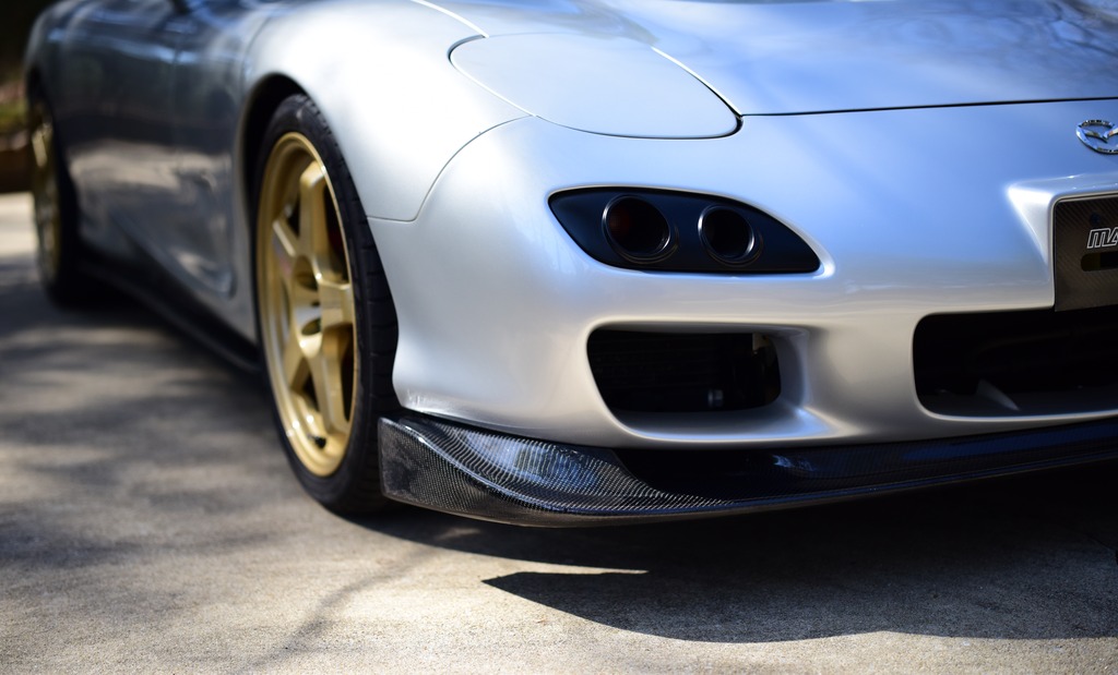

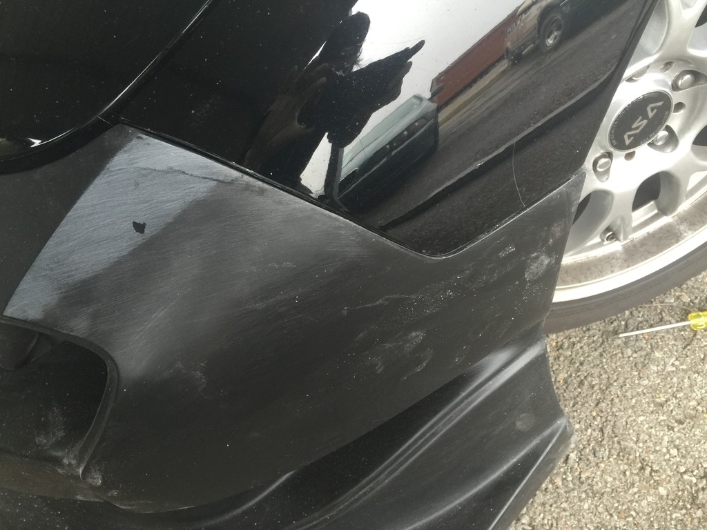

But I was able to sand down my Mazdaspeed Carbon Fiber front bumper lip and clear it to bring the shine back. Than replaced my 99 lip from my SSM FD.

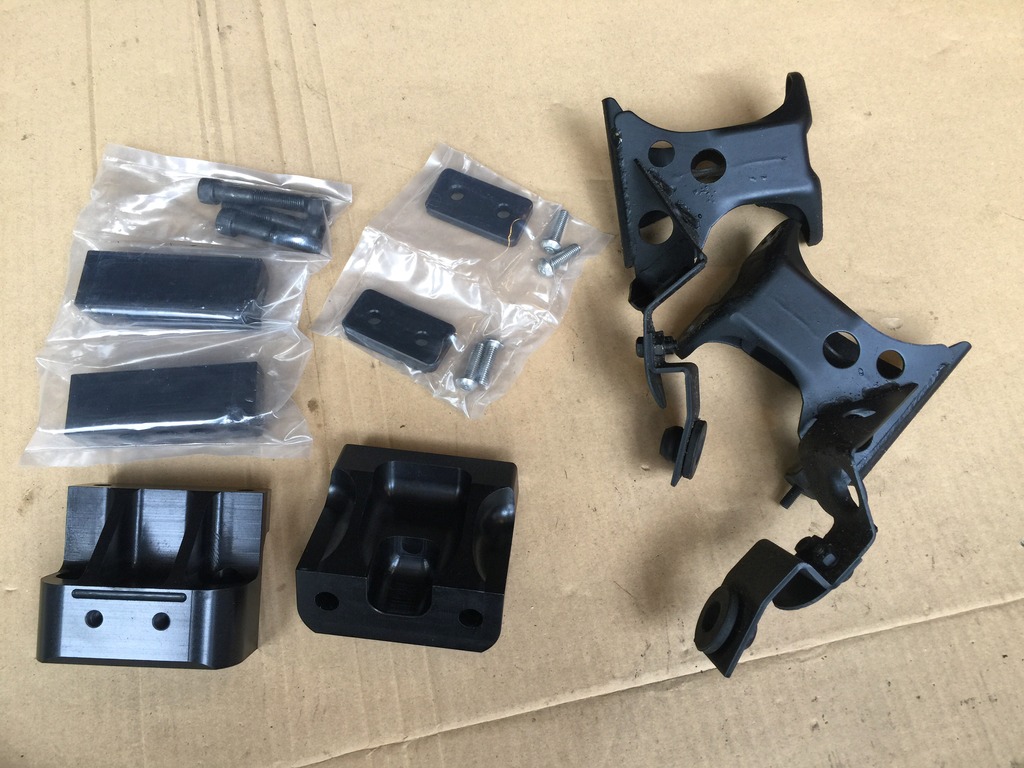

First installation of Sakebomb garage upgraded swaybar mounts. These things are beefy and well made. I'll be using a new Tripoint swaybar with these.

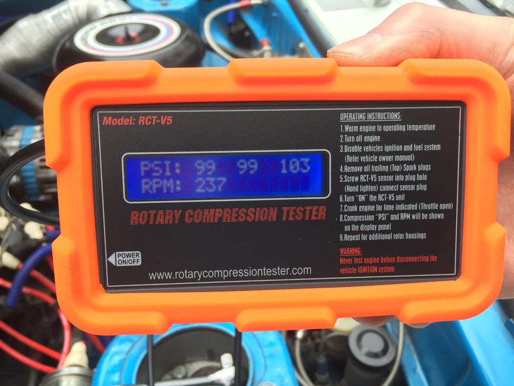

Another thing I was able to do was check the compression on my 1973 RX-3. I recently got the www.RotaryCompressionTester.com (RCT)'s battery operated compression tester and wanted to compare to my Mazda Specialty tool compression testers (old thermal and digital).
After warming up the car, I've tested just the OE digital and RCT testers. RCT unit uses 9V battery and it has automatic altitude calculation. Its super well made and easy to use. All you have to do is warm up, kill the ignition and fuel pump, install the sensor in the trailing plug hole and crank the motor. I did a facebook live video (https://www.facebook.com/Herblenny/videos/10154392837808927/) hope some of you can view it.
Anyhow, here are the results from the RCT:
Front
[/URL]
Rear
Not bad for 20+ year old engine
Front
Rear

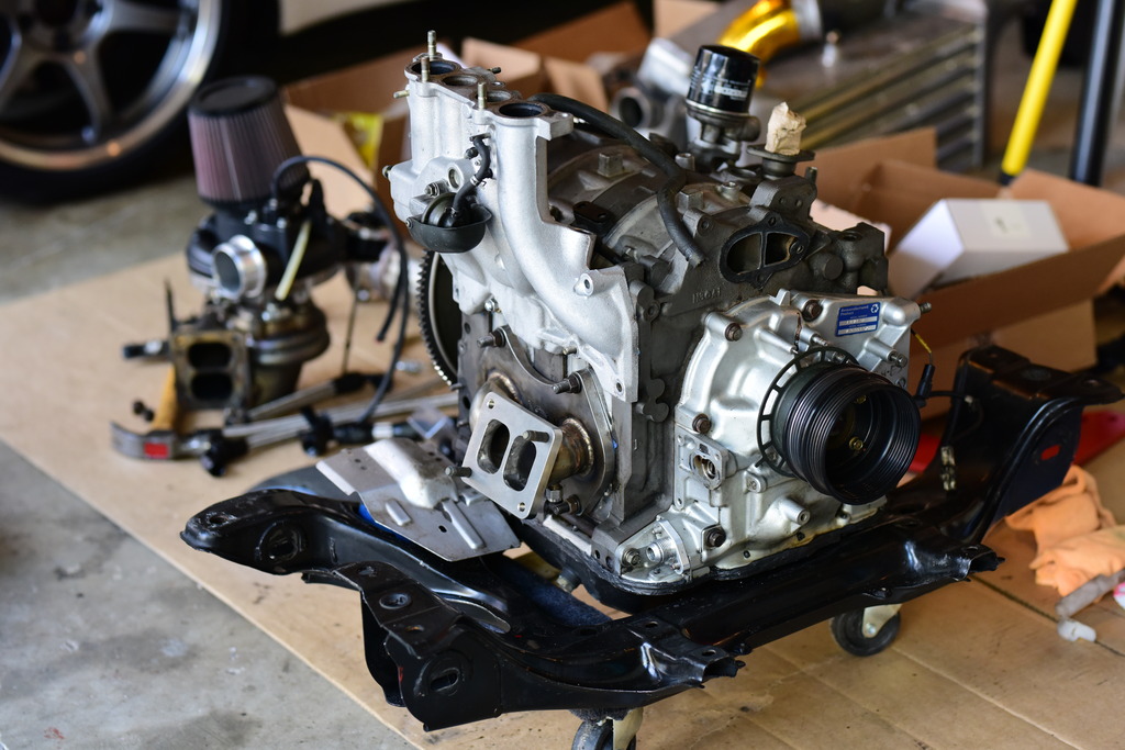

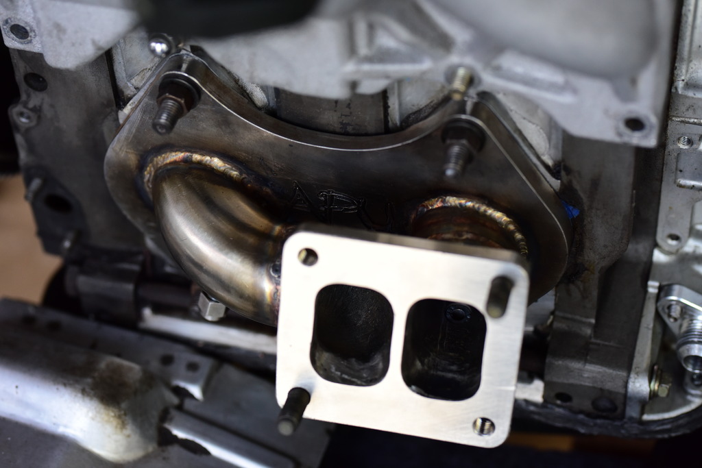

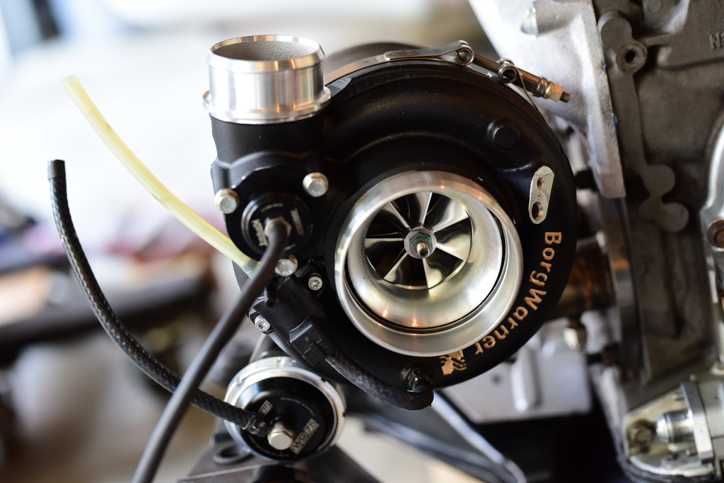

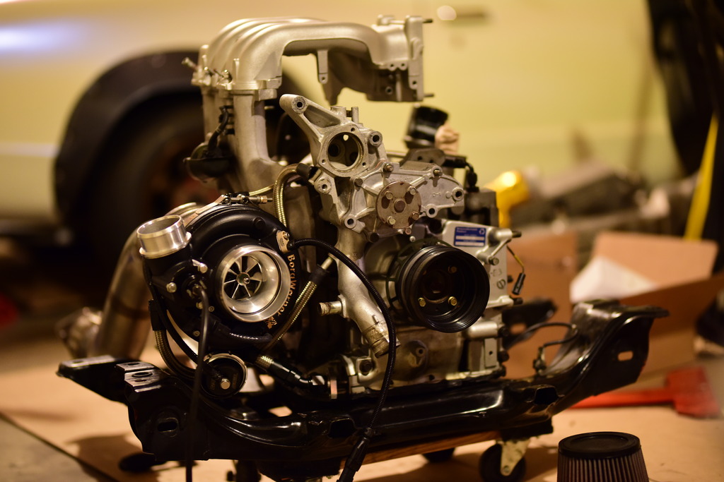

I'm re-doing my RX-7 for a guaranteed feature with SuperStreet Magazine. So, I've decided to re do my turbo set up and support my friend Zach, Addicted Performance. He also supports my event, 'Deals Gap Rotary Rally' (DGRR) and helped me by answering many of my questions regarding turbos and tuning.
I've decided to go with his Borg Warner EFR kit. Craftsmanship on the kit is top notch!! Also, Zach is a great tuner and will be taking my car to his shop when its done for a tune. Hopefully during DGRR and unveil the car there.
Turbo is Borg Warner EFR 8374 IWG with Turbosmart upgraded Bypass valve and IWG actuator.
I've mocked it up on my spare 13B-REW motor, and this is using REW intake manifold. I'll be also mocking it up with Cosmo 13B-RE manifold later on.
