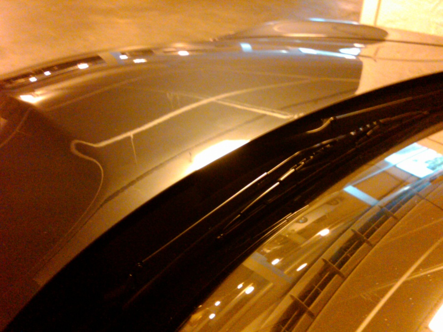

Can you post a picture Rich? It may be moisture under the clear or it could be factory blemish...the latter is highly unlikely as Porsche has one of the best final inspections and quality control of any manufacturer in the world.
Also, if a reputable shop is painting it, dealer recommendation doesn't always mean they're the best, you should be fine. Get an estimate and find the scope of work they're doing. A repaint may be your best option though. But try and post a picture and maybe I can steer you in the right direction.

RichS2010's Avatar
Joined: Oct 2010
Posts: 133
RichS2010 is a jewel in the roughRichS2010 is a jewel in the roughRichS2010 is a jewel in the roughRichS2010 is a jewel in the rough
Old Oct 19, 2010 | 07:07 AM
RichS2010's Avatar
Joined: Oct 2010
Posts: 133
Hi Moe, A picture is up. The 3" blemish is difficult to capture on my cell camera. It is just visible in the corner between the white center line and above and slightly below the darker line running along the hood near the wipers; in the 2 o'clock position above the light reflecting in the hood. Hope this helps. Thanks.

Old Oct 19, 2010 | 08:44 AM
MoeMistry's Avatar
Premium Sponsor
Joined: Jul 2005
Posts: 5,112
From: Costa Mesa, CA
Rep Power: 263
MoeMistry has a reputation beyond reputeMoeMistry has a reputation beyond reputeMoeMistry has a reputation beyond reputeMoeMistry has a reputation beyond reputeMoeMistry has a reputation beyond reputeMoeMistry has a reputation beyond reputeMoeMistry has a reputation beyond reputeMoeMistry has a reputation beyond reputeMoeMistry has a reputation beyond reputeMoeMistry has a reputation beyond reputeMoeMistry has a reputation beyond repute
Sorry Rich...it's very hard to see. Was the picture taken with a camera phone or camera? You can also email me the picture.

I think that with the heat of the engine and the Dallas summer (105° days), my hood has gotten as hot as a hair dryer would get it. And the moisture, if it is moisture, would not just disappear, but would vaporize and move under the clear coat, possibly causing a de-lamination since it couldn't get out (or else it already would have).
I think this might be one of those times when the fix IS worse than the problem. You said in your first post:
We can NOT see it in direct sunlight or even shade. We can only see it under the amber lights in our garage.
I know you're unhappy about the problem and the way Porsche has handled your issue; I would be too but, I'm not sure painting the entire hood for a 3" blemish that you can only see in certain light is worth the deminished value of having a Panamera with a repainted hood. When it comes time to sell, I'd rather explain the blemish then why the hood was repainted. My advice would be to take some time to really think about your options. Don't be in a hurry to try and fix it... Best of luck and please keep us posted.

Hopefully, some good news. Took the car to a highly recommended Body Shop to have them take a look at the blemish. After putting the hood under a bank of overhead lights here's what they discovered. At the outer edge of the blemish you can see the remnants/edge of a "Fish Eye" in the clear coat which the Factory sanded off and buffed. However, the Factory did not fully buff out all of the fine scratch marks from the sanding process. When the Dealer applied it's protective sealer, in preparation for delivery, it highlighted the fine scratch marks left by the Factory - My Blemish. The proposed solution - chemically remove the protective sealer, buff out the fine scratches/blemish and reapply the protective sealer. Appointment being set-up for next week. I'll let you know what happens.
