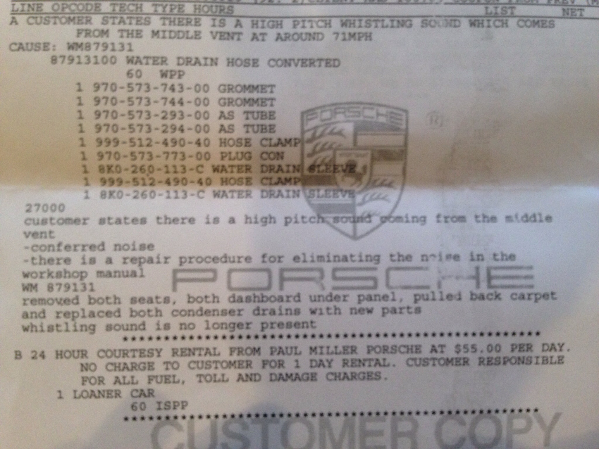

Here is a picture of my service order with the high speed whistle repair described. There is a workshop manual code which could be used to identify the exact fix to your service advisor. I don't see anything there about a front plate added to further reduce the noise, I am going to call and ask about that. Hope this helps!
I guess I won't be doing this fix anytime soon since I don't want to have half of the interior dismantled and the noise is not present for the past few months. No idea why.

Well I got the service done. I showed them the thread and told them about porsches fix and they said porsche doesn't have an official fix, because it doesn't completely fix it. They said they have been rerouting the drain tube (which is what the supposed fix is anyways). So they did that. It definitely took the noise away at lower speed and now the noise is ALMOST gone. With everything off, I can still pick up on and hear the noise on the freeway, but its tolerable.
I told them about the 'front plate fix' that was mentioned on here but they didn't know anything about it and there wasn't enough information on here for me to tell them what it is.

My car is still at the shop, so dont know what they are exactly doing, but I think the front plate + wheel arches they spoke about has something to do with the wind noise, as I dont have the awd noise from front vents as you have.

OK, so I have a newer update now. After the last fix, as I mentioned the noise got better. However, if I was travelling over 65 mph it was still really bad. Turns out that according to them, last week Porsche put out an ACTUAL fix for it with Porsche certified parts. It still rerouted the drain pipes, but with prefitted parts and to an optimized location I guess. They just did it for me this week and it worked like a charm. Now the humming is only noticeable when your REALLY paying attention for it or otherwise just under light acceleration. During normal driving, even with the music off, it is not noticeable anymore. Great success! The code for the fix is WM879131.
Or atleast ALMOST great success. Now I have a new problem. They have to take off the entire dash and trim to complete this job. Well they put it all back and now there is some serious creaking from all the trim under normal driving conditions. UGH. I wrote my service advisor and hopefully they can work this out. Its not just normal expected creaking that you would get on bad roads. Its some serious creaking under normal driving conditions. I gave it a couple days to see if it would settle in and it has not.
I feel like I'm a crazy person when I talk to my service advisers, nit picking so much, but I really don't feel like I'm nit picking. If my $30k lexus interior doesn't creak, rattle or hum, I don't expect my $200k sedan to either.
Anyone else have similar issues after a fix like this?
EDIT: HA, I just looked at the previous posters picture and it looks like its the same fix he told us about. I showed that exact picture to the service adviser and he said there is no official fix... I told him theres a WM number to it and showed him the picture I printed, but he just stuck to what he was saying. I didn't argue. One week later there is a magical official fix.
