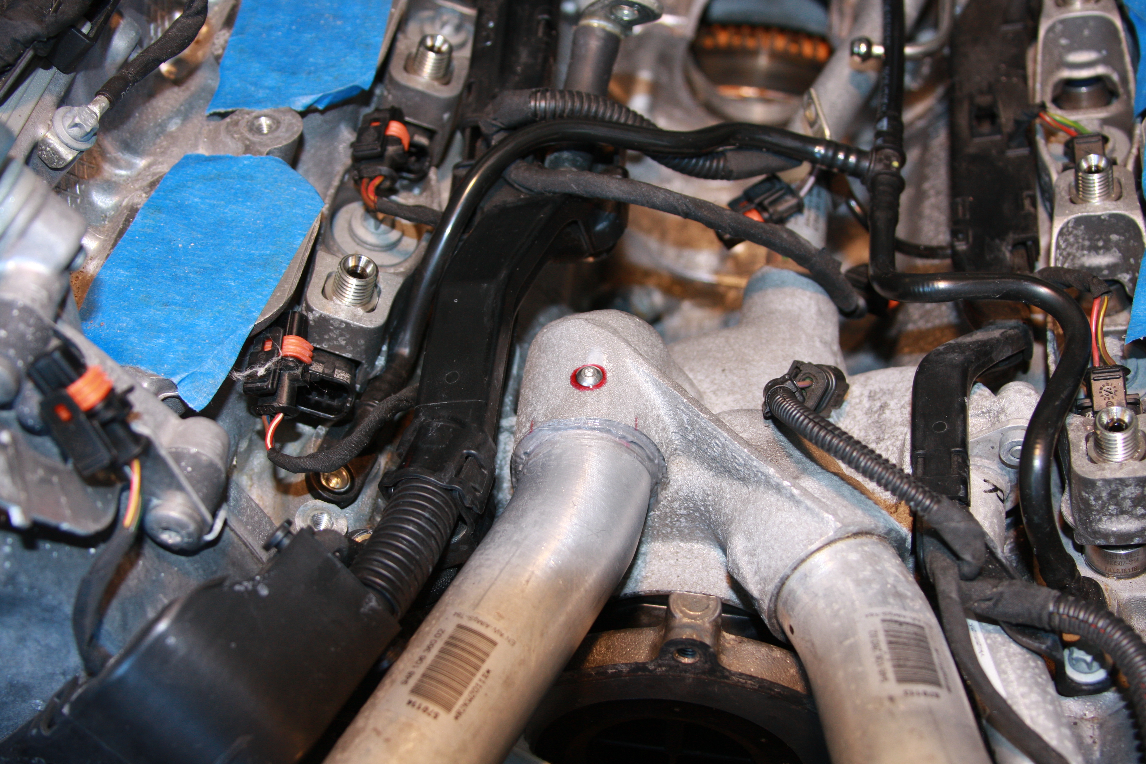

It looks like it is a wide spread issue with Panameras as some here have reported sudden coolant dump. The culprit is/are these two pipes coming out of the coolant pump. They are epoxied. Even though the tech misdiagnosed, he unknowingly pointed me to a potential disaster waiting to happen. In my car (P4) the right pipe (right is always the pass side!) was shaking a bit when moved by hand. The left is solid. So I decided to do what the dealer had recommended to be replaced:
1. thermostat housing (holds the thermostat and the two coolant pipes
2. coolant pump
3. thermostat
4. starter (yes, starter too since he diagnosed it to be coolant leak)
5. other temp sensors while you were there
Once i removed the parts in the way I realized it wasn't leaking and didn't need all these replacements.

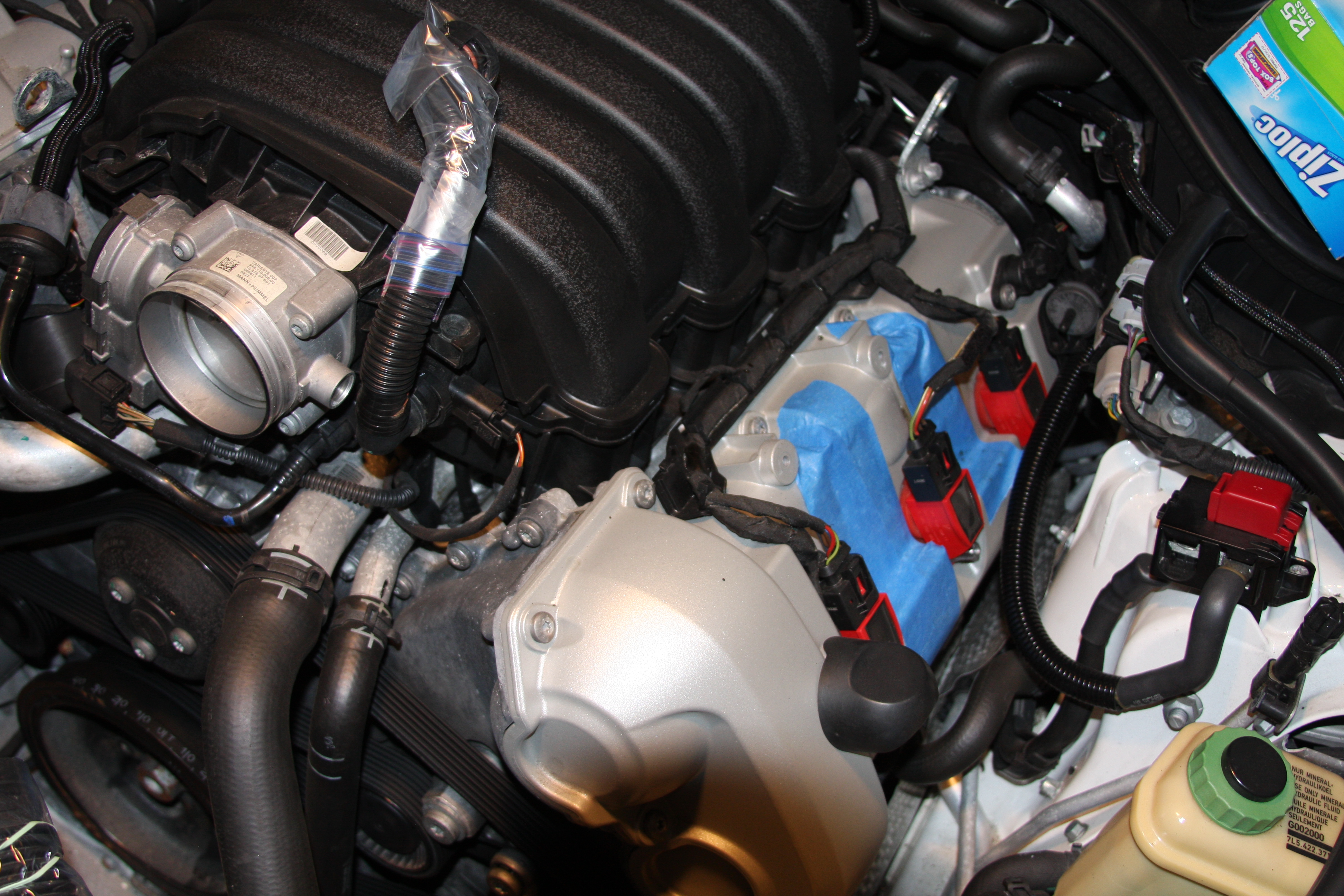

This is how I went about it. It is very simplified thought it is not difficult to do. You should surely use the Workshop manual for each of these steps. There are other preliminary work that need to be done before you perform some of these.If you are going to do this then PM me and I shall give you more details.
Drain coolant from radiator
Remove air box connection to throttle body.
Remove cover for ignition coils
Remove oil mist separator
Remove throttle body
Remove air intake distributor
Remove high pressure fuel line distributor (only if addressing the starter part)
If you are addressing only the coolant pipe then no need to remove the thermostat housing. Just make sure you have covered all of the openings including the ones for the intake and oil separators. I'd use cloth as paper towel sometimes leaves bits and pieces inside.
As you can see in the picture the epoxy on the right pipe was done. I used the Permatex epoxy that withstands up to 350F. I drilled a 1/8 hole thru the housing and the pipe, Used a 8/32 threader to thread it and then used stainless steel 3/8 bolt with Loctite red to secure. Go slow and carefully on this. There are DIY instruction on this in the Cayenne forum. Keep the vacuum running to capture any metal shavings etc. Let it cure overnight and put em all back together. Replace all rubber seals. All of them.
For the coolant refill, the WM asks you to follow the pressurizing process. Not necessary IMO. I kept the purge valve open and filled it. Started the car and let it warm up. After the bubble settled, I closed it and went for a short drive. The temp will hit 150 ish and you will see the alert on the console but within a mile it should settle back to 200/201.

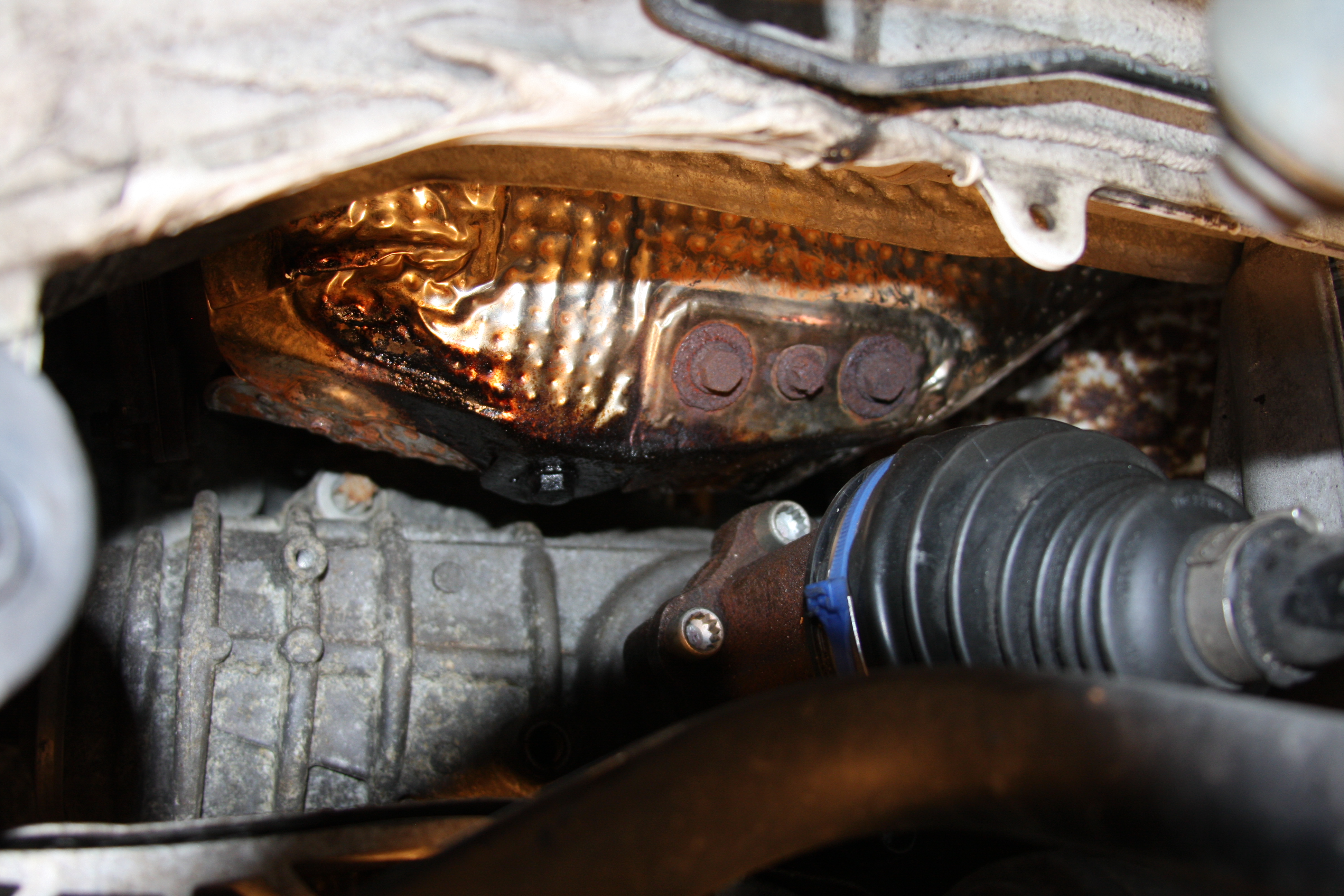

So, the burnt oil smell still exists and I was able to find the source. Front final drive seal. You can see the arc like oil spray on the bottom of the exhaust manifold heat shield. Ignore the zip tie. It is just an added measure for peace of mind. Don't trust putting only the Porsche axle boot clamp.
There is a heat shield that should cover the place where the axle meets the final drive. The P4 don't have it. I guess they thought the non-Turbos don't put out that much heat. I think it probably was the reason. If you look at how the 2 part exhaust manifold heat shield is installed, the outer part will flow the hot air coming from top, heating up while passing over the manifold, escaping thru the bottom and hitting right on the final drive joint with the axle. Kind of like a super hot hair drier focused on that part. Have to figure this one out. Oil level seems fine so it is a minor leak. Drive might need replacement if I cant find the seal separately. Porsche don't sels parts no more. They only sell full units. Bas*****!

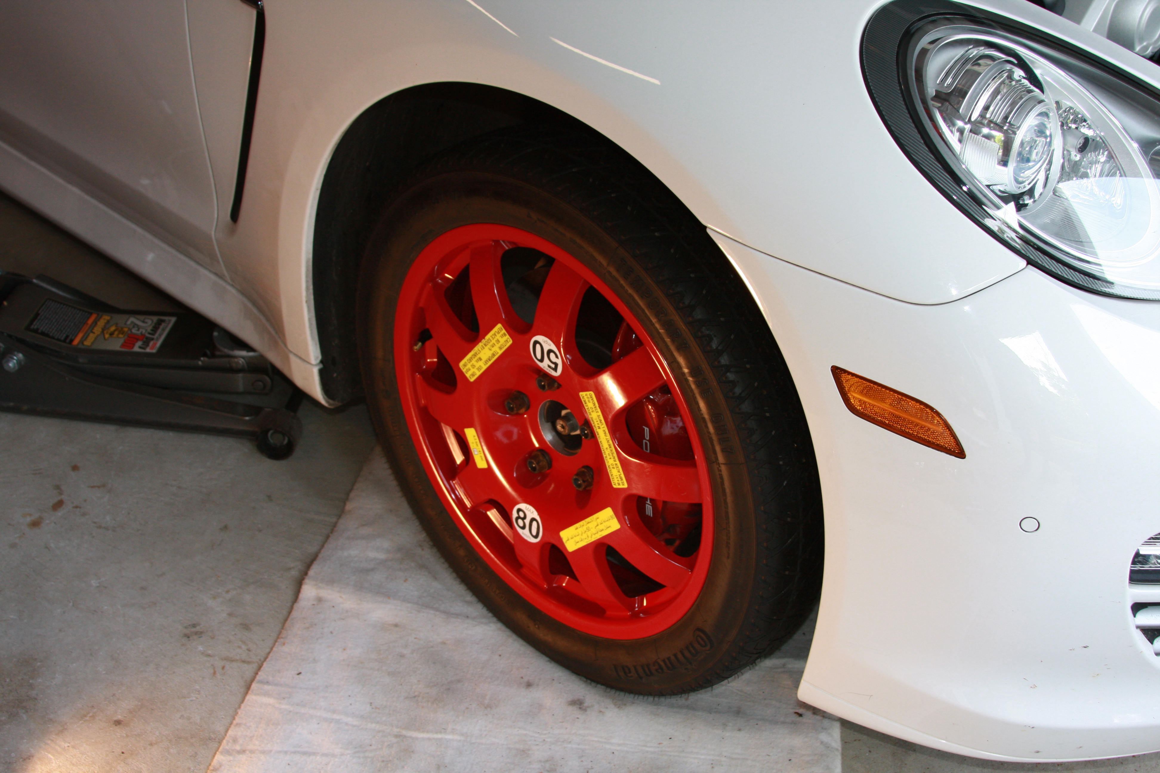

I did treat myself to one more peace of mind: Rather this on long trips than a tow and a tire replacement.
